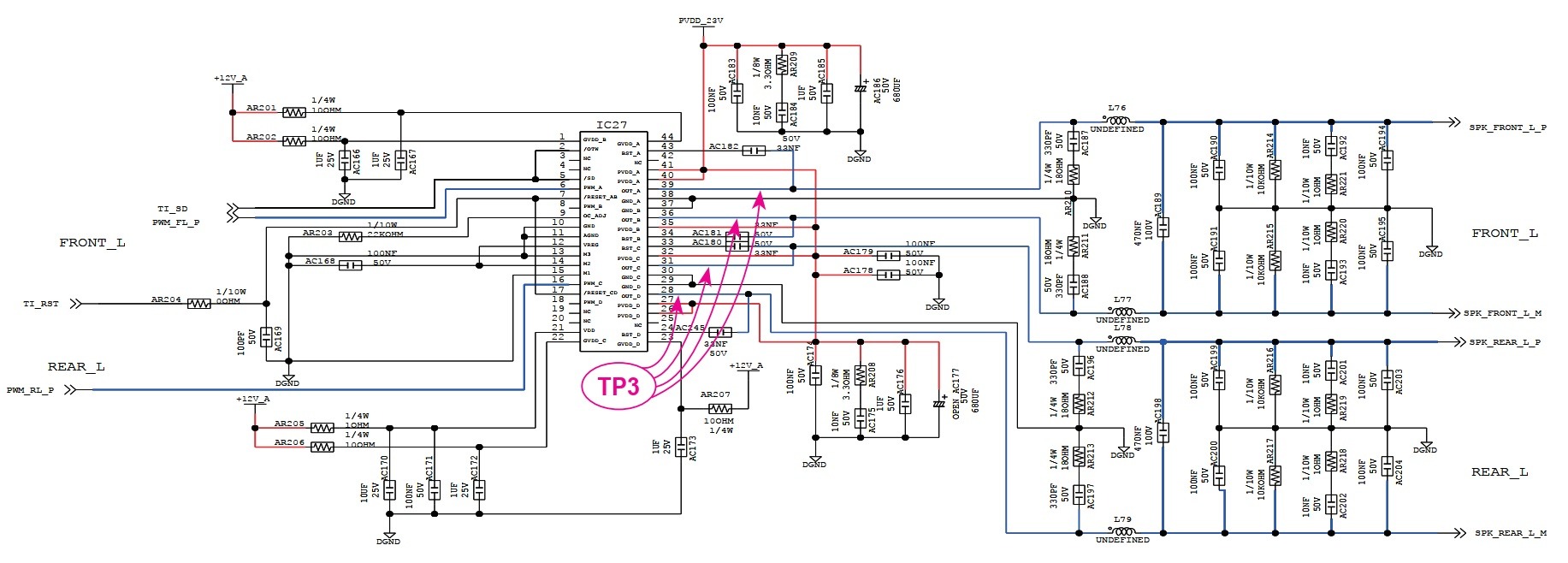

Yeah, I realised they were choke coils after I posted. If they are involved in filtering it raises a question mark though doesn't it? Otherwise that leaves me with the surface mounted stuff after them to check.

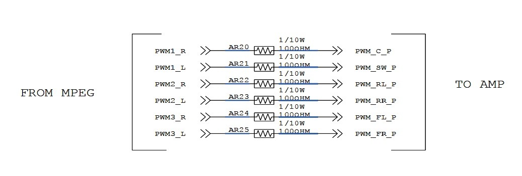

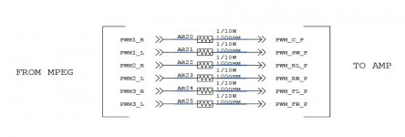

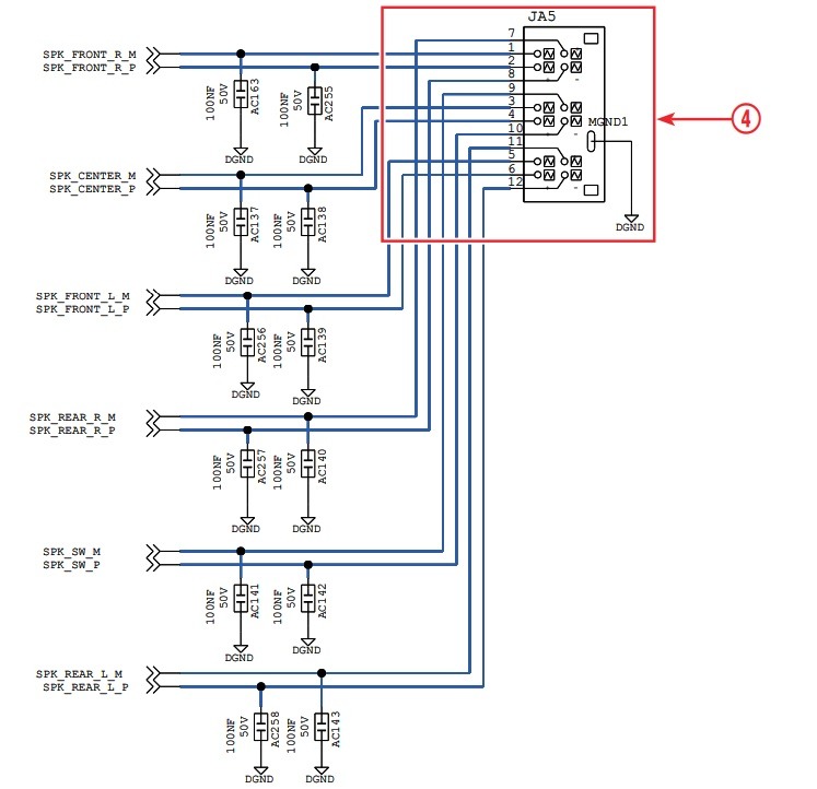

Right, after more testing I have narrowed it down to the individual channels - both rear satellite channels have a ~10dB higher noise floor once it detects a signal and the amp kicks in. Voltages are the same as the others, as are the channel layouts, so assume it is either the surface-mounted components not filtering or earthing properly but I have no idea what they are all for to try and pinpoint it. I am hoping that someone here that can understand audio schematics can point me in the right direction. I don't really want to have to replace everything 😂
