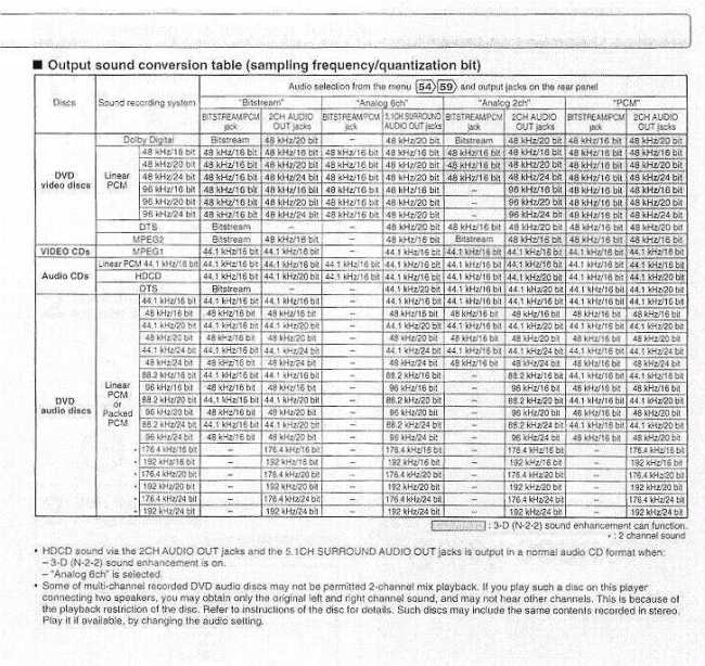

This is a scan (sorry for the quality) from the Toshiba SD900 manual and it shows that the highest bitrate and sampling freq on its digital output are 16/48.
So yes, technically many support more but it has often been limited per design.
