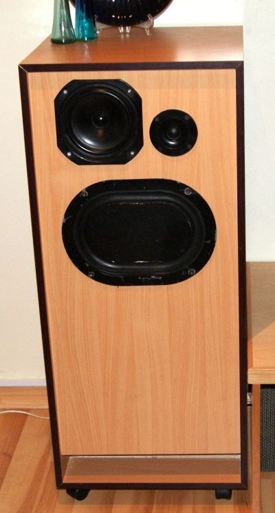

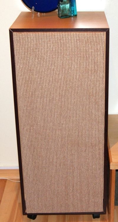

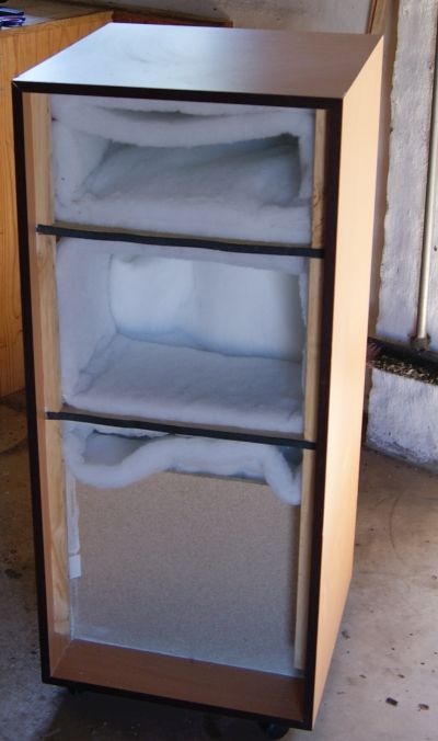

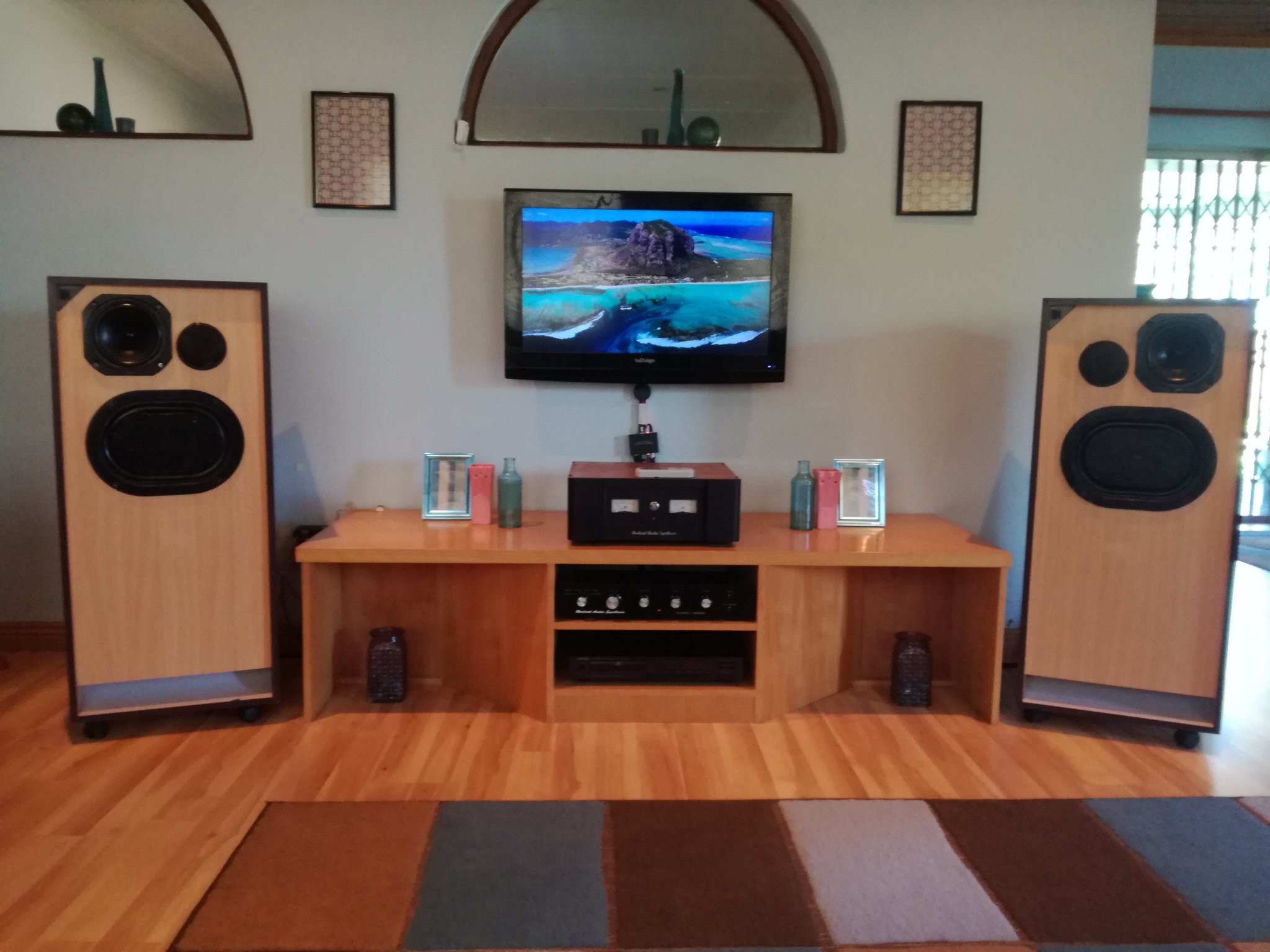

The woofers are isobaric and totally isolated from mid, which are in its own transmission line enclosure. Makes for a very large speaker but sounds fantastic. Bigger is always better. These are all KEF drivers. No measurements, but then I listen to it not look at a piece of paper, which to me is irrelevant.
- same sealed box for midrange and woofer?
