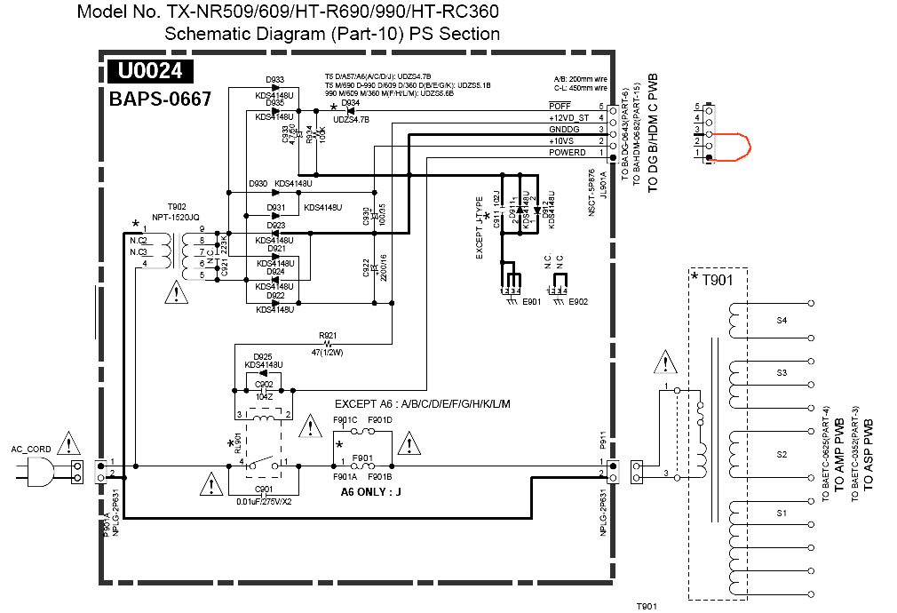

Jumper POWERD to GNDDG. Does relay RL901 clack and power come up?
> connection to power up just the amp itself.
I don't see much problem powering up "everything", even the junk HDMI board.
When I jump POWERD to GNDDG only the relay on the power board clicks, nothing else seems to come on. The other relays remain silent.
That relay comes on and stays on normally even with the bad HDMI board, but the two relays closest to the speaker outputs click back off after a few seconds.
With the HDMI board connected, the unit won't stay powered up, it comes on for a few minutes then clicks back off again randomly.

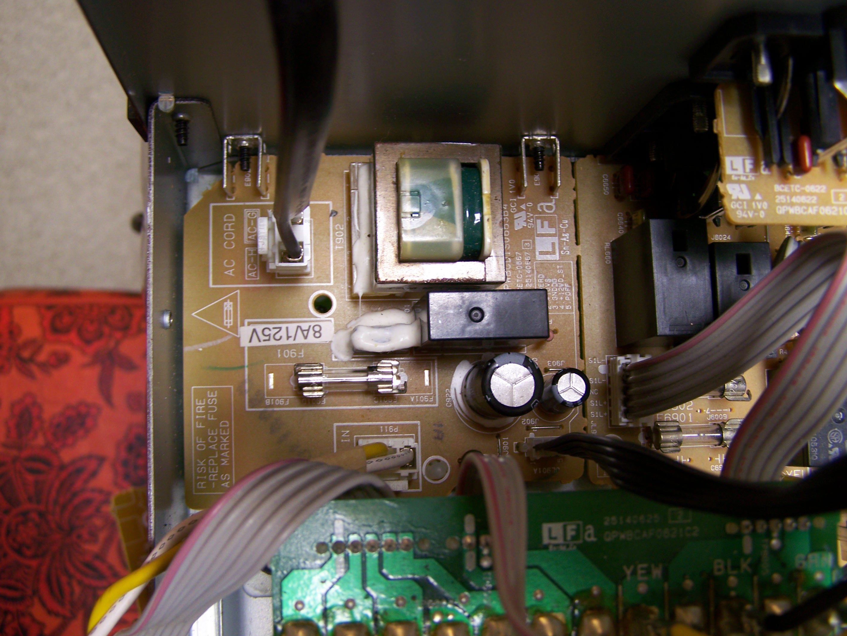

The 5 wire black ribbon to the power board is an output of the HDMI board, what do the other boards do? The gray ribbon cables are speaker outputs to the terminals. Without the HDMI board, there's no power connection to the main amp.

Right now, there's no power to the main amp board, the power supply board transmitted its power through the HDMI board which is dead. With the HDMI board in place, only the right channel stayed powered up, it would power up the amp, then shut it right back down again in a few seconds, then if left on, the display would flash a few times and the whole thing would go down. One of the chips on the HDMI board, the larger one, would get super hot really fast, the EDS chip didn't even get warm. That board is bad, and leaving it in place would draw excess current for no reason, if not damaged the power supply.
I can turn on the power supply but I need to figure out how to power the amp board up, its likely going to be through one of the two black cables that remain, either the 7 wire or the 5 wire flat cable. I'm guessing its going to be a matter of connecting pins 2, 3, and 4 to the right leads on one of the black cables on the amp board to power it up.
The amp board has two STK chips, the larger one is for the main two channels, the other looks to power up the rear and center speakers. I don't care about those, but I'm not sure I can power up just the one chip.
I need to know which of the flat black cables is going to be the one to power up the amp itself.
It won't have a volume control, that'll be up to which ever pre-amp I connect to this.

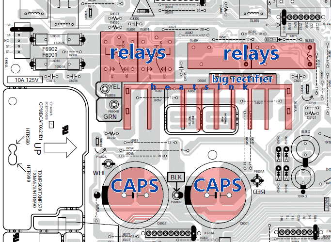

Something I'm not seeing is a rectifier in the power supply, the only rectifier I see is on the middle board, or the board that contains the video in/out jacks. (U0021 on the diagram).
What I'm basically trying to figure out is if the main amp board can be powered up by itself, sans all the other crap.
It appears that the power supply isn't capable of supplying the correct or enough power for the amp board if the rectifier is mid circuit on the video board and not on the power supply. The transformer supplies at least 5 AC voltages.
What I find odd is that the power supply board stands alone, then the rectifier is on one board, and the filter caps are on the main amp board rather than with the power supply. It looks to me like all the amp circuit is on the main amp board but there's no single source for power distribution.
Maybe the right answer is to reconfigure the power supply to just power the main amp board and toss everything else. That would mean taking the rectifier and 10k cap from the U0021 and moving it to the power supply to make a feed to power up the main amp section.

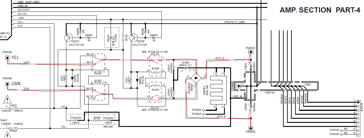

The speaker 'relays' are the protection relays, they generally turn off the speakers if DC volts are detected at the outputs.

It's there in the service notes. 107 pages, 😱 13 pages of schematics :headbash:. I don't know why I looked; I don't have a NR509.
