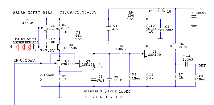

60db-Version 8,5-8,7mA IDSS Post 3069 output cart 0.25mV

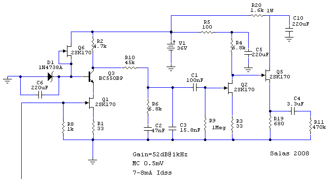

52db-Version 7-8mA IDSS for 0,5mV MCs Post 236

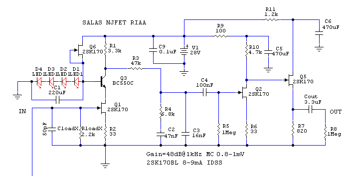

48db-Version 8,0-9,0mA IDSS Post 1813 output cart 0.8-1mV

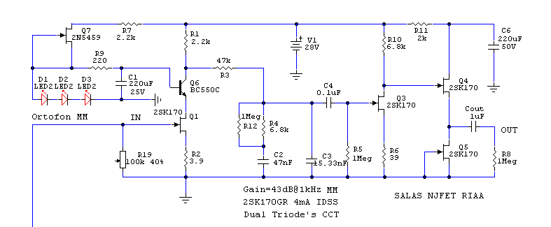

43db-Version 4,0mA IDSS Post 4600 MM output cart 4mV

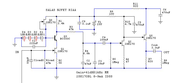

41db-Version 8,0-9,0 mA IDSS Post 1812 output cart 2-5mV

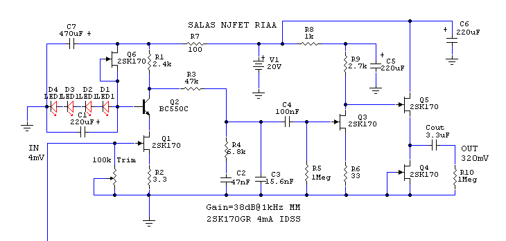

38db-Version 4,0 mA IDSS Post 5118 MM output 4mV
