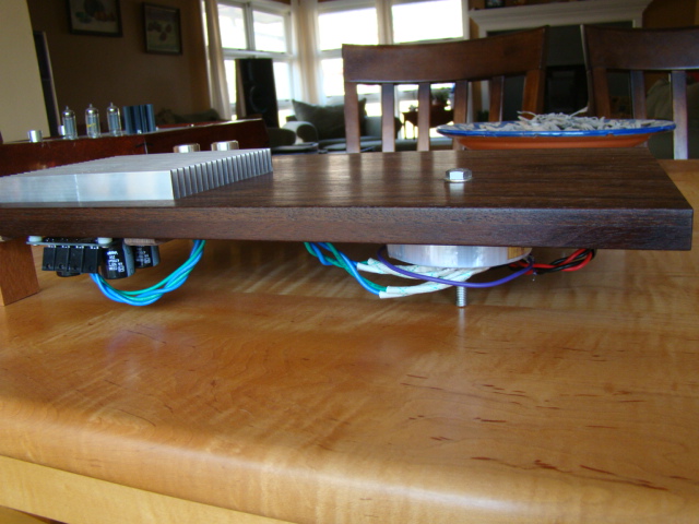

nice work on the enclosure Evan, you really should make yourself an LOD for the ipad to replace that mini2mini. if you need instructions or a dock connector let me know i'll send one to you. ive started working on mine again for a bit of fun, mainly to use up some tx220 in 4R i have acquired an abundance of and also because ive stuffed it with such premium parts it would be a shame to not use it before deciding whether or not to flip it on. as ive said before, i dont really need a buffer, but its such a cool OTT design
Cool way to mount it in a wooden board. Nice. Big speakers, efficient doublets I suppose. What is the voltage gain of the amp and the speakers SPL/1W? Is the volume range practical with a buffer?
Thanks... Again I feel like a trained monkey. Yes the speakers are big, just ask my wife. The bass drivers and tweeter are padded down to match the beta12lta at about 97 db/w/m The amp is a dual mono f5 dc coupled. It drives the beta12 and the tweeters. The system seems to offer plenty of gain. I'll tell you better when the house is empty. The heatsinks are cool after a few hours of playing so I guess it's time to up the current.
