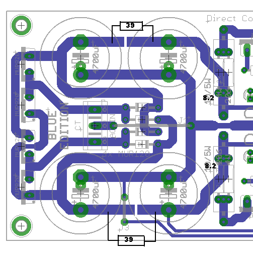

Looking for a TX for a hotrod build, would this be ok
Amveco Magnetics 70063K
dual 115Vac inputs and dual 15Vac output at 12.5Va
Also found this but might be too much,
Chia Yu Co Ltd * Input: 2 X 120Vac 50-60Hz 3" Dia X 1 1/2" Tall Output 42Vct 21V- 0 - 21V 80VA
That is effectively pre regulating. Technically sound, but a large drop times high constant current will produce heat also on the pre reg, plus you introduce complexity that will give a different subjective result since you are wrapping the super reg in a typical chip. I would much more prefer a CRC passive pre filter, with resistors of value and Wattage/sinking to drop properly. That rectified and filtered output has to go directly to the filter caps pads on the blue at +/-20V DCin. Maybe 39R 5W amongst two 4700uF made externally or by hacking the board. That would drop about 8V for each rail of a +/-200mA set CCS on a blue.
You can break the copper connections between + to + and - to - of blue's 4700uF pos and neg filter cap pairs and introduce a 39R 5W per rail between them underneath. With 8R2 5W set resistors where it says 10R 5W, will surely create an around +/-20VDC final DCin to the regs when using a 2x21VAC trafo. Use 35V caps, no less.
Oh, and thanks for this info. I was hoping to use a spare 30VA 18-0-18 traffo just to get me going. This helps a lot.

Guess what, I have "found" a whole bag of 10x BC550Cs in my box of delights, so the single reg RIAA shunt is on the road again. I'm getting 25.56v DC out and Vdrop across the 3K3 is 21.61v DC
Remind me how to calculate for a 28-30v supply will you...
By the way, this is with 1.7Vf leds.

3.978k in total. Add one in series to the 3k3 that will get it about there, or make some other new combination from paralleled ones, whatever.
