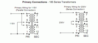

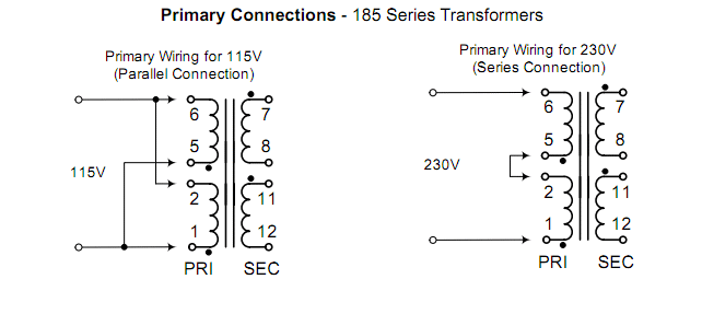

Just a last question before I ridiculize my knowledge... Are primary voltages alright for EU: 0-115, 0-115? That gives 230 V, right?
