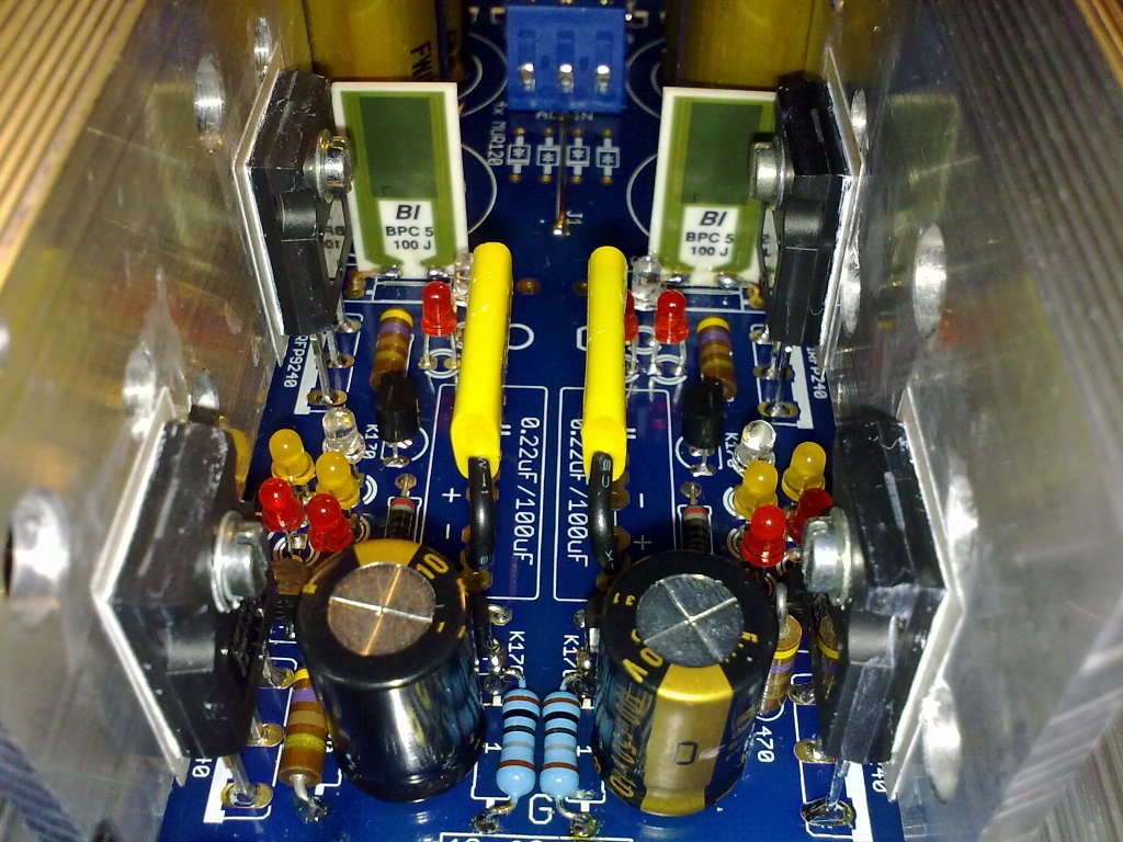

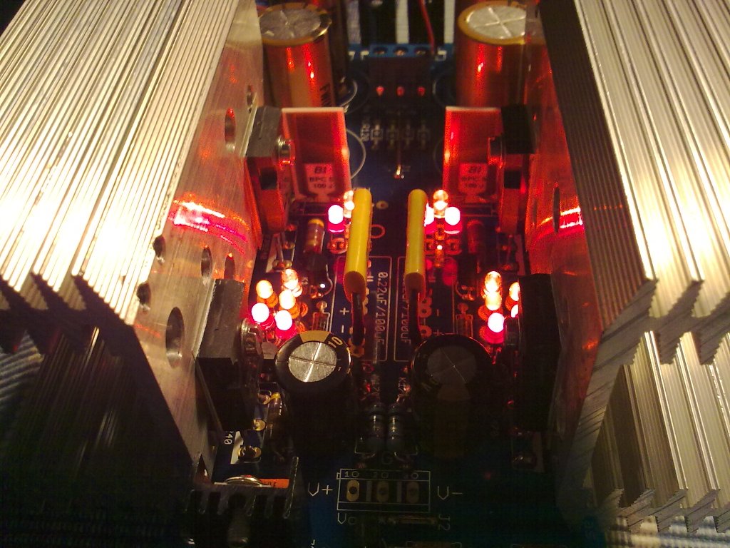

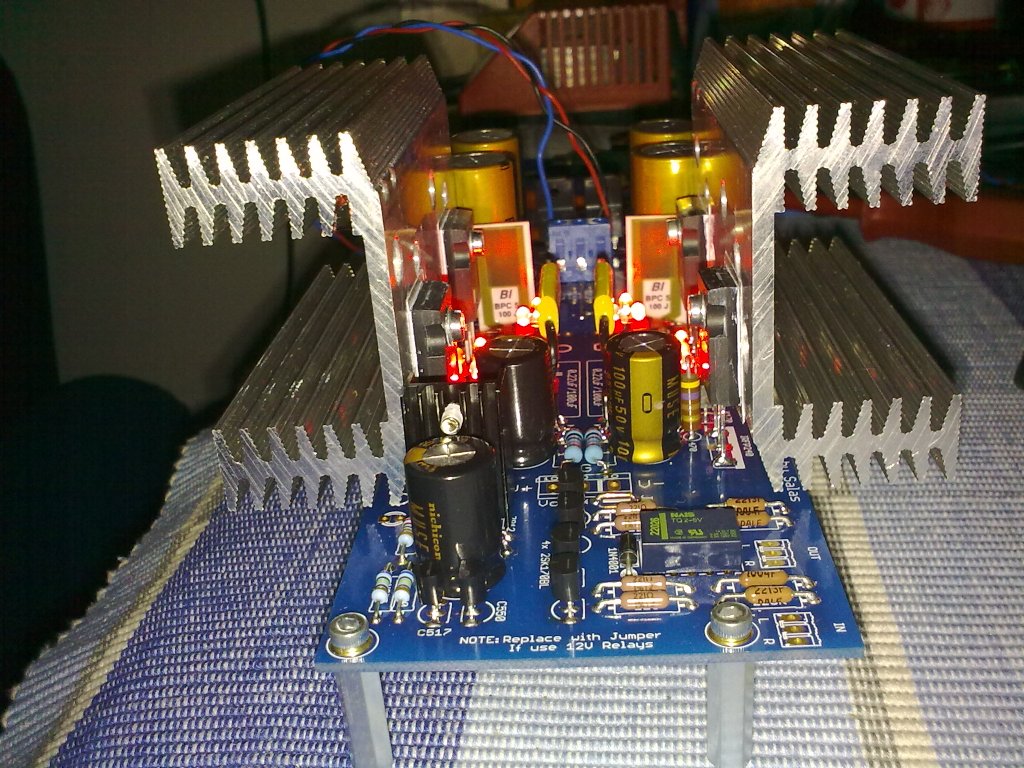

Hi, I just fired up my DCB1 for the first time, and so far it's looking good. I haven't listened to it yet since I haven't put together a dedicated PSU (fuse, switch, xformer...), it's now being powered from my benchtop PSU.
I built the 10R version for now, maybe I'll up the current later. The power resistors I used are non-inductive planar 10R 5w thick film resistors (BI Technologies BPC5100J). The noise figures are comparable with metal film it seems. I just thought I'd give these a try, and since I'm using many fancy flavoured parts (at least for my taste) it fits the bill. I had to remove the original legs, which were some clamp-on soldered types, and fit them with bent copper leads since the original spacing was too small for the board.
The MOSFETs are IRFP140N/9140N. The 5-LED chain is matched to 9.30V/9.29V (values measured in circuit), using 12VDC and 1k in series with it. The 3-LED chain was matched to 5.59V/5.58V (measured in circuit). The 5-LED chains are fed by 2SK170 that I once measured to have an I_dss of 9.42mA/9.54mA. The 3-LED chain is fed by 9.29mA/9.36mA JFETs. The other two JFETs in the shunt section measured 8.49mA/8.39mA.
For the BC550/560 I used ON semi parts since they have the smallest noise figure according to their datasheet.
The resistors at the IRFPs' gates are 470R 5% 0.5W Allen Bradley carbon comp resistors. All other non-audio resistors are MRS25 1% 50ppm 0.6W metal film resistors, except for the 1R resistors which are MF50 1R 1% 50ppm 0.5W metal film.
In the buffer itself I used the following parts: The 2SK170 pairs are matched to 8.02mA/8.00mA (upper/lower) and 7.97mA/7.95mA. The 221R resistors are Vishay-Dale CMF55D and the 1M/221k resistors are Vishay-Dale RN55D.
The relay is a Nais TQ2-5V.
The PSU caps are Nichicon FW 4700uF/35V types, the other electrolytic caps are Nichicon Muse 100uF/50V.
The bypass caps for the 5-LED chain are NCC (Nippon Chemi-Con) FNX-HS 0.47uF/100V film and foil polypropylene. I am using them as the input coupling caps in my headphone amp and I believe they sound right. I left the leads long so they can be easily changed, should I once fell the urge to see if a different cap in this place makes an audible difference.
Now for some numbers I pulled from the circuit (remember, they're fed from a benchtop DC PSU; numbers in brackets are other channel/polarity; voltages in reference to ground unless otherwise noted):
V_input = 19.85V(-19.93V) before rectifier
V_before10R = 19.18V(-19.26V)
V_after10R = 17.85V(-17.67V)
Therefore V_drop10R = 1.33V(1.59V)
and assuming the resistors are R=10Ohm we have a current of
I_through10R = 133mA(159mA)
The first IRFP140 measures -13.66V/-9.95V/-17.67 (pin 1/2/3 G/D/S) and the second one -5.96V/GND/-9.95V
The other polarity's first IRFP9140N measures 13.61V/9.94V/17.58V and the second one 6.02V/GND/9.94V (again pin 1/2/3 G/D/S)
The supply voltage for the buffer is 9.94V(-9.95V) accordingly.
Over the LED chains (not to ground, mind you) I measured 9.30V(9.29V) and 5.59V(5.58V).
After 20 minutes the output offset measures -1mV(-2mV) and seems to stay there; the inputs were not grounded taking this measurement. The heatsinks, salvaged from a SMPS, get warm (maybe 40°C/104°F) but not hot.
One problem I might have to solve is that I didn't have a BC517 on hands and used a BC547 instead. It seems that the relay briefly oscillates before it latches. Not good.
