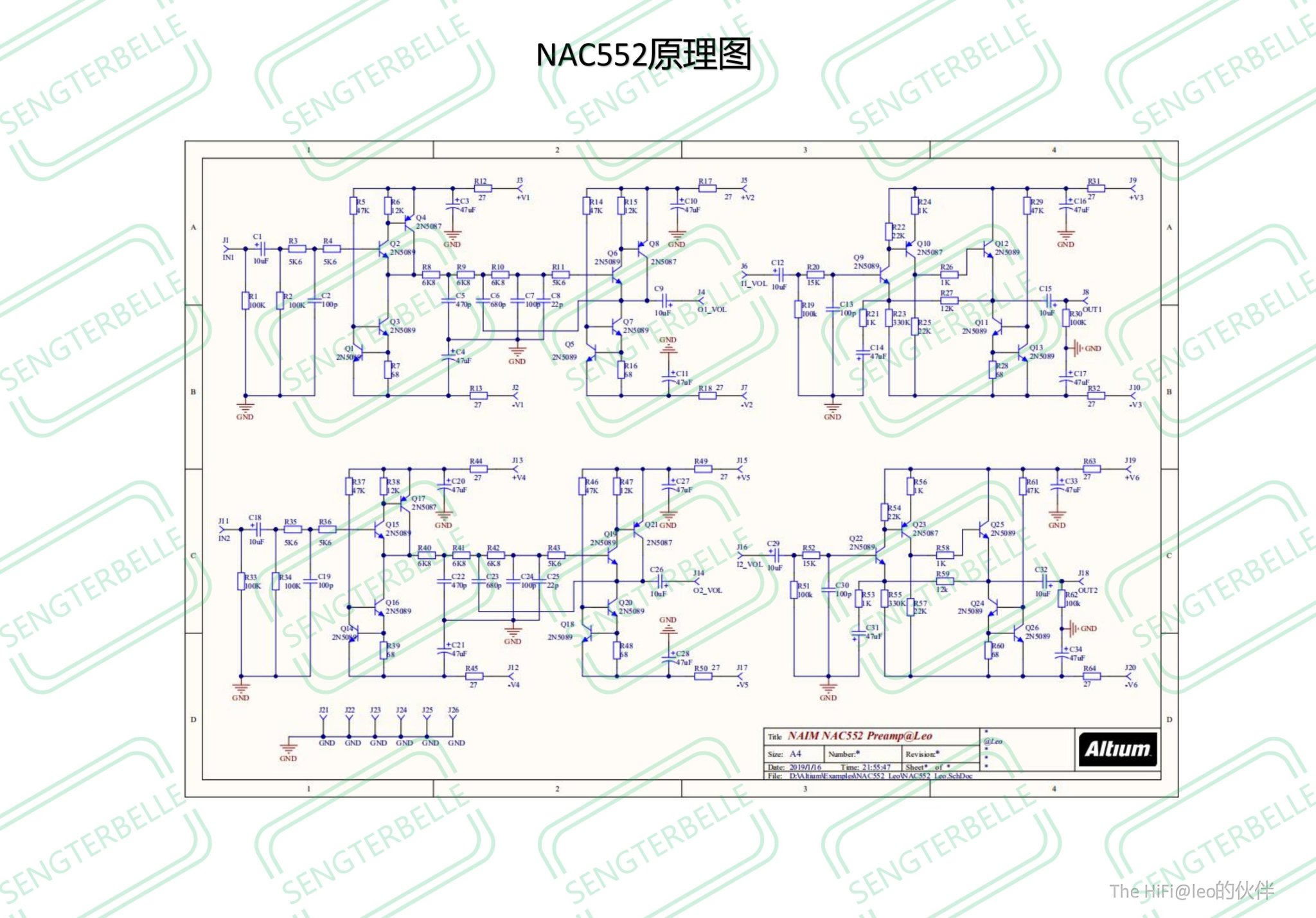

In this case complitely insane example of NAIM552 clone:
it reques 8 rails in buffer and 4 in gain section.

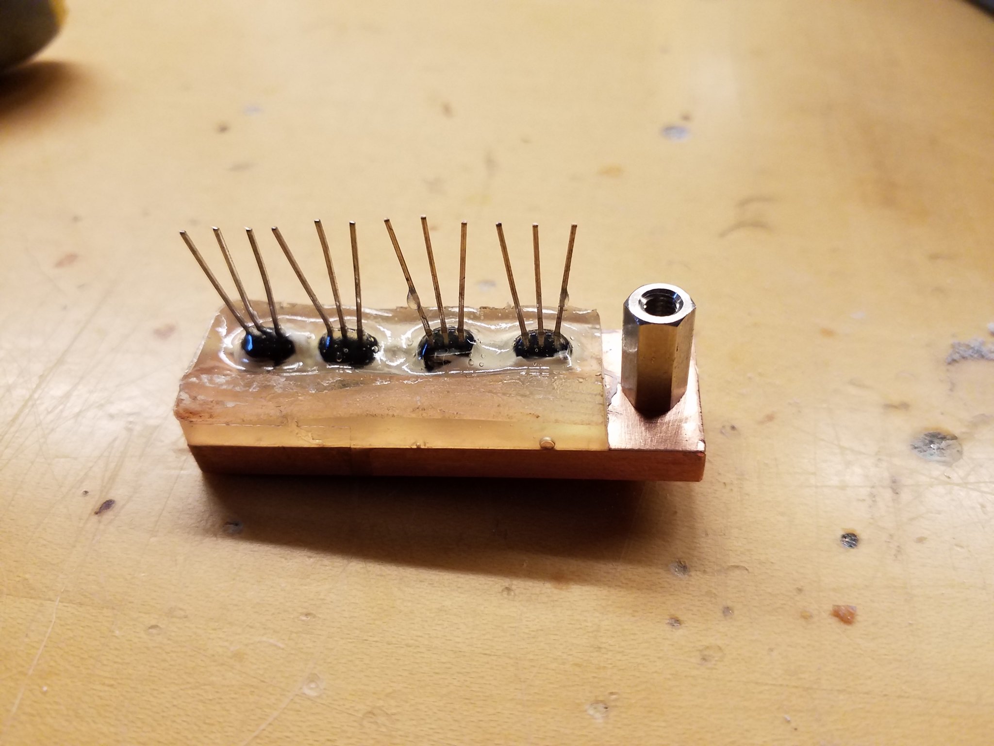

Output pairs 2sk170 , copper bar drilled four holes, matched transistors in, fill with epoxy, no drift, dc offset, is rock steady 2.5 mv.
A trick I wanted to share.
Pic 2 was before I noticed drift. Yes yes it's the old design, but still rocks,

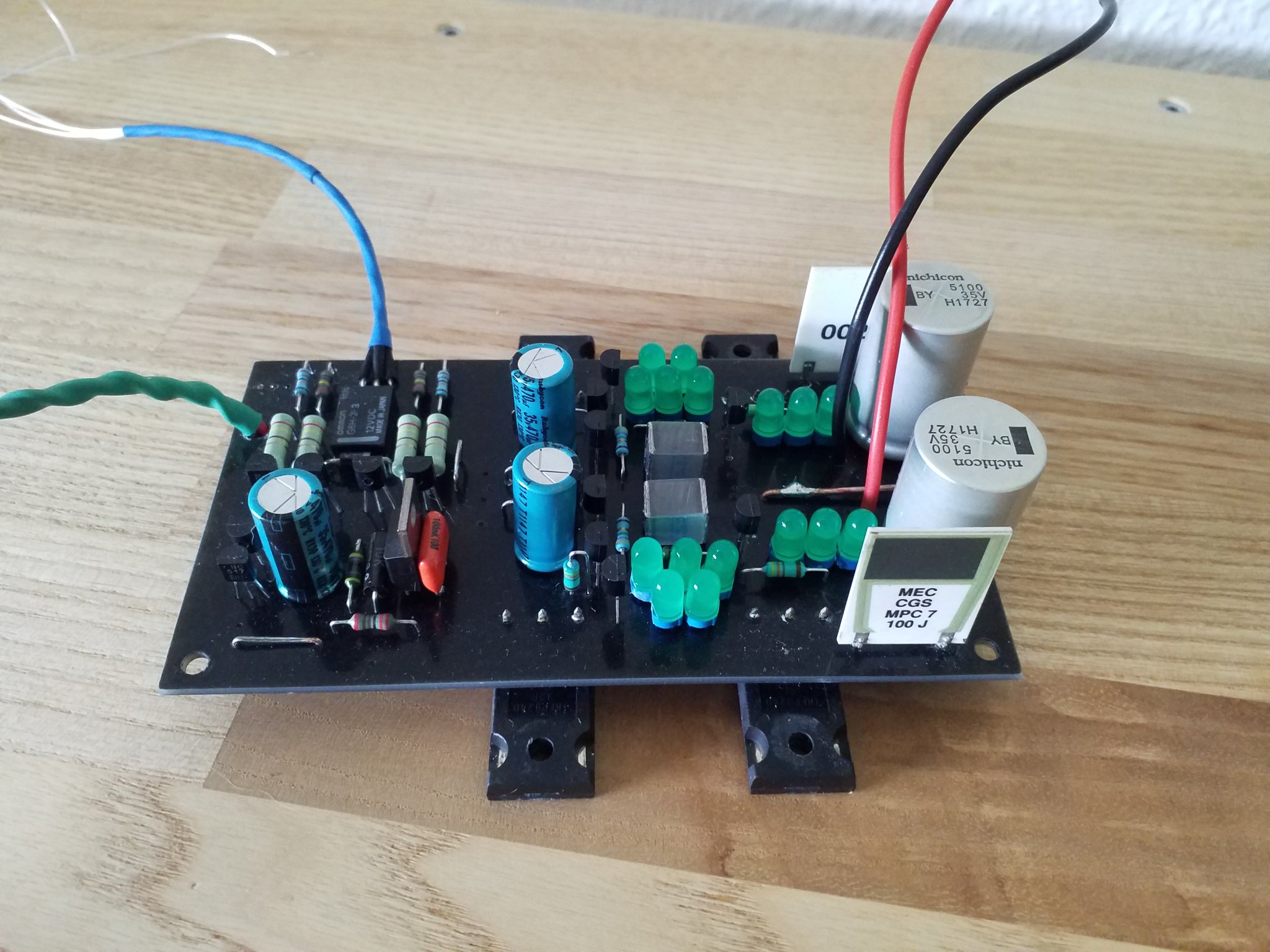

Dumb question time... I made one of these many years ago but lost interest in audio for a few years. Just getting it back out and I didn't label the in/out sockets. I'm assuming the board is fed by the input sockets and then it outputs to the volume control and then the output sockets. Is that right? I spent ages searching for clues online ;-( so thought I'd just ask.
I really appreciate the replies but I'm still confused. It's a hypnotize board and one set of RCAs is wired directly to the volume pot and one set isn't. It has only one input so no selector. Is it the input or output that is wired to the volume pot?
It's plugged in and it's working beautifully but I have one more probably naive question....
I stopped using it a long time ago because I was using an AV receiver to power my six channel LXmini speakers (with subs). Now I have a straight power amp so the DCB1 is attenuating the volume. It sounds a lot better from memory, maybe due to increased power from the amp and gain structure.
The speakers use two miniDSP 2x4 units that take 5-24v power (150mA). So... is it possible to use the 10v supply from the middle of the DCB1 board to power these? Any drawbacks? And if so can I just parallel two sockets from the board?

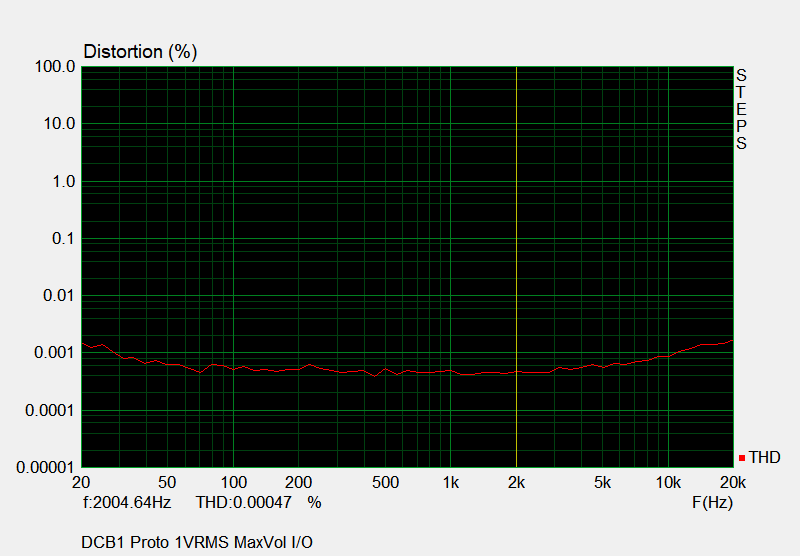

Nice to know that it works and sounds nice. Not only the gain structure is more adequate. This combination probably beats that AVR for performance a lot too. Here's a THD sweep from my DCB1 prototype at 1VRMS output.
Regarding tapping off from the DCB1's shunt regulated PSU to power peripherals its generally doable. Especially digital boxes seem to benefit a lot from a linear supply because no more switching noise bleeds in the ground. We had many positive reports with using L-Adaper for such. Drawbacks aren't obvious to predict but someone must optimally have the lab means to confirm no compromise in the preamp's own spec. Due to possible interference on the rail. But in your case 150mA x2 load is too much for the current limit setting if its a normal dissipation build and not a super hot rod PSU bias job with huge sinks as some folks used to make.
Reactions: stax92
Thanks Salas for the information and quick reply. I used a 10 ohm 5W resistor so I guess that's a 600mA hotrod?
If there's a risk of it compromising performance I'll leave it be, the idea was mostly for convenience but I also read somewhere that the miniDSP units are susceptible to power supply noise. No doubt there's a better solution, maybe just a better quality wallwart/smps. There are upgrade options for the 2x4 units themselves, or even Nelson Pass' passive crossovers so I won't go chasing rainbows!
