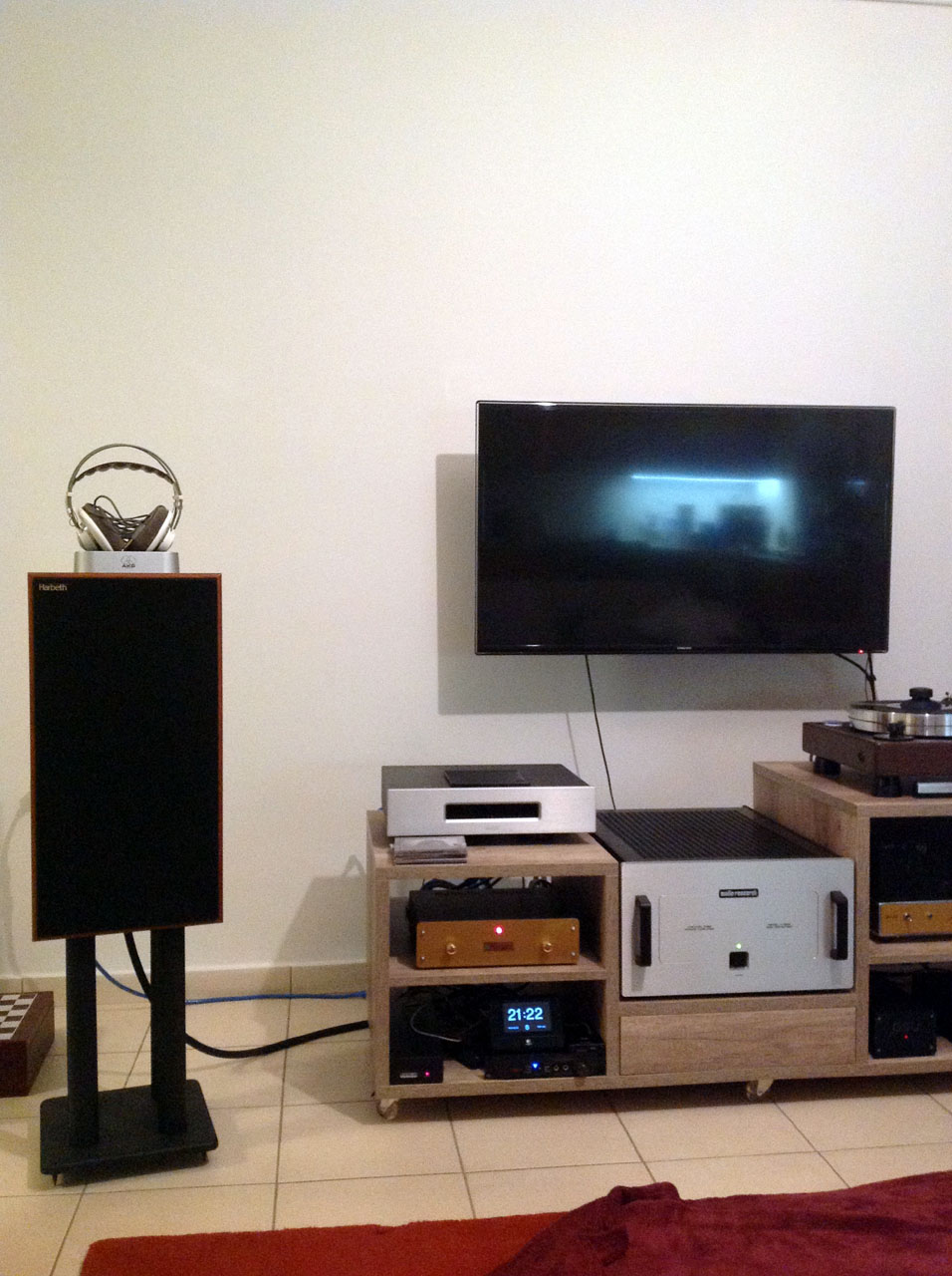

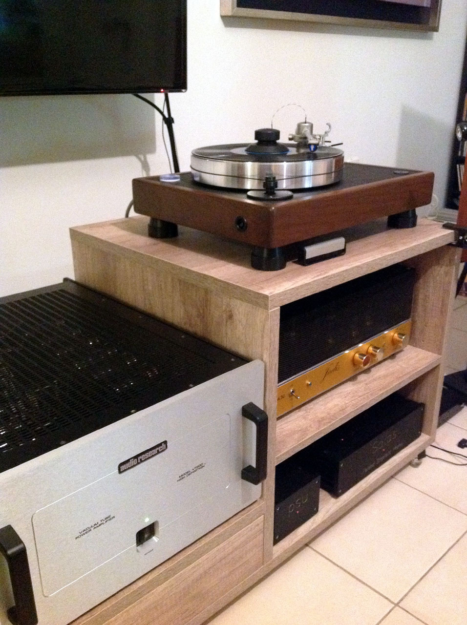

Here is a misleading nonsensical story on the same theme from me:
I was helping to retube & readjust my good friend's Audio Research VT200 some days ago. A demanding task both for moving around the beast and performing a juggling act when balancing its AC & DC test points looking for its service manual exact voltages and low THD via a multitude of interacting trimmers per channel. Its a four stage symmetrical 200W stereo power amp service affair that took the whole evening among three of us there.
We happily listened to it play again, its a nice system that was down for months due to a couple of 6550 tubes went out catastrophically. Has sixteen of those in groups of four. They killed grid and cathode resistors too. We replaced all 6550s and all ten 6922s.
From when he first put that system together a few years ago he was not happy with his SPL volume control response on a DCB1 long test, he was finding the system quiet enough and lacking in dynamics. He got happy back then only when he adopted a DIY preamp set at 4 times line gain (12dB).
That Audio Research has 22dB gain from SE input at its 8 Ohm taps and his Harbeth SHL5 speakers are 86dB sensitive.
Lets now try my friend's real life comfort zone against my silly "around 120" rule of thumb:
12dB line gain + 22dB amp gain + 86dB loudspeakers = 120 😀
