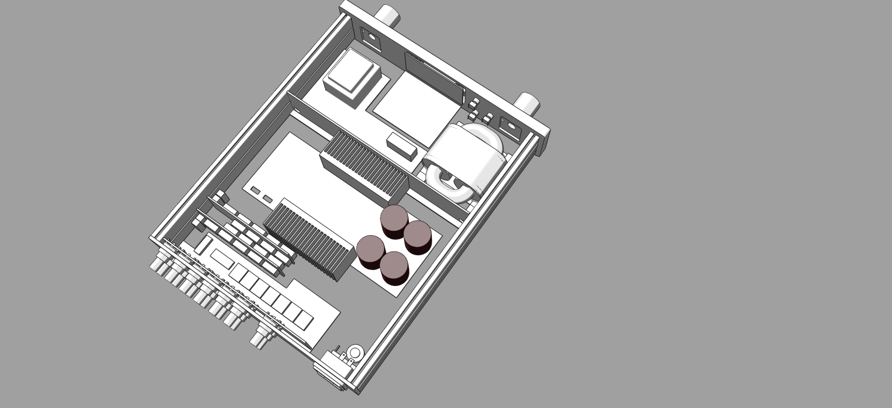

Why don't you put your transformer in the front left corner? So the cables go between the side and the DCB1 filter cap...
yep considering that, .....and if you look a the hifi2000 alu side profile you will notice it has a channel with partial opening to the inside of the box....nice to route cables while shielding them if i earth the box....which i will ofcourse.

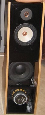

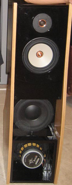

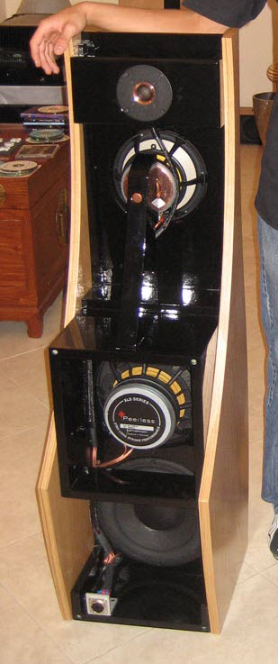

I bet you have put much effort in the Orion build as you are fascinated by mechanicals and finish. Any pictures of those?
Hi Salas,
these are all i got here at the office....got lots more at home if you are interested.
..just noticed a mistake above...it's Arcam Diva 73....not 37.

So its the latest with back mount on vertical brace and ambient tweeter. Does it balance well in your room? Needs breathing space.
yes these do need breathing space distance from backwall and side is essential
but my living room is around 45 m2 so it's plenty big enough.
These are Orion+ version i'm in the process of upgrading the ASP to Orion 3.2....which is the latest.
edit: ah yes the sound.......gorgeous, real very real !
well following your sugestion i worked on it a bit and....it fits ...with milimeters to spare....🙂
Had to abandon the vampire RCAs...gained 10mm by using these round ones and that made all the diference.
how's this look...Salas ?
Nice layout!! You might need to add some weight on the back corner (diagonally to the transformer) to balance the chassis...
If you will use a shielded power inlet like those filtered ones and tuck the AC cable in the side panel's rail, I think it will pass hum standard.
