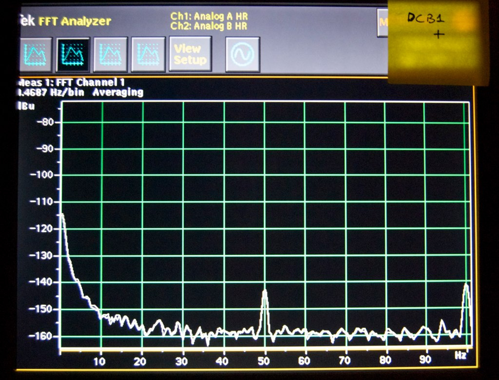

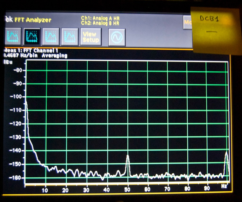

The higher the uF value filtering the voltage reference the less 1/F noise mainly. 1/F or flicker noise is the rising build up to the far left spectrum of a chart we encounter in all things electronic and some other in physics.
I had presented incremental simulations for the reg part in the past. Beyond 100uF gains slow much for the full band's filtering benefit and only 1/F gets better. About 1000uF is a practical level off. Mind you the charge can kickback to the associated Jfet in case of a mishap. Not common, maybe if probing the wrong way or during a wider failure.
Since different applications circuits have different soft spots regarding integrated noise level and its spectral characteristics, like some MC phono vs a buffer pre vs a digital clock etc. there was some flexibility built in the Hypnotize pcb so to have positions both for electrolytic and film Vref filtering capacitors. The Wima MKP10 0.22uF was chosen subjectively by some members vs other logical cost and available MKP parts they compared. PIO caps are inferior to MKP for HF filtering.
Same members concluded they prefer the film cap for tone especially in the rendering of female voices in the DCB1 context. Maybe the parasitic characteristics of the electrolytics vs the films given the sufficiently low noise of this reg when feeding a no gain line level circuit. When non filtered than only lightly in the HF for minimum wide band noise control from the film cap.
I have 100uF standard in the Mezmerize as originally voiced, the Hypnotize has space for options.
As you understand its a decide for yourself thing in the context of your taste and audio system in the Hypnotize.
Here are +/- PSU noise charts done by a member from Spain on a Mez once and shown sometimes before. Has the 100uF Mez standard filtering. 1/F climb can be seen to the left. Also the 50Hz and 100Hz European mains hum and its first harmonic pick up on the rails in the context of a fully built and wired standard Mezmerize with an unshielded 50VA toroid in the same small box.
