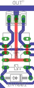

Is that ACV or mV? Use ACV if it did not fit to scale bcs there are many zeroes. Shows symmetry for presence of live points to left and right whatever it is though. What exact type of relay you got there? I mean what it reads on top of it.

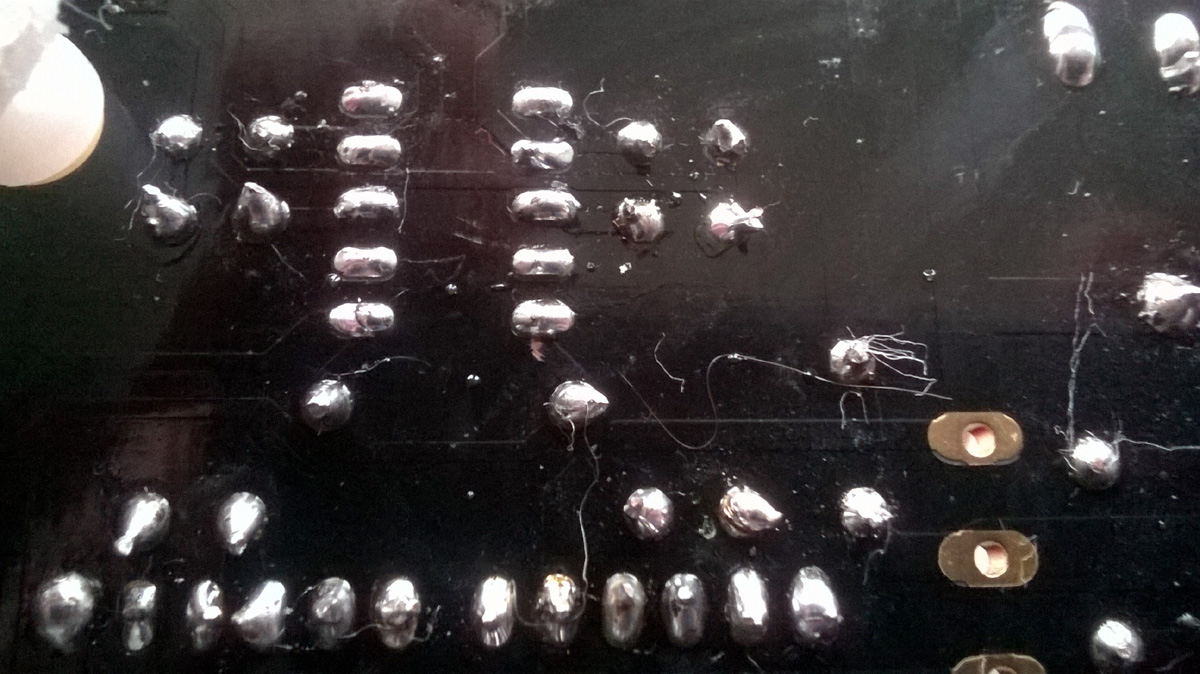

See underneath it that no solder bridges are formed, especially with the thin track that passes horizontally (bottom tracks depicted in blue). Retouch for cold joints.

I remember looking at lots of pictures to decide which way round it went and settling with the solid line towards the IN4001 - could it be the wrong way round?
I measured with mV but I'll try with V when I get home and I'll check the joints but I remember being pleased with how it went in as I'm new to this (obviously) and it looked a neat job. I'll check again.

Looking at your picture at post #4331, your relay orientation is the same as mine and it's working in my case.

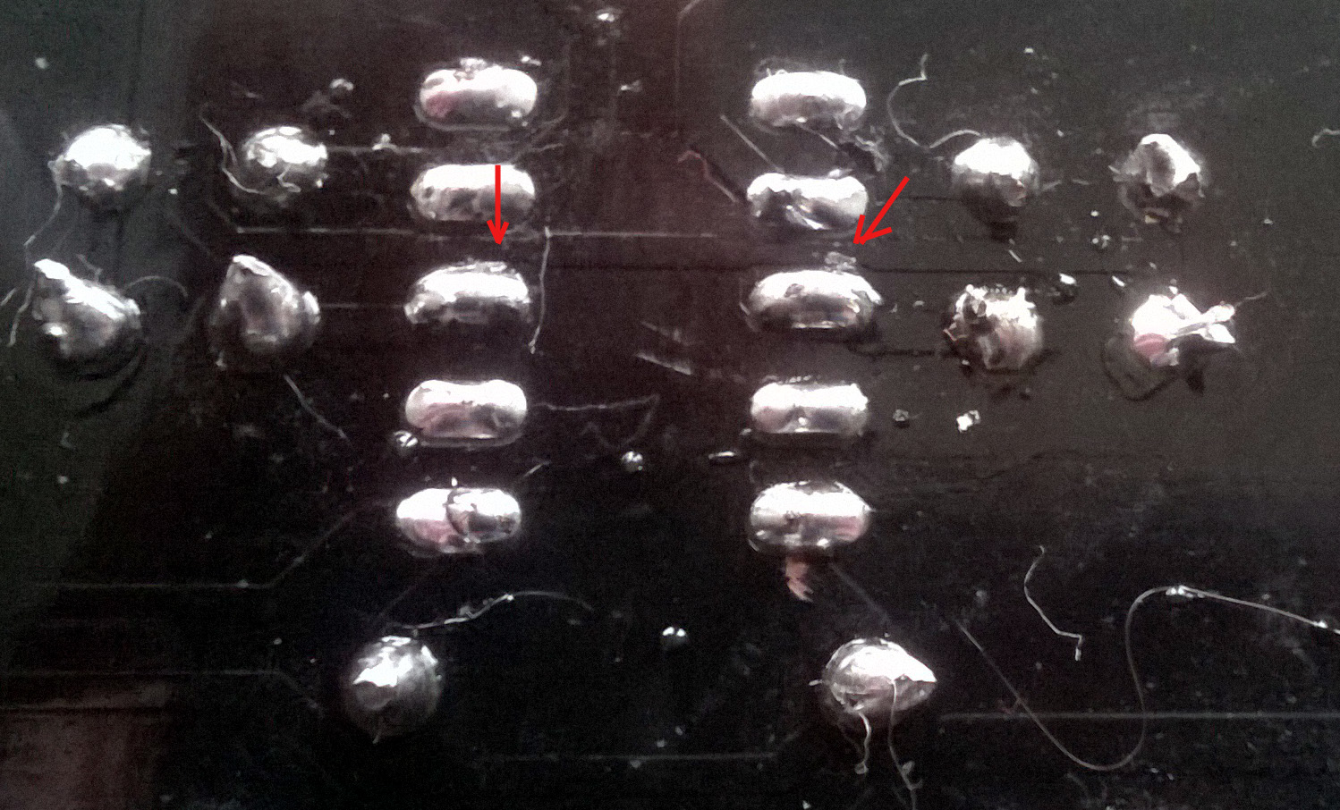

I checked the soldering around the relay and I don't think I can improve on it. Picture attached (the whispy bits are from a cotton wool bud that I used to clean the board with alcohol and are gone now).
I tested those points with the DMM on V and the results are similar (e.g. 2.9 mV now flicks between 0.002 and 0.003). Are there any more checks I can do? Does the fact that plugging the right RCA in mutes both channels give any clues?

See its very clean with no whiskers at all. There are also solder bits to clean where the arrows show, especially where the right arrow is. The readings should have been many average mV in AC DMM mode when high music signal is playing but better try find a sinewave file so it will be steadier.
Do those connections look that bad?
Sorry, I was reading DC. The lowest AC range that my DMM has is 200V with a resolution of 100mV so I suppose I can't check those voltages? I may have hit the buffers (no pun intended) with this. It's very demoralising.

The right one especially might be a short. Make sure there are clean gaps between those joints and the thin lane that passes near them.

Its not between the joints but it might be a short between the tin blobs and underlying copper lanes. You see them on the pic as patterns.

Is it likely to be a short around the relay? I cleaned up those two joints plus anything else that looked even slightly suspicious and moved the solder away from the thin tracks but nothing has changed.
