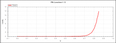

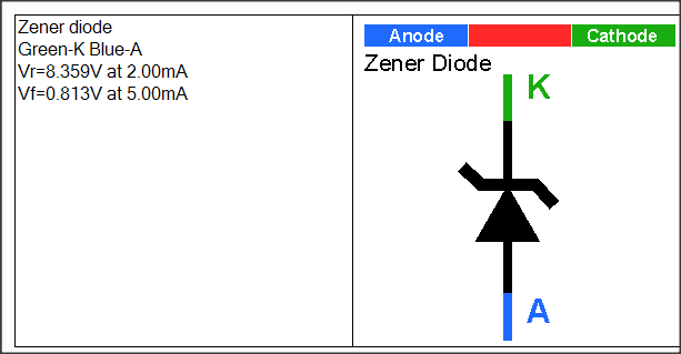

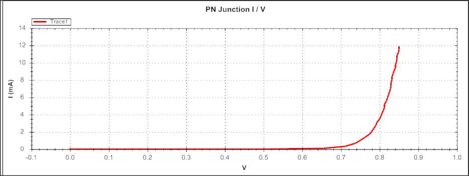

BC550 Vbe is 8.4V with additional 47R or 150R
Here is Philips original BC550C on BE mode, C no connection. Yours behaves alike. No problem there too.
