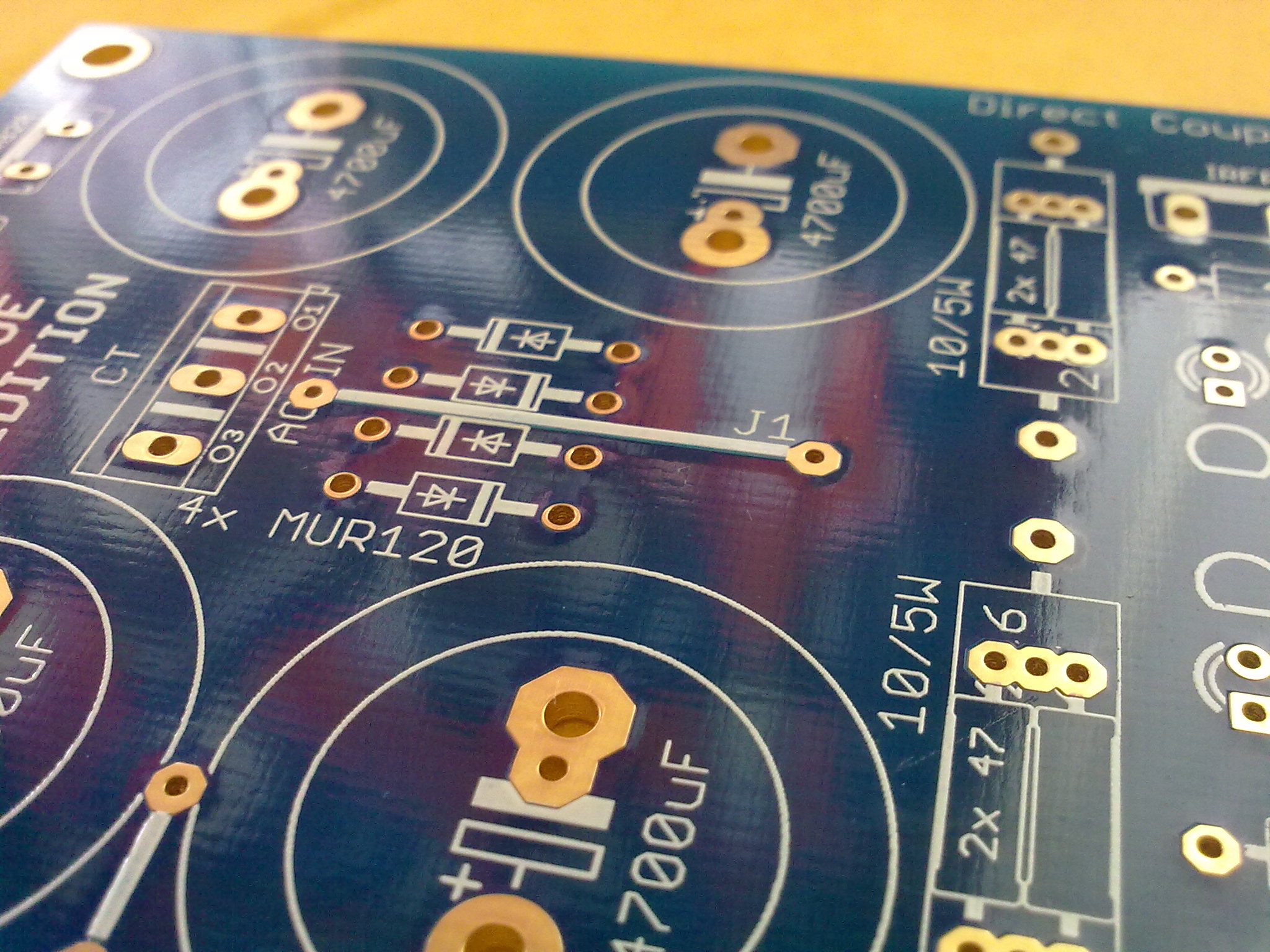

I see that many builders have used wire for the jumpers J1, J2 and J3, but is it really necessary? Upon closer inspection (and measurement) of the pcb I realized that J1, J2 and J3 are already made via a circuit track. Is it worthwhile to add a wire parallel to the existing track to (maybe) create a lower impedance path for the return-current?

There is something a little confusing about this Blue board. Look dead center where the 10 LED's are installed (5 LED's per rail). It seems that the flat back corresponds with the cathode or shorter lead of the LED. I also noticed that the LED's have a square hole side and a circular hole side. You'll see that the square hole for the 3 LED/rail section corresponds with the cathode, but this doesn't seem to be true for the 5 LED/rail side. So is the pictograph of the LED accurate or is it the hole shape that is accurate to designate which way the LED's should be mounted?
Anand.
Anand.
I followed the pictograph. You are correct on the 3led and 5led the pads are switched.
