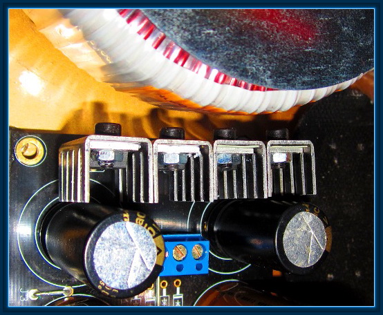

- pict 1 : is it OK if mur820 heatsink connected each other? or should it be insulated? currently i'm using power glue to attach them

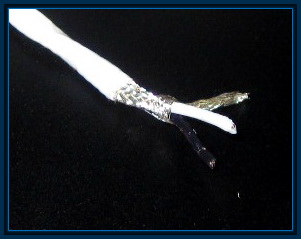

- pict 2 : is cable shield meant to be connected as input ground (hence only need 1 cable for L/R)? or cable shield is not connected?

-No continuity between adjacent diodes tabs must be allowed. Else, smoke.
-One shield for two channels in a cable is enough since they share a common ground line on pcb, and is to be connected.
