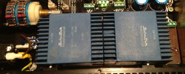

hi,
few quick questions regarding two 35VA pcb 15v transformers I have paralleled. The adjustment R is 2 ohms making it 1.77VDC and 1.92VDC on the rails. Wattage meter shows about 48VA of constant consuming. So as advised by Andrew I'm still in a safe zone :)
1. Trafos have 2x110v primaries, is it safe to use them? Checked the mains during the week and it varies from 218 till 228v.
2. I get quite audible hum when I'm close to them (about 10cm). Could that be reduced somehow? Will mu-metal be helpful here?
