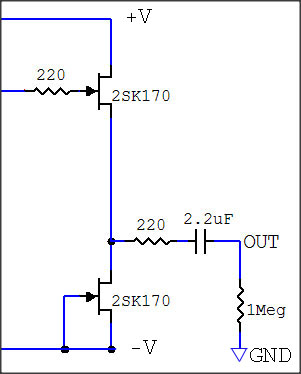

I am finishing my DCB1 build, and since I use will use it with several different amps(one being Aleph 5 monos), I am building it with caps on the output. In post# 295 Salas says to put 1M resisters after the caps so the caps will not be floating. Does this mean to run the caps to the ouput+ and then run the resistors from here to the output-? This is how it appears in the Marra's build photo in post# 342.
