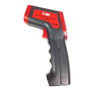

Infra-Red gun.
Like this one. You'll find lots of other uses for one too.
