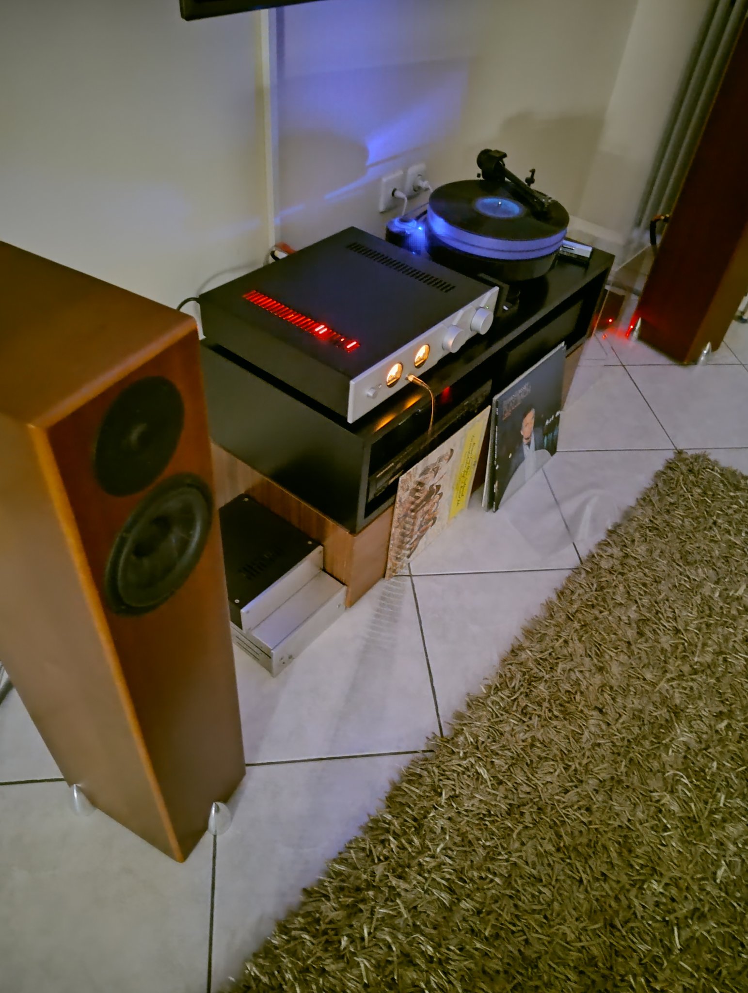

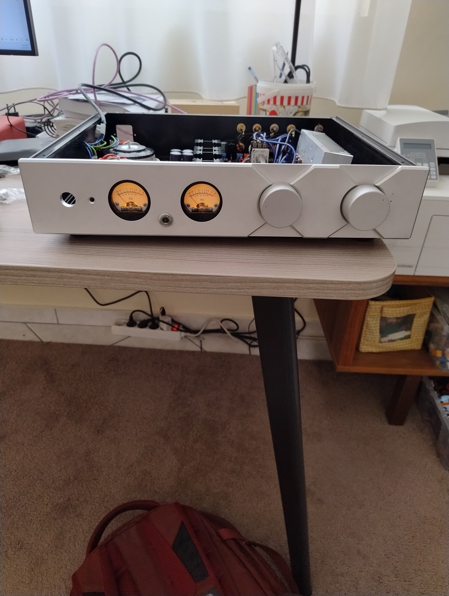

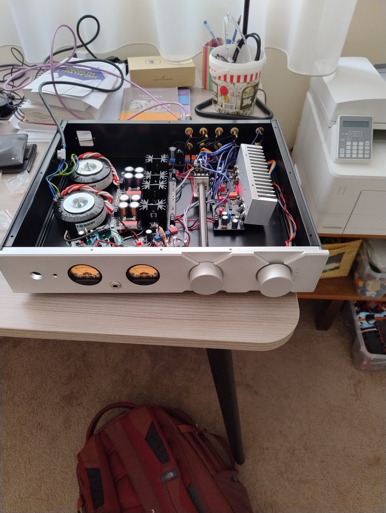

My DCG3 is finally complete. Here some photos of the last stages and final completion and a few comments. With the lid closed, I get 54-55C inside the heat sink, when having the amplifier on the top shelf. I like the outcome a lot. Using it now with AT M50x and Truthear Zero reds for headphones. In the main system I use it with a Trends Audio P10 or (P10.1), I don't remember which one it is. It sounds really good, not as full as the Unison Research S8 (845 tube amp), but really good and in plenty ways better than the tube amp. I may try another power amp in the near future. I am thinking of giving a try to purifi. Any suggestions are welcome. A big thank you for the support and especially to @Salas for offering his designs to the community. Now my system is quite Salas-ized (DCG3 with I-Select and UFSP) 🙂

Looking really good. Congratulations!
The sink doesn't look fully attached to the bottom of the chassis?

The speakers are DIY too? What is the power amp you use again? Trends P10 showed a line/headphones up when I looked it up.
Oh, its a very small power T-Amp for the Totem Hawks. They need at least a Fosi V3 with 48V PSU to wake up. Then you'll also get more of the DCG3 potential coming through.

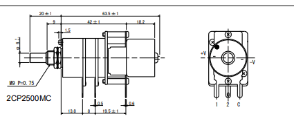

For the potentiometer connection (TKD 2511) , the connection is as follows:
Input signal to L/R pins of 1, output from pin 2 to pream board. C is ground, how do I connect it correctly? Thanks 🙂

If yours is a single input only configuration, just continue from RCA barrel pin through signal wiring to pot pin "C" to ground point "G" line-in DCG3 terminal.
*If when touching the volume knob you will get some buzz then run a thin wire from a point C and jam it between the mounting nut for the bracket and the pot.

Use some spacers for secure support heatsink.
don't allow the heatsink to stress the legs of the transistors!

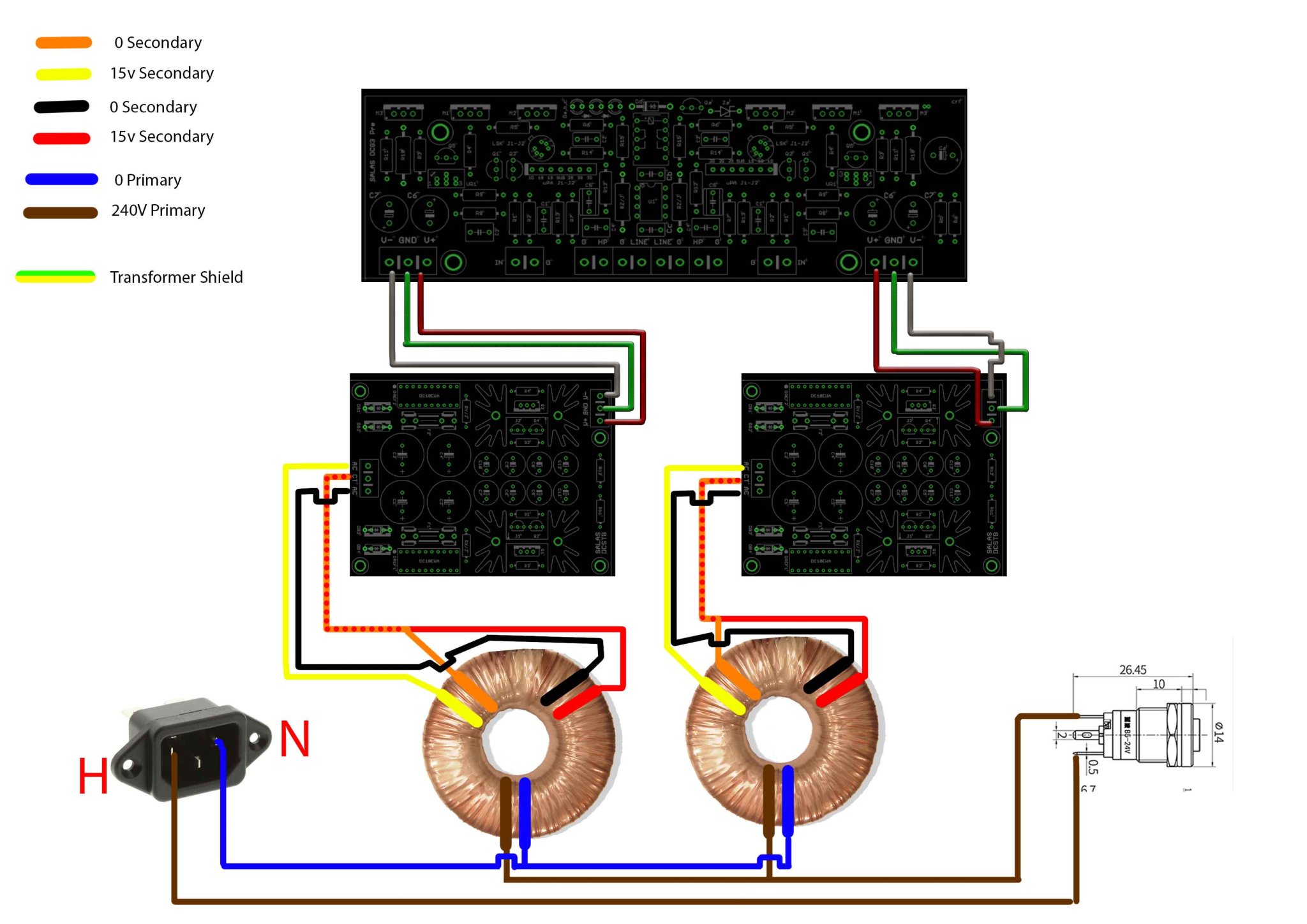

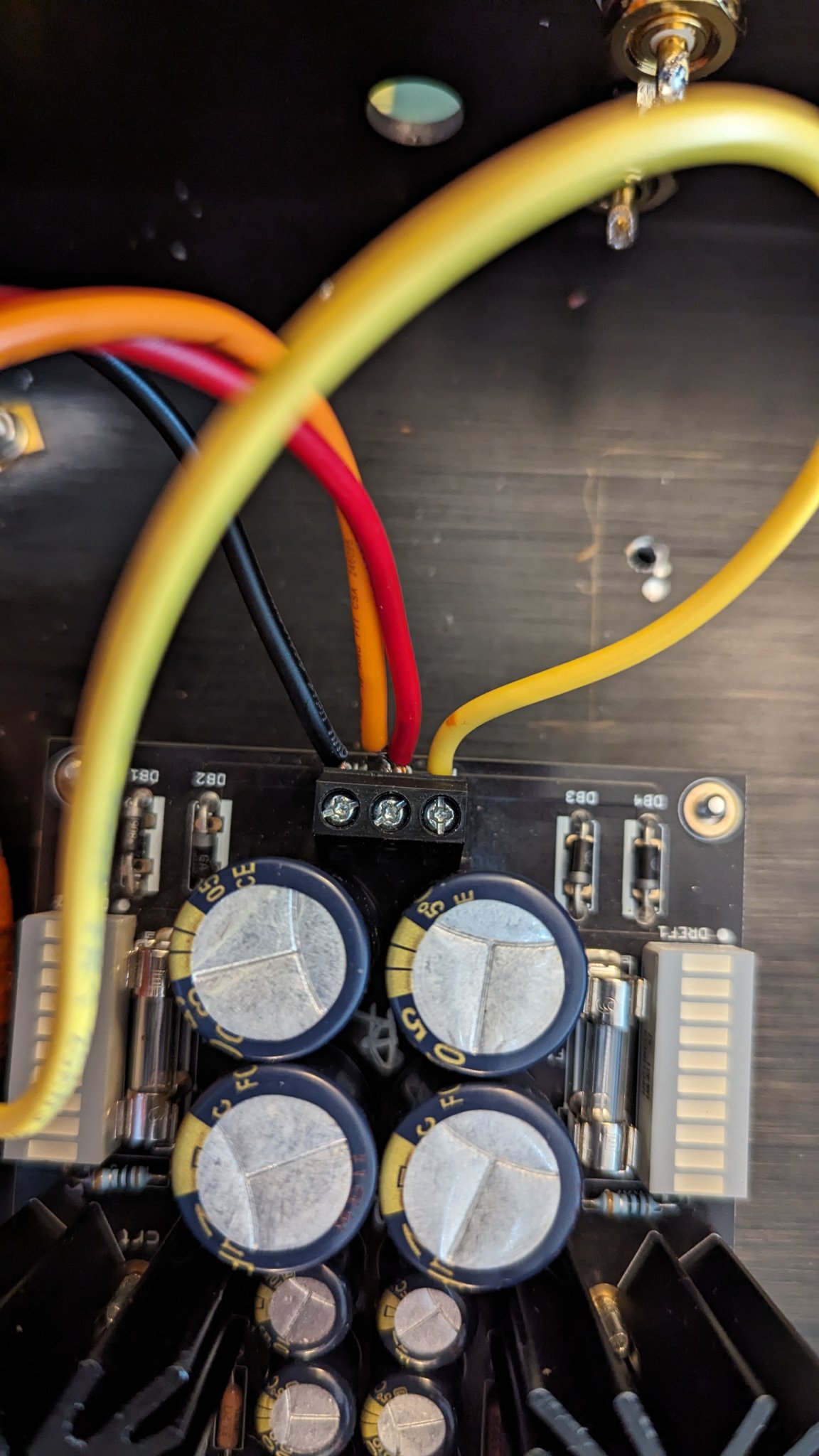

You mean just to twist them together, otherwise connections are correct?Regarding your wiring plan I would rather exchange red with black secondary wires in the diagram.
I mean red & orange twisted together and connected to the center screw of the DCSTB's AC input connector. Yellow and black each one to each outer screw of the AC input connector.
Thank you. Regarding primary wires towards switch. In the scheme I drew I have brown 0 wires attached to on/on switch pins. Or it should be blue one, denoted 240v by the manufacturer?

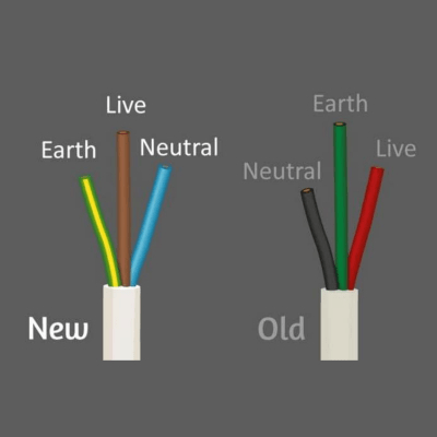

Brown is live blue is neutral green/yellow is protective earth in UK mains new color code (after 2006). Tiger Toroids UK would have used brown for live too.
Thank you for your patience, to be honest I am not too keen on asking basic questions, I could figure it out myself but when it comes to mains I am getting a bit worried things might go not the way I wanted 🙂 Imagine what would happen if I had connected secondary wires in the wrong order....
When Tiger sent me transformers note stated:
"colour code as below
prim 0 - 240v
blue brown
sec 0 - 15v
black red
orange yellow"
So I assumed blue and black 0, red yellow 15V. I admit I don't know how centre tap works.
PSU board are connected, and wired (temporarily) as in the scheme v2. Pre board is not connected yet.
