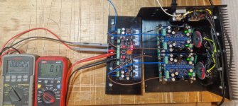

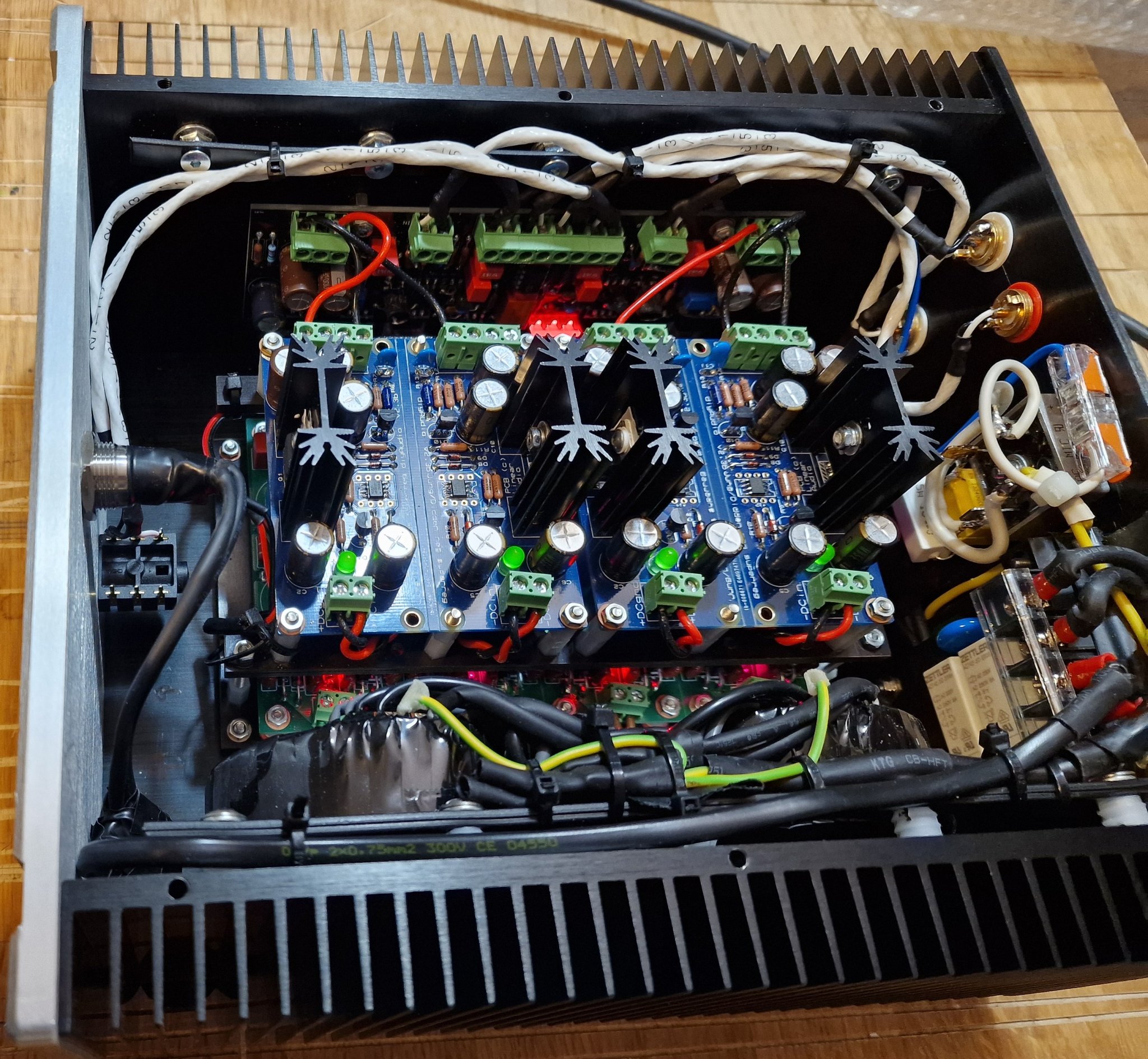

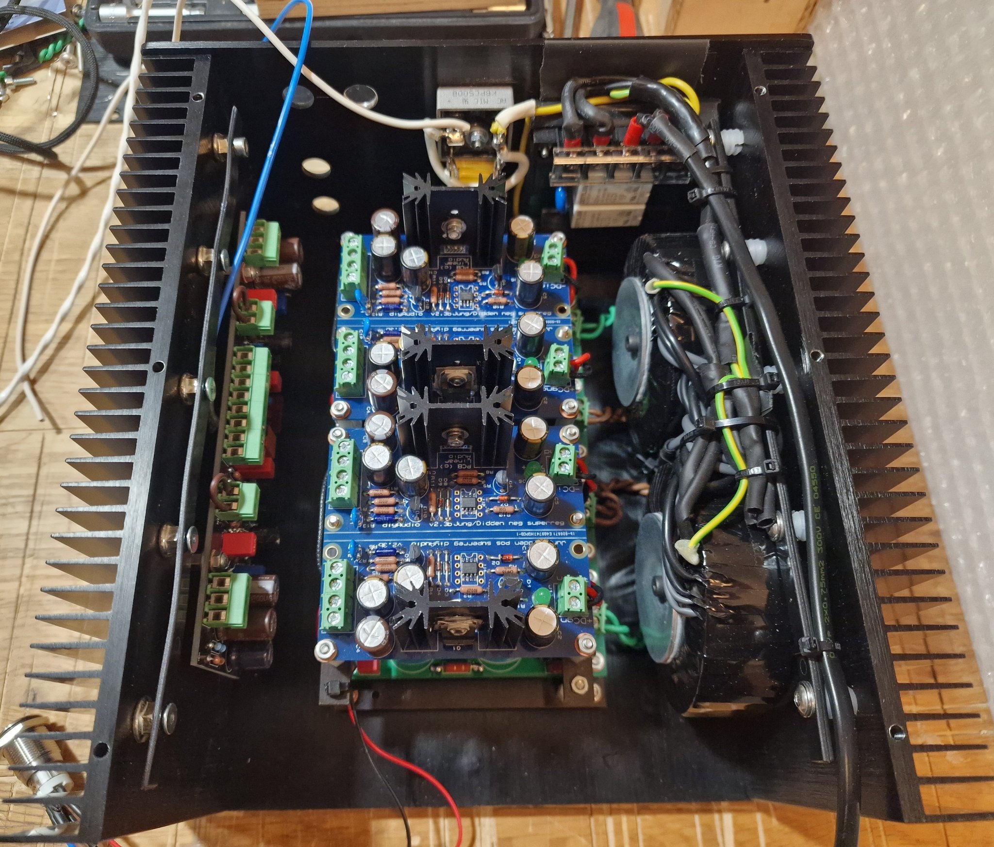

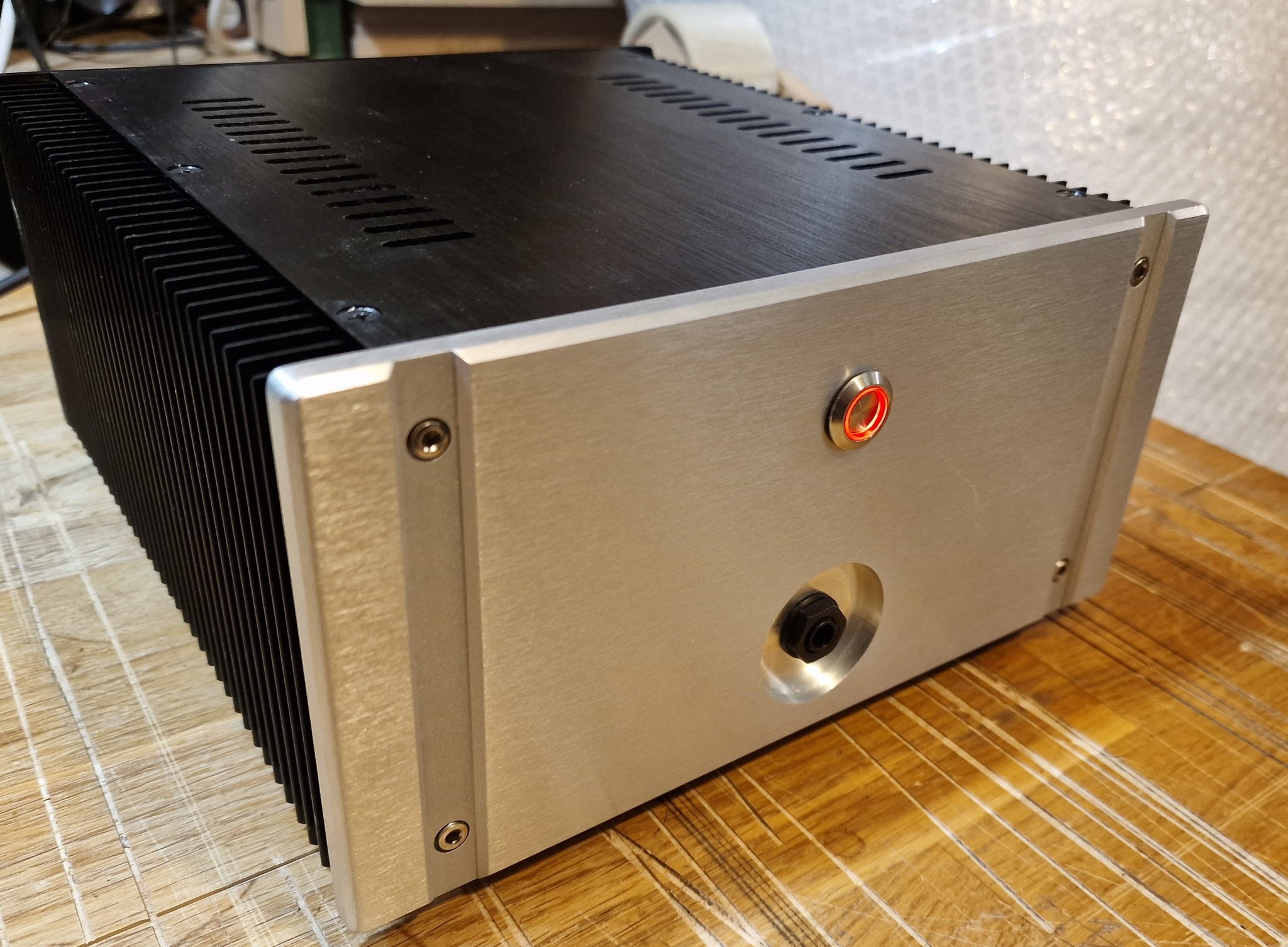

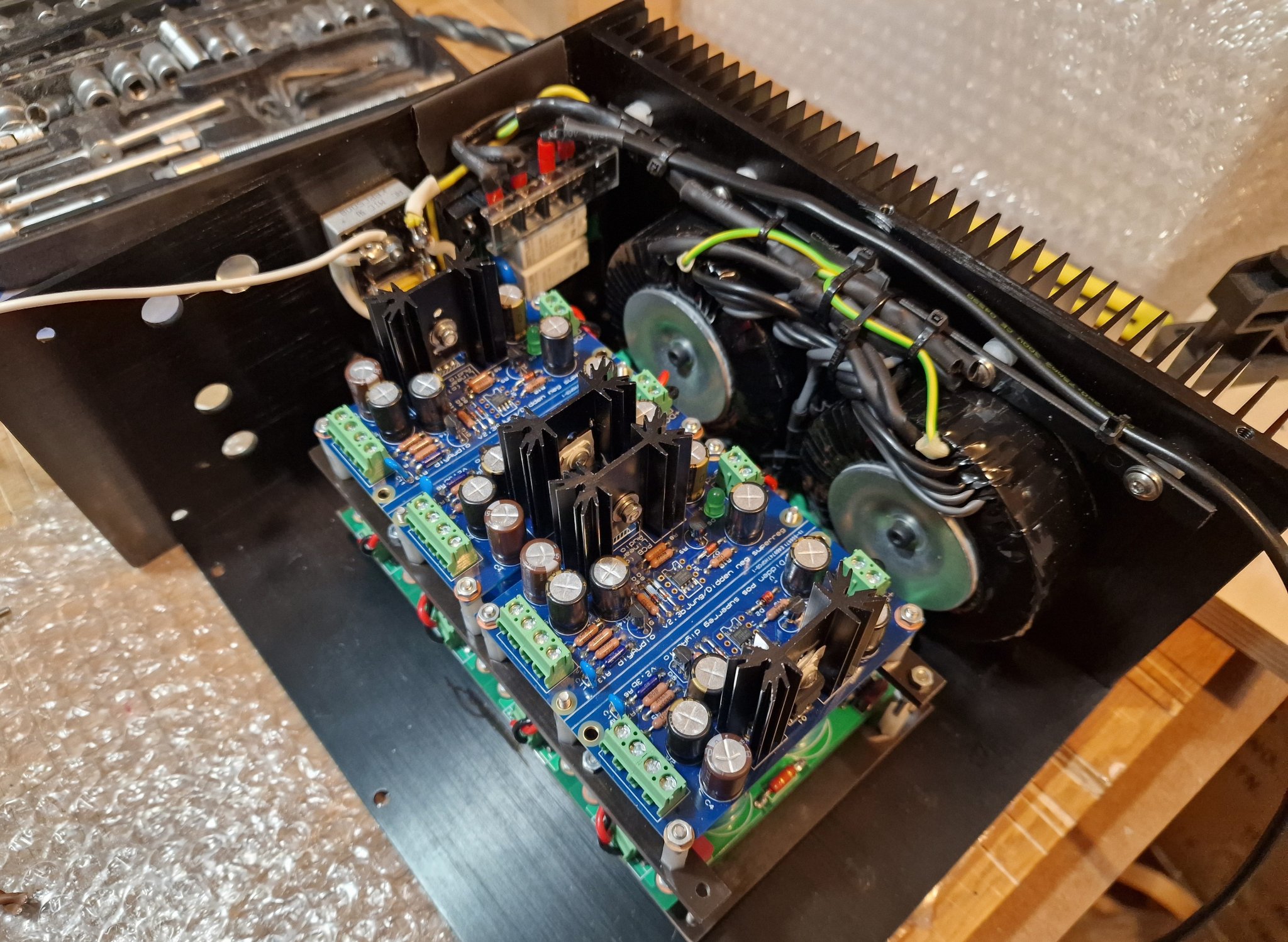

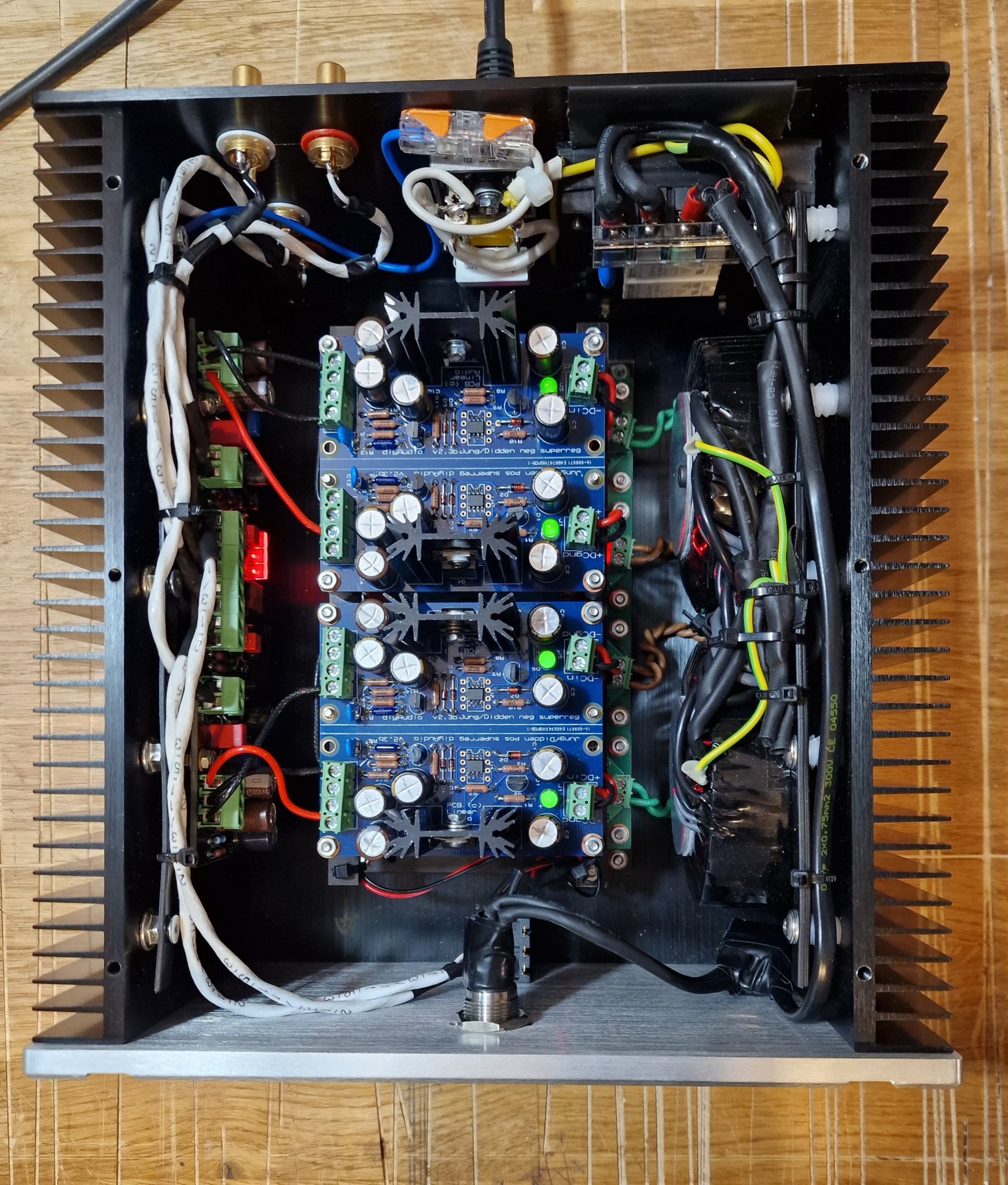

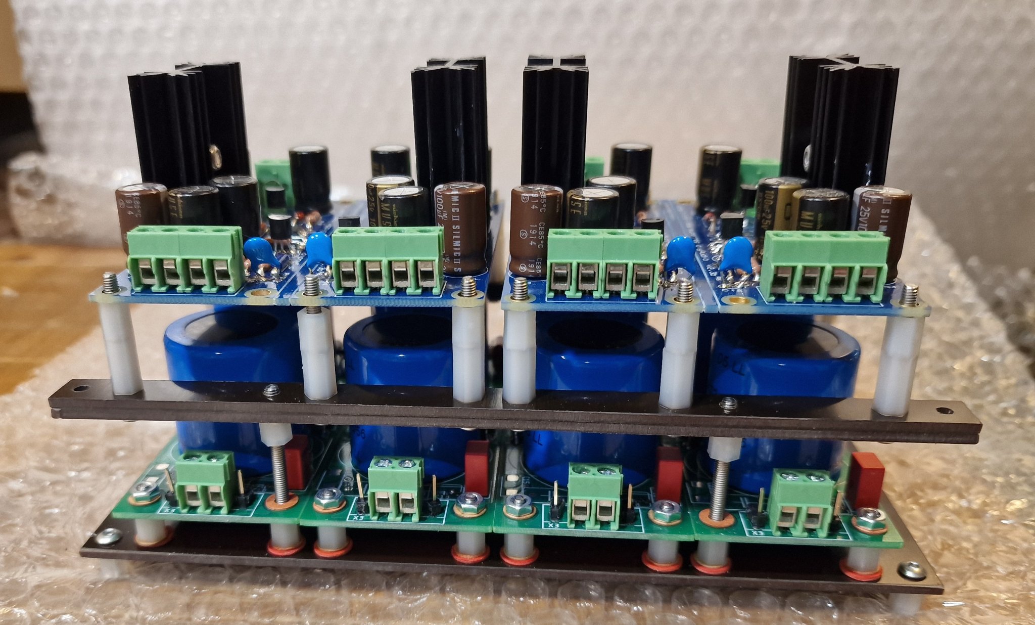

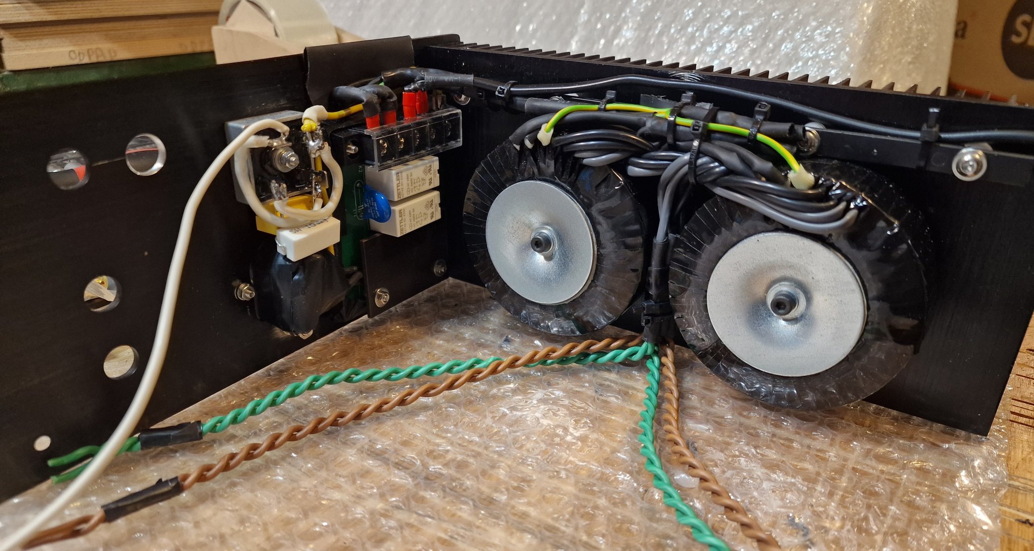

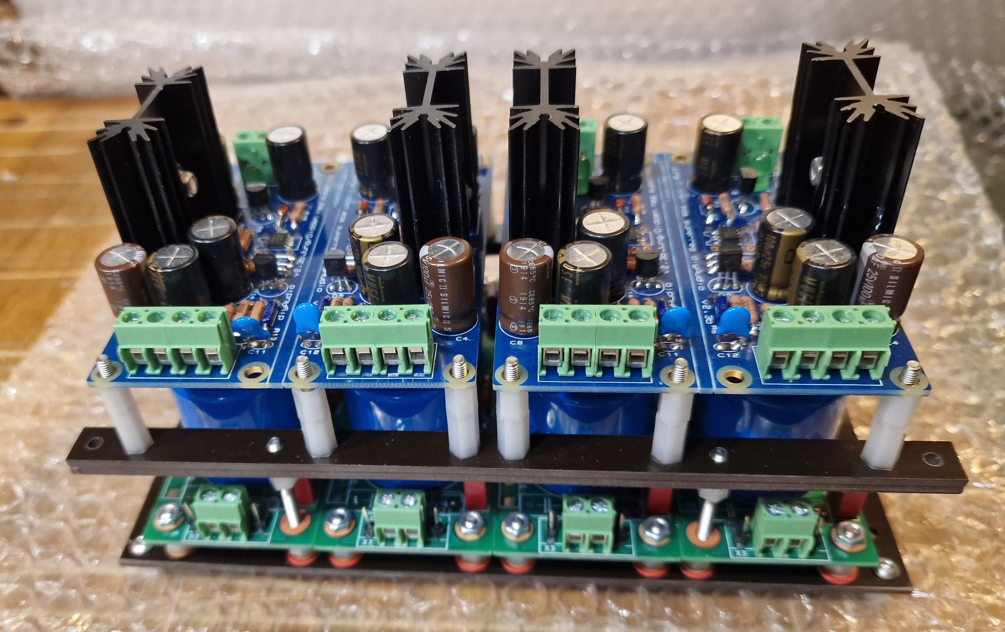

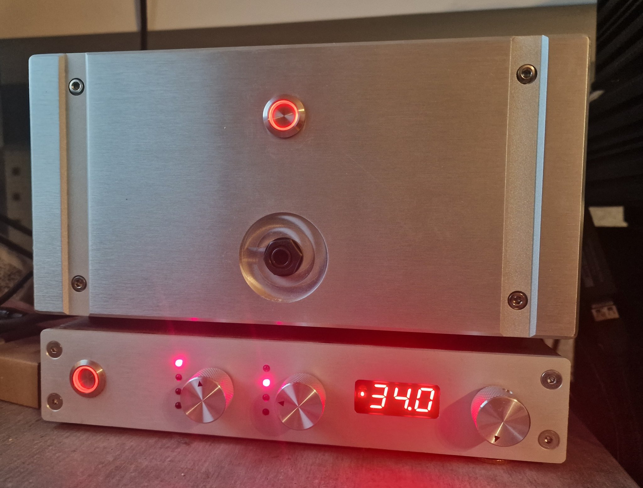

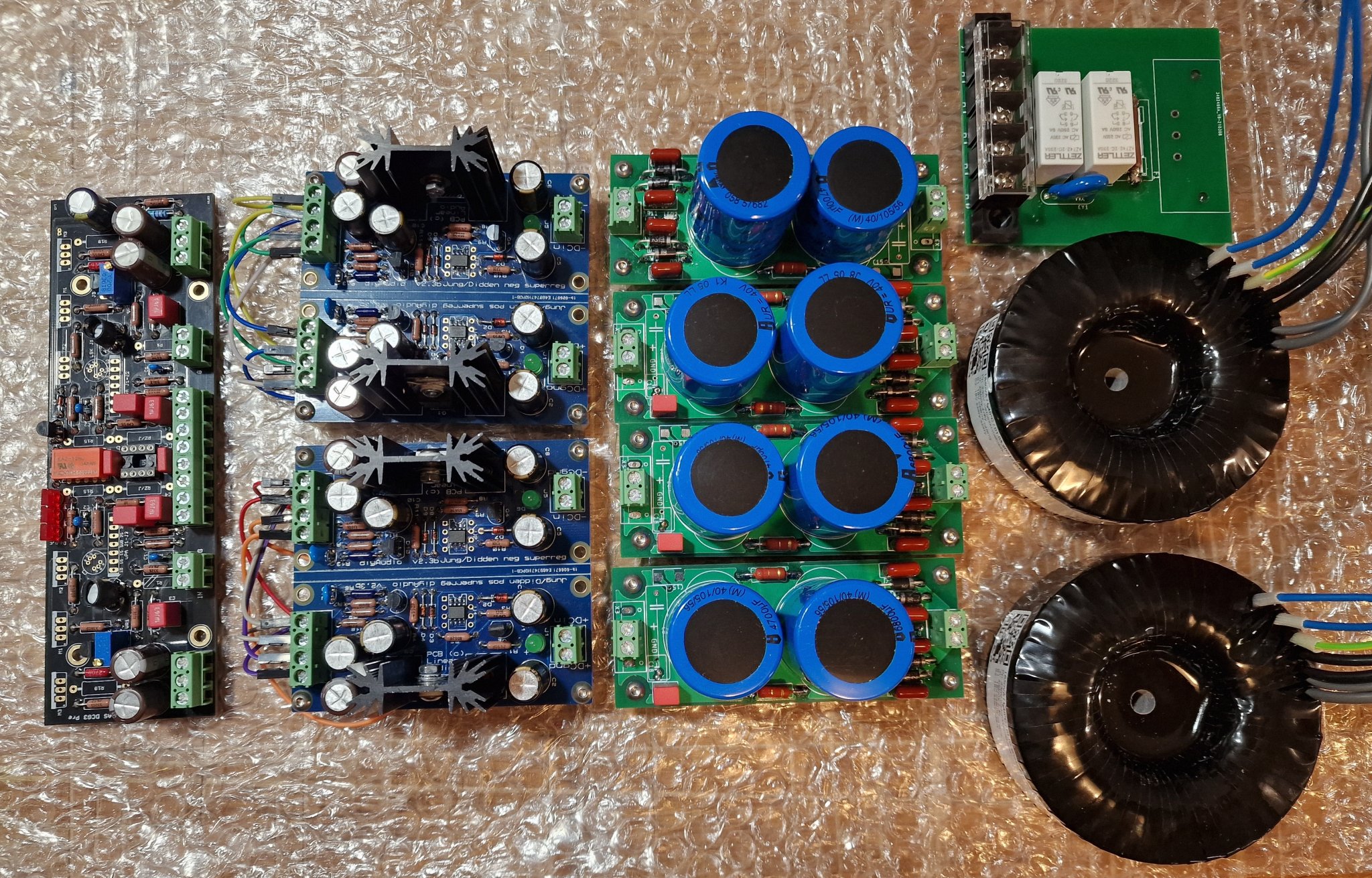

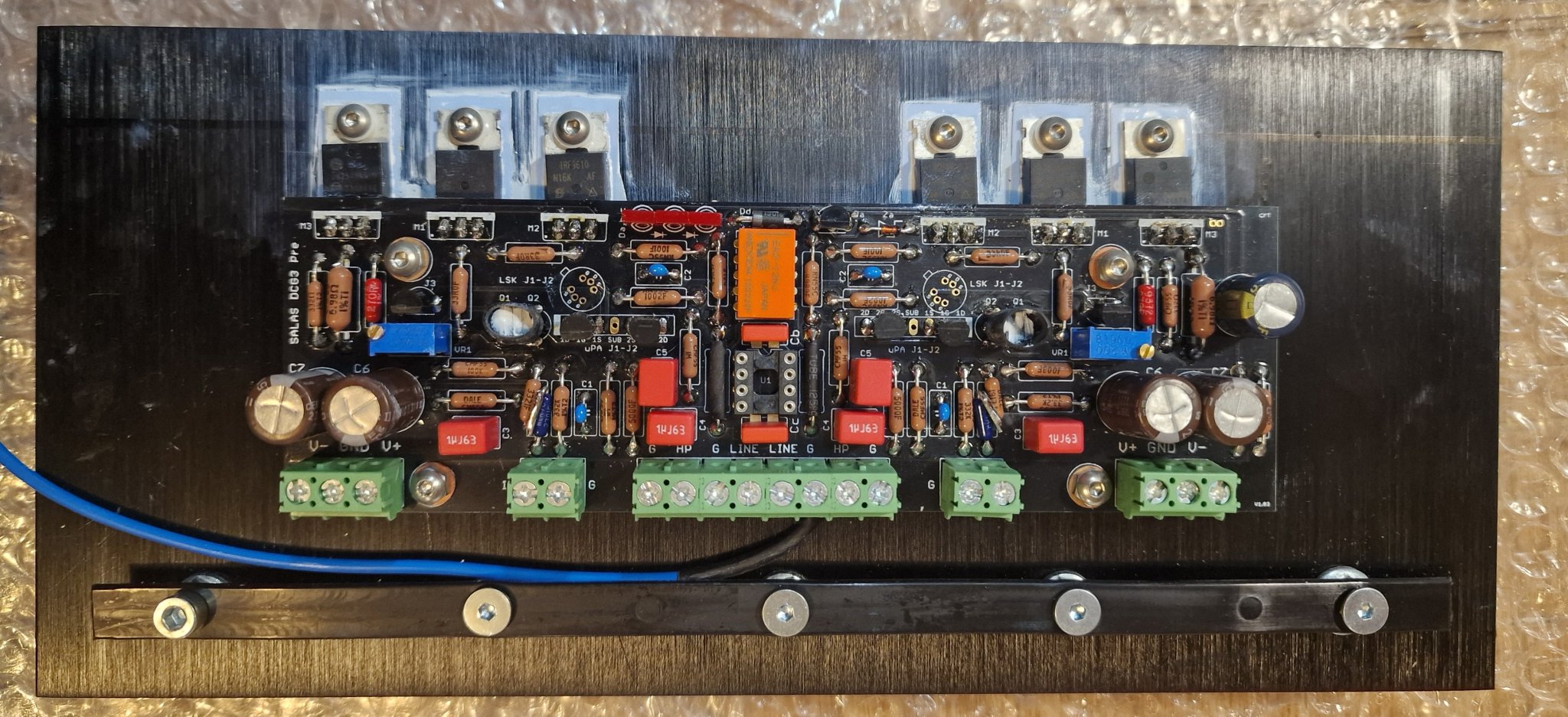

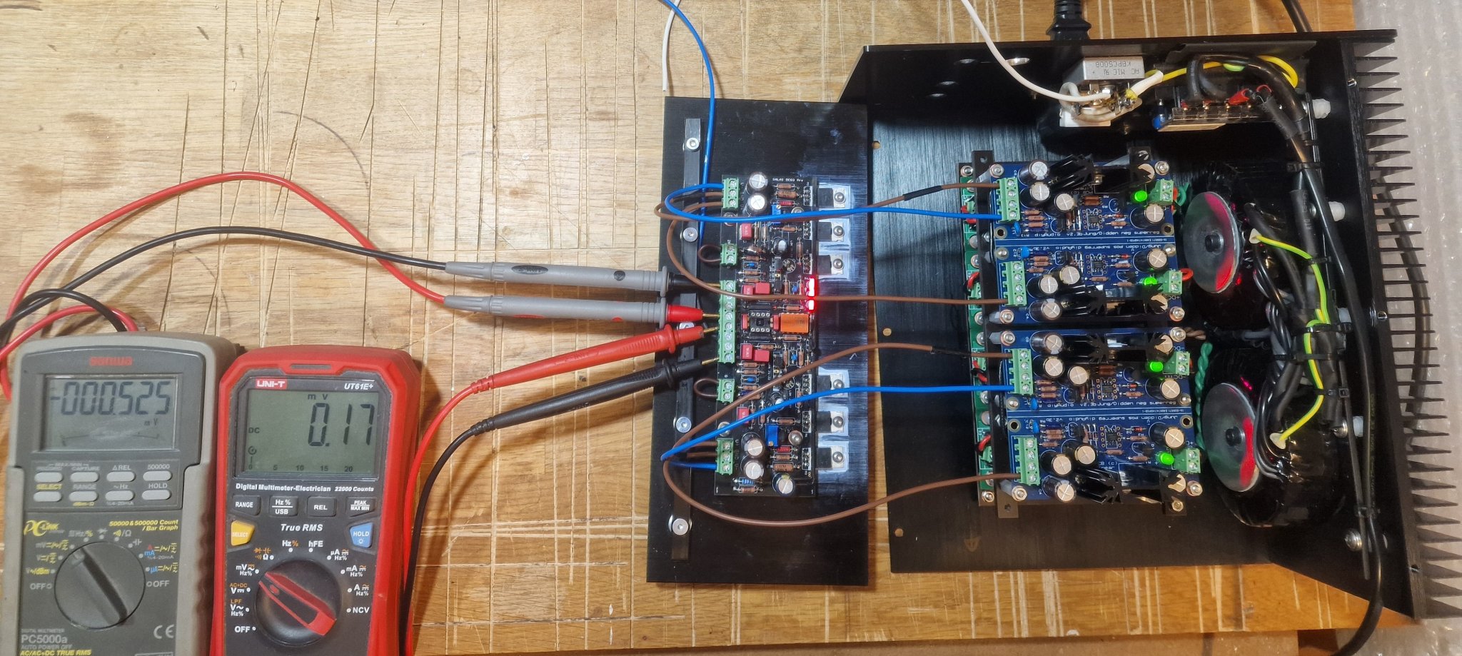

Hi.
Below are pictures of my build.
I used parts from the Tea Bag kit except for the Jfets. I used a matched 2sk170 quad that I bought more than 20 years ago. The bias is set at 150mA.
In the power supply I used two 50VA transformers followed by four bridges along with CRC filters and two sets of Super Regulator.
The whole thing was difficult to fit into the enclosure, which turned out to be smaller than I expected. It's tight, but somehow it worked out.
So far I have confirmed that the circuit works. I will report on my listening impressions later.
Marek.
Marek.

Intricate build in a tight space. Congratulations. Headphones use mainly? Volume setting is external?
Salas,
the output RCAs are below the input RCAs, in place of the speaker terminals of the enclosure that was originally intended for a speaker amplifier. These outputs will be used, although I mainly listen on headphones, as you have guessed.
The volume control is a resistor ladder in a separate enclosure. The ladder has a fixed 2kOhm output impedance. On your advice, I added 3kOhm at the DCG3 input to mimic a 10kOhm potentiometer.
yes, my mistakeNot 10kΩ but 20kΩ pot mimicking is 5k (2k ladder+3k).

Have you tried your newly built DCG3 for listening to music yet?yes, my mistake

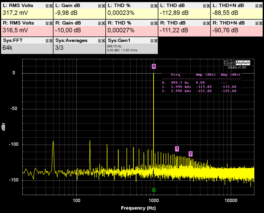

Yes I have.
First I took some measurements that are more or less in line with what can be found in this thread.
I have, unfortunately, a rather high peak at 50Hz (-100dBV while the noise floor sits around -150dBV). Well, this was to be expected from how tight the enclosure is....
However My impression is that it is not audible.
The sound is really good. The DCG3 pairs great with the HIFIMAN Ananada.
The sound is detailed but not intrusive, warm and engaging. It's hard to stop listening. I like it a lot.

Very nice results. Congratulations.
-100dBV 50Hz spike is possibly some low level ground loop due to return wiring. Even because of the magnetic field from transformers and mains in a cramped space. Else it comes from outside. Did your measurements include the external ladder attenuator?

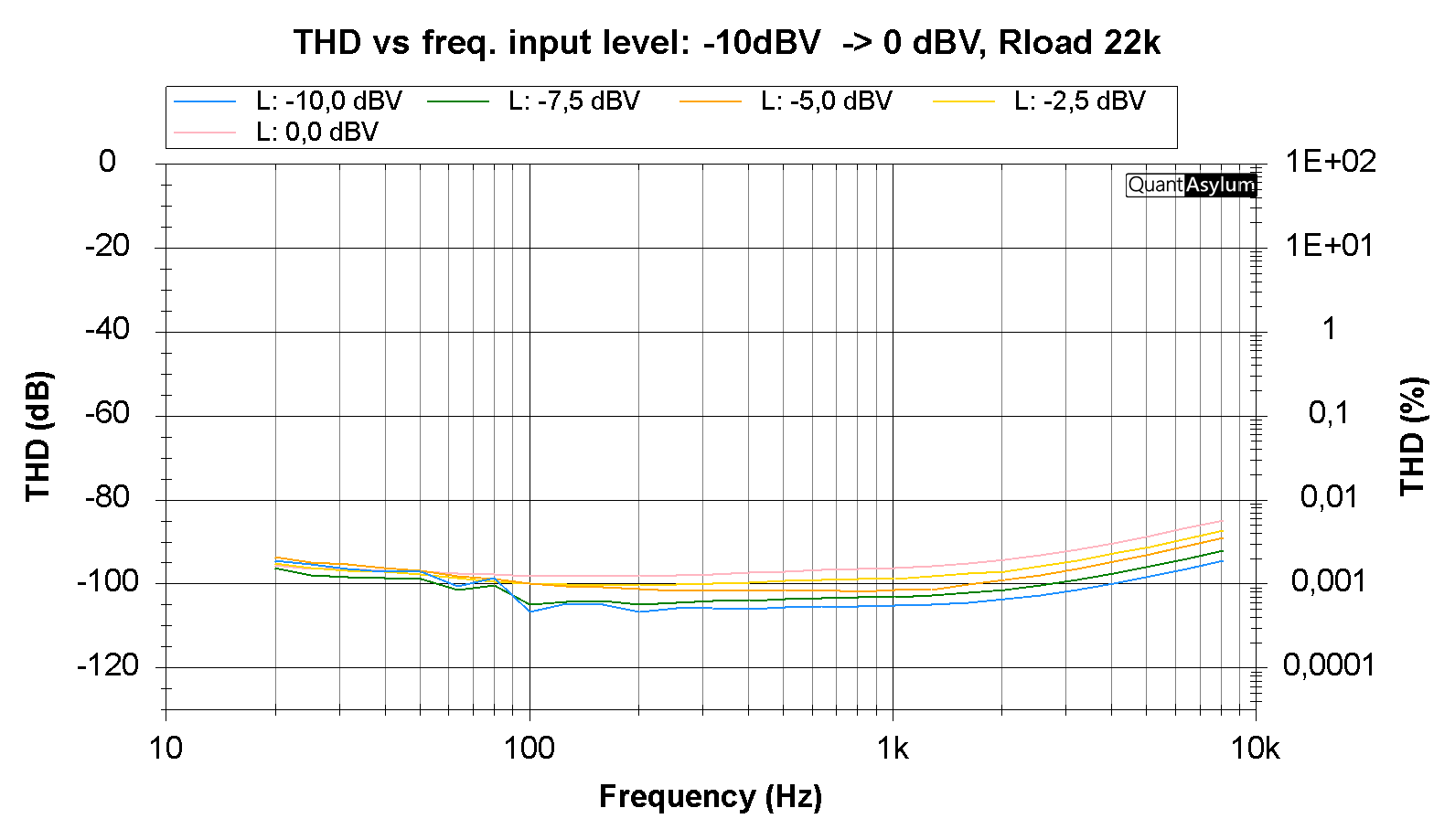

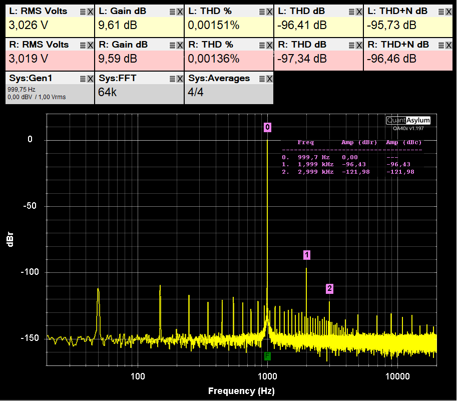

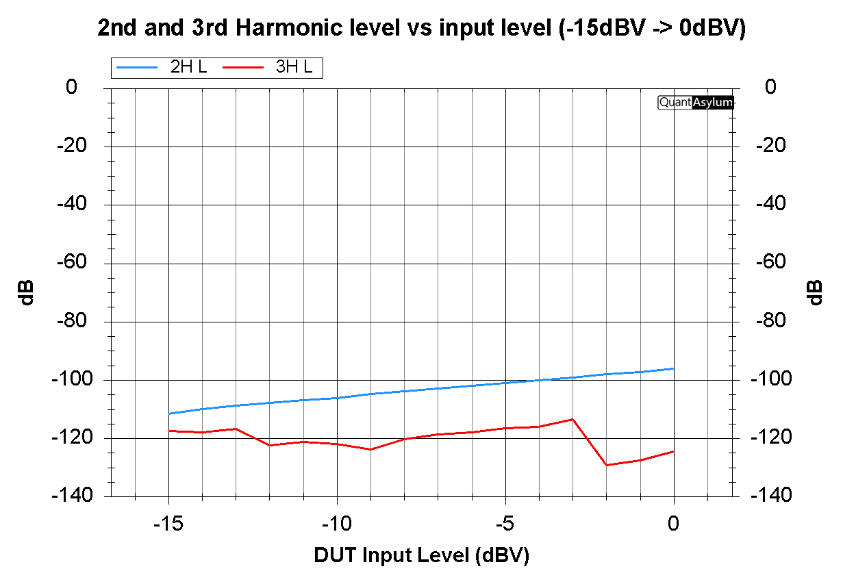

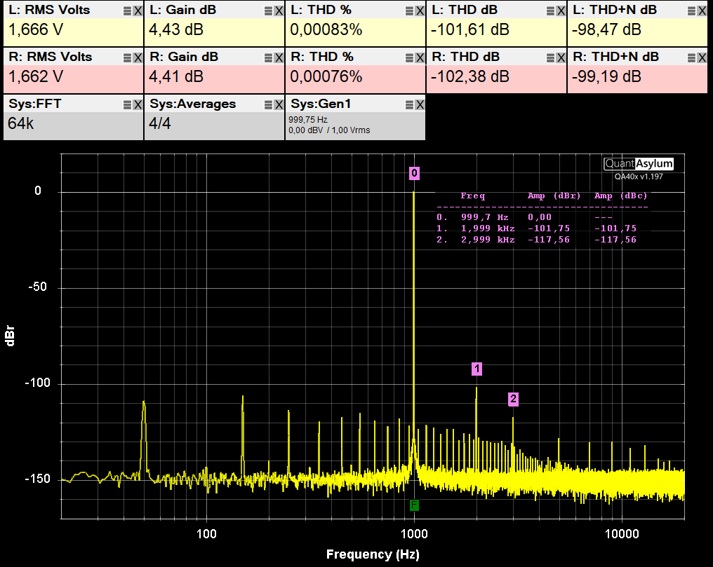

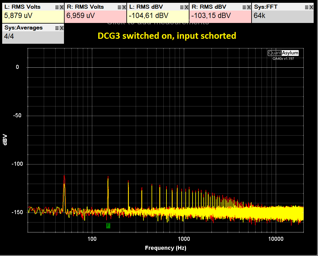

I took some measurements of my DCG3. This time with an attenuator.
For the measurements I set the attenuator to -0dB (even in this setting it has 2kOhm output impedance).
The DCG3 is loaded with a resistance of 22KOhm.
In the pictures are the following measurements:
do these measurements look ok?
- FFT for 1Vrms 1KHz input signal - (THD, THD+N and Gain can be seen....)
- THD vs frequency for different input levels: from -10dBV (316mVrms) to 0dBV (1Vrms).
- 2nd and 3rd harmonic levels for a 1KHz input signal and levels varying from -15dBV (177mVrms) to 0 dBV (1Vrms)
THD looks normal for the test levels used. THD+N looks around 16 effective number of bits. Can reach 18 bits ENOB when testing somewhere between 0.5V to 1V RMS DUT output. Not any or very little harmonic noise helps such figures as well. Is it the same low level harmonic noise picture when without the external ladder attenuator and its connecting cables?

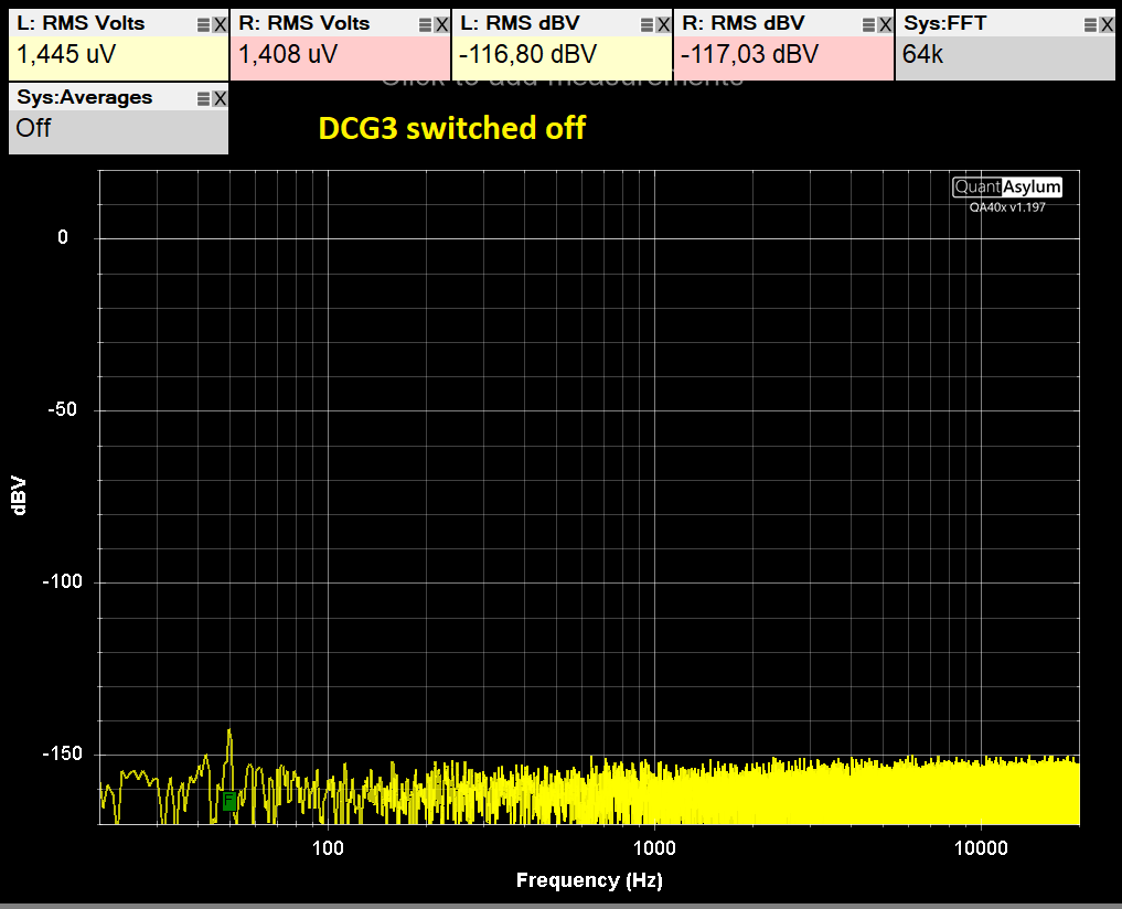

I took measurements with the DCG3 inputs shorted. I am posting measurements for DCG3 switched off and on.Is it the same low level harmonic noise picture when without the external ladder attenuator and its connecting cables?
When switched on, harmonic noise appears, with a fundamental harmonic of 50Hz and subsequent odd harmonics.
Interestingly, the plots look the same before the output relay is switched on (the output is then shorted to ground) and after it is switched on - there is virtually no difference....
How to explain such behavior? I think it is magnetic coupling from transformers that causes this noise....
In addition, I took two measurements with the attenuator. I got the best THD+N (-99dB) for an output voltage of 1.6Vrms and the best THD (-112dB) for an output voltage of 300mVrms. I changed the input level with an attenuator, hence the measured gain values

Your THD results look fine. Regarding the transformers field interference hypothesis, rotate them while running FFT to validate. To see if the harmonic noise residual spikes change. That will be a sign they are involved in the situation. Single turn copper tape around the toroid's periphery had dramatically helped the hum & buzz situation in a shoe box chassis diy power amp once for me. Of course your noise levels are way too low to be directly audible but why not try wipe them out if possible.How to explain such behavior? I think it is magnetic coupling from transformers that causes this noise....
