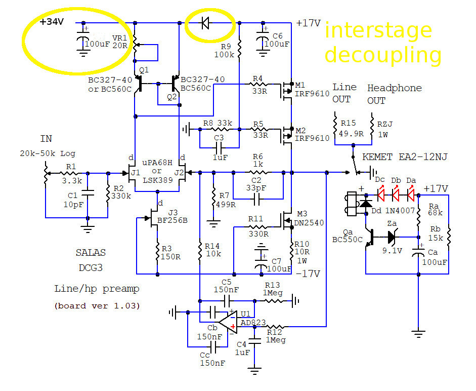

Got my four R-core transfomers and got the quasimodo board finished as well. Waiting for the UBiB and am preparing the HP board meanwhile.

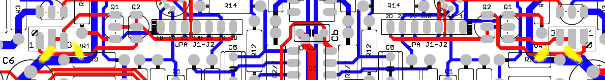

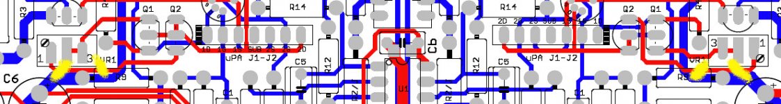

Already did cut the GND for full dual mono ( Salas DCG3 preamp (line & headphone) ) but to find the right spot to cut traces of the current mirror is next to impossible, given the black coating of the board.
Could you please check my close up picture of the layout, where to best cut the traces for both cannels (yellow marks) ?

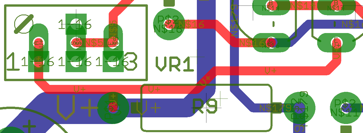

I possibly didn't quite get it, is it indeed at R9 where +V is supplied by a via ?

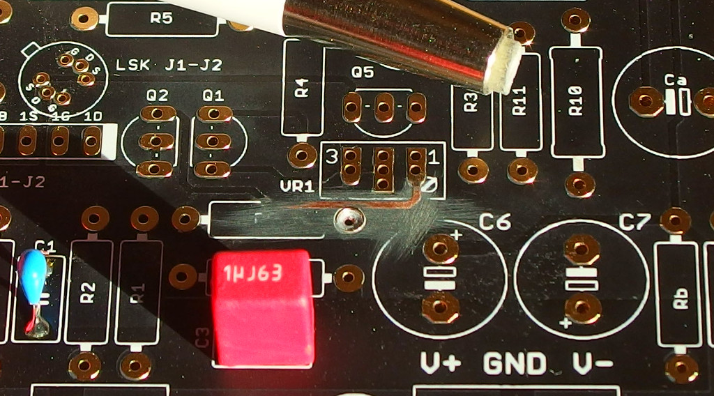

It was easier to break up the positive rail of the stages by breaking the R9 via with kinda funnel, than to cut traces.
Always easy to go back at any time by simple bridging, just in case severe problems may arise.

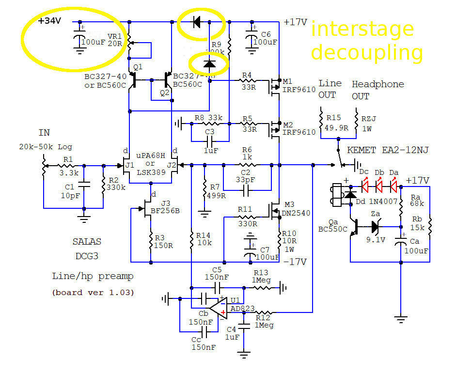

Maybe a second clamp diode will help keeping M1 gate voltage at save levels under any circumstances
1N4148 (4pF) may do the job for both I guess.
Starting with modifications (assuming they will work well on the bench) before having listened to the standard configuration how you will have a base level for subjective comparison on possible differences though? Shouldn't you start the other way around?
Good point.
I'm just laying out the rails and the turnouts right now, because for me its way easier to do those preparations before populating the board.
I guess I will start out with the stock scheme, than proceed towards a simple R/C decoupling (down to 150 ohm / 100uF / 10Hz possibly), than towards a split PS at same voltage and finally towards a split voltage at double + voltage for the first stage.
Should be a nice learning curve, I guess, given the very revealing 4-wire modified AKG K712 I'm really fallen in love with.
Most probably there will be a different approach towards my ideas of a dual mono quasi star point mass as well.
