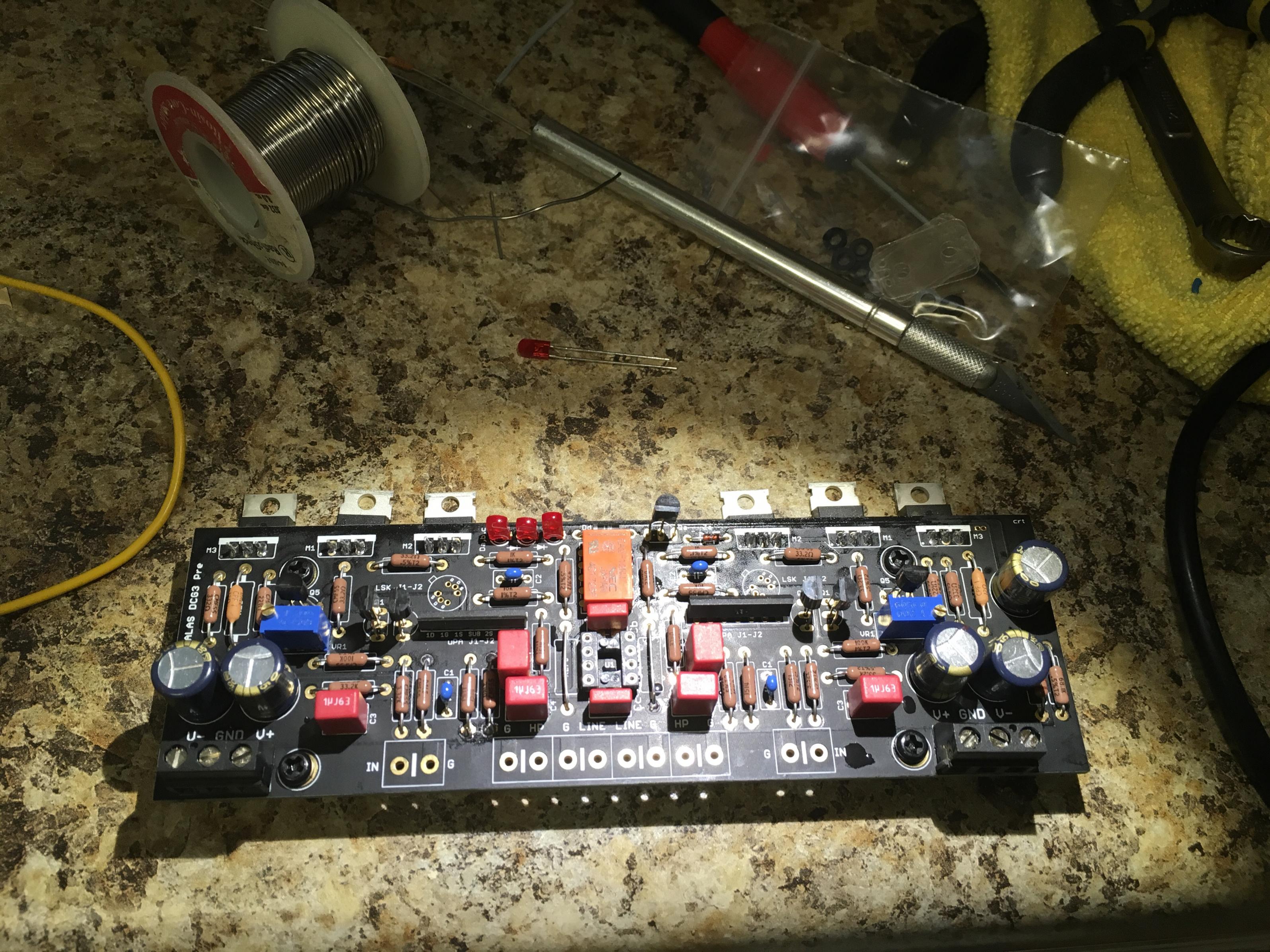

Tea, thanks for the meticulous kit work. I ended up with a spare led. What am I missing? Don’t see it in the schematic nor is there a pad for it.
Greg
Better one extra then one too few. I do my best. 😱
This thing is now ready for testing with my bulb limiter.
Your UltraBiB PSU has a CCS current limiter so it will protect the load (DCG3) from a fault higher to your R1 mA setting anyway. If surpassed it will drop the PSU's output voltage and you will instantly know by the PSU's LEDs turning off. Not only useful in test, but forever, its a built in feature. I put the CCS there primarily for dynamic separation reasons but it works as a CC protection mode too.
The dim bulb tester will sense the 6800uF reservoir capacitor's inrush current and try limit it but once charged it will not react for brightness any further. Because the PSU's current draw will be maintained constant no matter what gross fault may occur after its current limiter. Naturally it won't protect what's located before it i.e. the transformer, the bridge diodes, and the reservoir capacitor.
