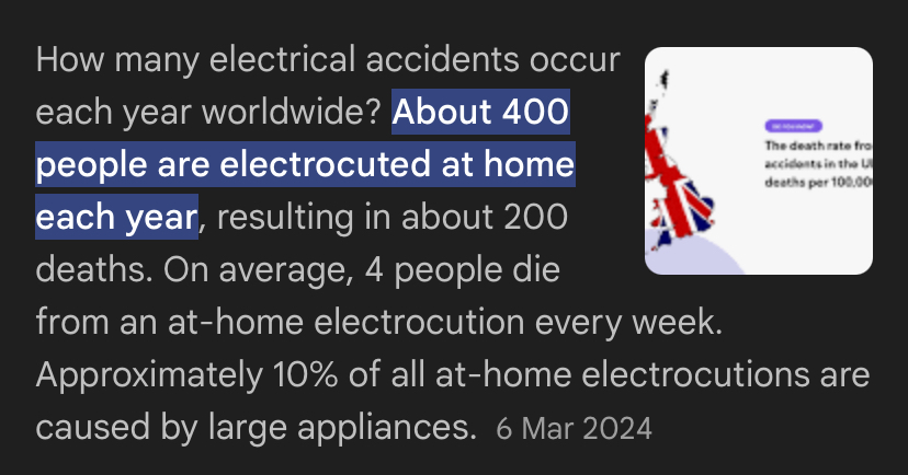

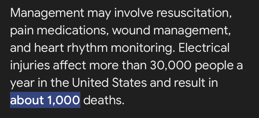

Here are the electrocution death rates.
Seems the death rate per unit population is broadly the same - c.200 per 70 million in the UK and USA (200 vs 1000 deaths).
No doubt the GFI/RCD, stricter codes and better product certifications have brought it down. Basically, don’t mess either mains.
Interestingly, despite the lower mains voltage in the USA, the electrocution rate is not lower. Question is why?

Galu, you could say the same about the UK as well since the 200 odd deaths a year here include industrial as well.
Note that your UK data speaks specifically of people being electrocuted "at home".
Quote: "About 400 people are electrocuted at home each year, resulting in about 200 deaths."
That number discrepancy does not sit well with me since, by the strict British English definition of the word, no one can survive being electrocuted.
Electrocute (in British English): to kill as a result of an electric shock - see Collins English dictionary 2025.
I noticed the "odd" statistics in the earlier post and was wondering if someone else would notice it. The "injured but not killed by electricity" is a usage I first noticed around 20 years ago. DIYaudio has this other thread going on about English, and I wrote about the changes in meaning of electrocution here:
There's also this, a current definition fresh off the InterWeb:
"to kill or severely injure by electric shock" [thought I've heard it used by those only slightly injured]
https://www.merriam-webster.com/dictionary/electrocution
And of course the original definition meaning capital punishment, "to execute (a criminal) by electricity" is now the second definition.
