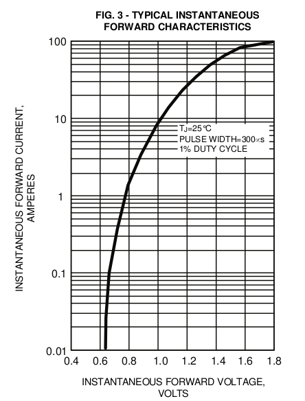

A diode passing tiny current could have Vf~500mV
A diode passing normal current could have Vf~700mV
A diode passing hundreds of amperes of Fault current could have Vf~1500mV.
That's the maximum voltage the little disconnecting network will ever see. But, it won't last very long, 1500mV * 100A ~ 150W instantaneously.
The diodes only conduct in the fault mode, and only must outlast the fuse in the gear it's protecting. The failure mode of a diode in heavy current is shorting, so surely it will melt open well after any reasonable fuse < 10A.

I think that diode would be fine, but the safety police would say the diode should be rated for the same current as your fuse. Since there are 2 diodes back to back under fault conditions or any other conditions the max voltage will be one diode drop.

Personally I wouldn't trust a 1N5404 to hold up adequately.
You want diodes that will reliably trip the mains breaker
before they fail. A 35 amp rectifier bridge with the AC pins
connected together and the +/- pins connected together
would about do it.
I have been told that even that could be a little sketchy...
