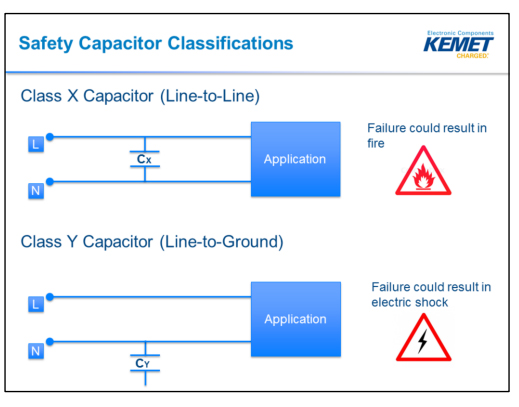

I was getting ready to use some and stumbled on this thread and thought "But they make ones specifically for the task, they must be better and safe now" And then I saw the attached warning on Kemet's site. So clearly there is still danger with them
As I understand it, power conditioners use X and or Y type caps to filter noise out of the 60Hz source and use a MOV for surge protection. Is that the same thing we are talking about in this thread or is that something different? I also noticed that it seems to stiffen the AC voltage. The Furman line conditioner in my guitar amp rack is simply this.
Stiffen the AC voltage with a 0.1 uF capacitor? It does not stiffen the AC line voltage.
Neither does an MOV, it goes low Z only when the voltage exceeds the Mains Power normal voltage (like a high voltage transient).
The safest amp has none of these so called "safety capacitors" They do
no good when there and might cause harm. Why then install them ?

They're called "safety" X and Y capacitors since a safety agency has evaluated and approved their usage. When capacitors must be used on the AC line for suppression of radio frequency interference, they are they are the only types that will be approved by a safety agency.
When a 3-wire cord is used, there is likely no need for X or Y capacitors (though an X-capacitor might reduce the pop at turn-off). With a 2-wire cord, a Y-capacitor on the neutral may reduce hum caused by coupling through the transformer primary-to-secondary capacitance. It may increase hum if plug is reversed. In this case there will also be ground leakage current (YOU may be the ground conductor) which depends on the capacitor value. Safety agencies limit this to 0.7 mA or less, considered imperceptible in most cases. (1 mA is considered the "startle" threshold, not dangerous but could cause you to jump or drop something) A capacitor of .015 uF or less will meet this limit at 120VAC. Switching power supplies generally need Y-capacitors on both sides of the AC line, so the chassis may be "hot" at half line voltage with either plug polarity, but must meet a leakage current limit. If a 3-wire cord is used, the limit may be relaxed in some cases, since the ground leakage isn't a hazard unless the ground fails.

I'm not asking about safety caps in general or the importance of having your house wired correctly.
My question only involves the specific situation I mentioned.
"A 3 wire outlet in which safety ground is not actually connected and the hot and neutral lines are switched (ie what should be hot is actually neutral and vice versa)."
So, in your opinion, in the specific situation I mentioned, no Y2 cap would be safer than having a Y2 on the neutral? Please explain why.
In this specific case you do not know if your "safety cap" will connect to
live or neutral. If it connects to neutral there is no hazard with or without
the so called "safety cap". But if it connects to live then a broken cap will
get voltage on the chassies a non existing cap is of no harm.
Thus the cap may be harmless but may also be dangerous . Of course
the cap must be broken to be dangerous but will you bet your life on
the cap's quality ?
