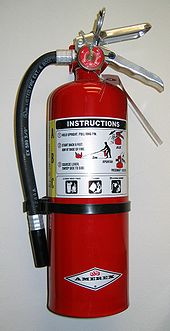

i have a fire extinguisher, i hope it doesnt come to that though lol
