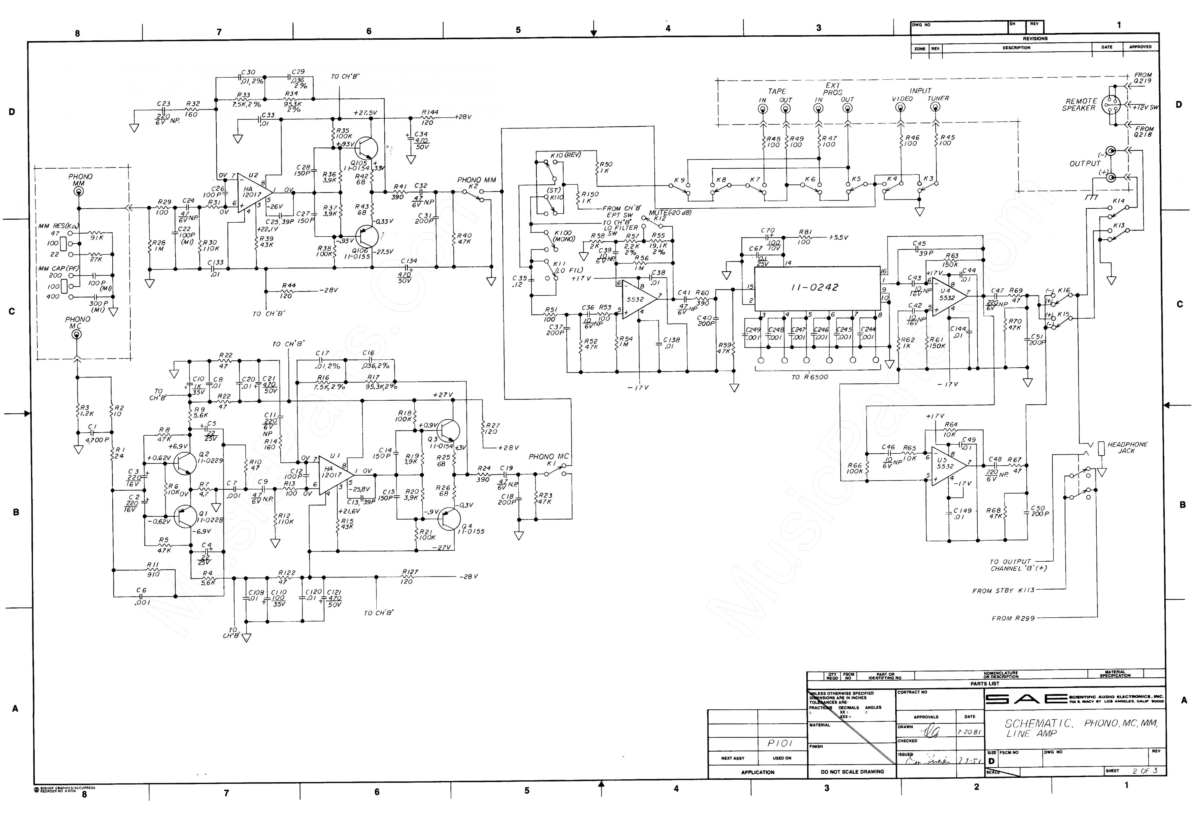

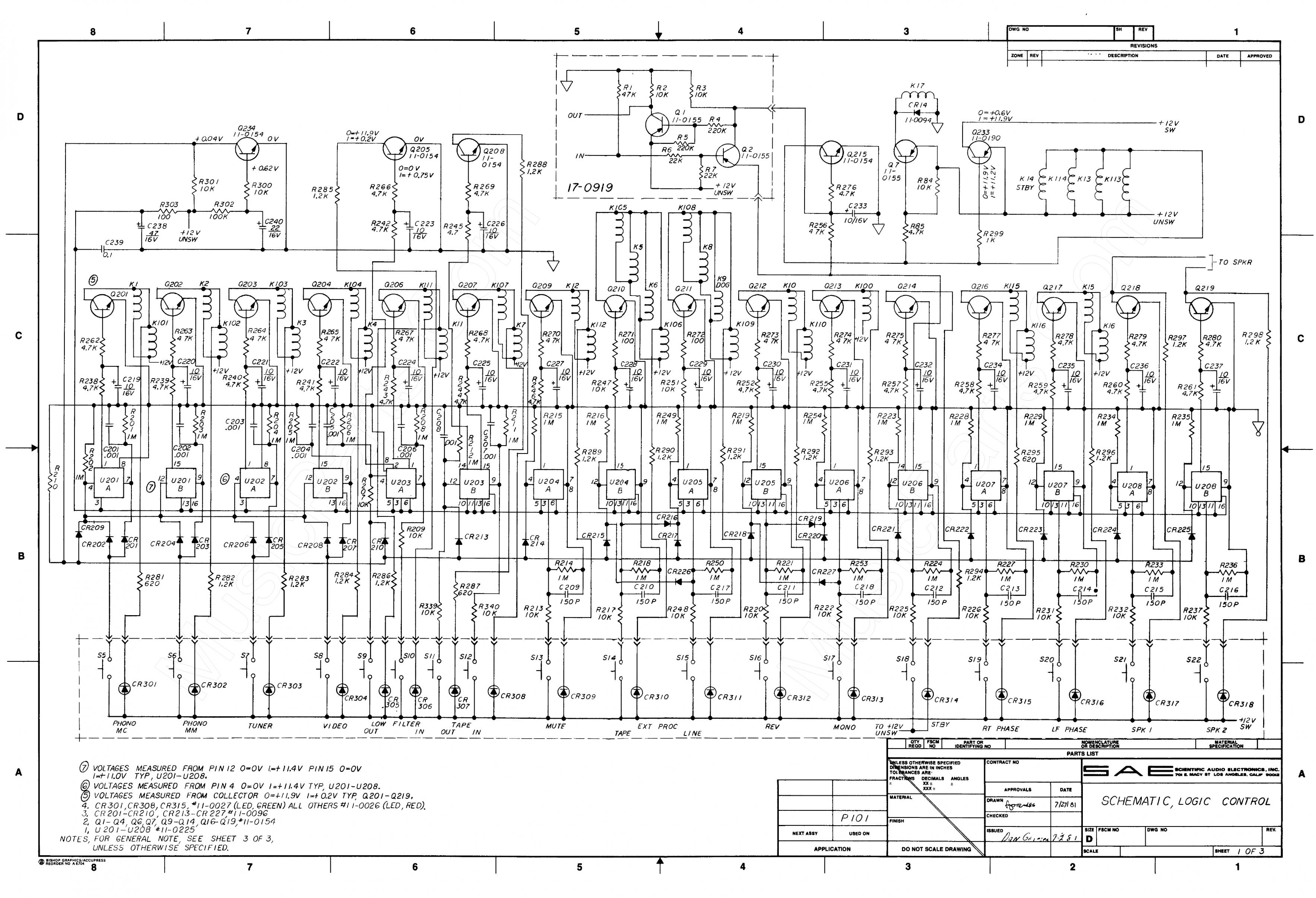

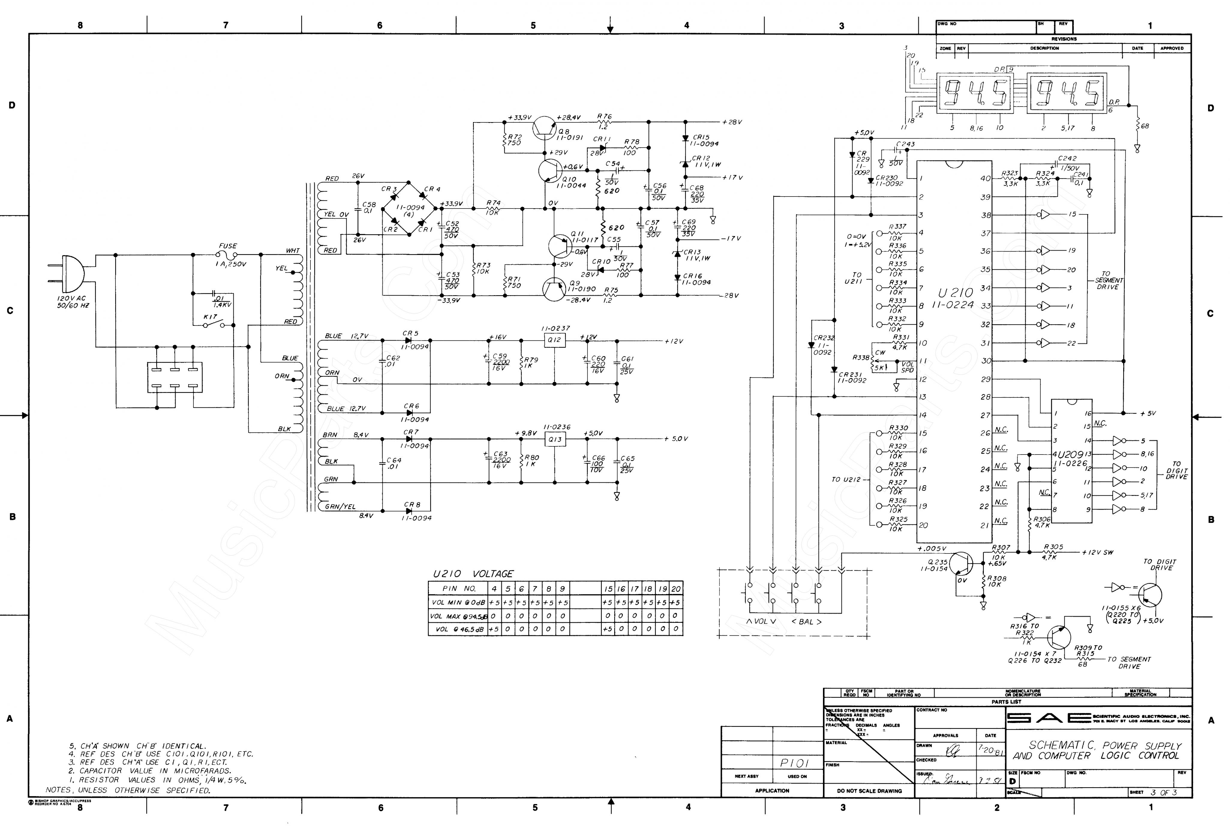

Thanks! I actually have all the schematics and the service manual, believe it or not. All attached here.
But from the sound of your replies, I'm starting to worry that this might be beyond my skills...doing a full diagnostic on it is probably something I'm not capable of.
I did check all the inputs - nothing.
OK! Then let's start by checking out the power supply. Assuming you haven't started to pull those parts off the board yet.....
With the unit powered up, measure the voltages at the following:
Q12 right side terminal (also C60 positive terminal) should be +12 volts.
Q13 right side terminal (also C66 positive terminal) should be +5 volts
Either end of R76 should be about +28 volts. One end should be about 0.4 volts more/less than the other.
Positive end of C68 should be +17 volts.
Either end of R75 should be about -28 volts. One end should be about 0.4 volts more/less than the other.
negative end of C69 should be -17 volts.
Let's start with those measurements.
I just completed a re-cap on two(2) P101. The likely cuprit are these relays. Start taping the tops of them. If the are the ultra-sonic cleanable type relays. Remove the tops and spray contact cleaner. Use MG Chemical SUPER HFE (Cat.No. 4120-450G). This specific cleaner will allow you the spray live circuit, while listening to main output. See special note on page 13 of service manual.
