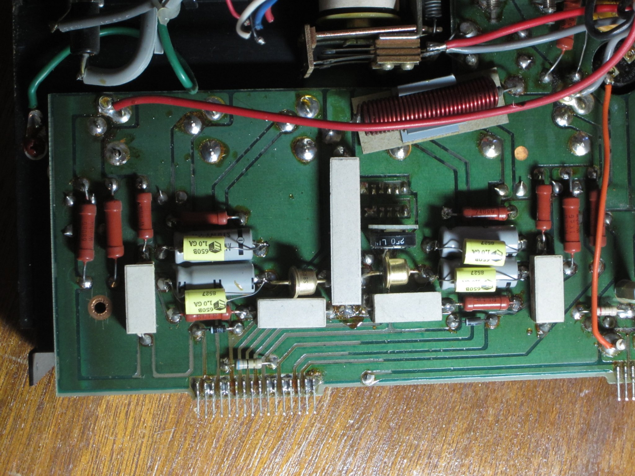

That's a photo I took before I re-capped the output board. The previous owner added the film caps. He did some other much-funkier stuff I had to un-do before I could gain access to the backside of the driver and output boards.

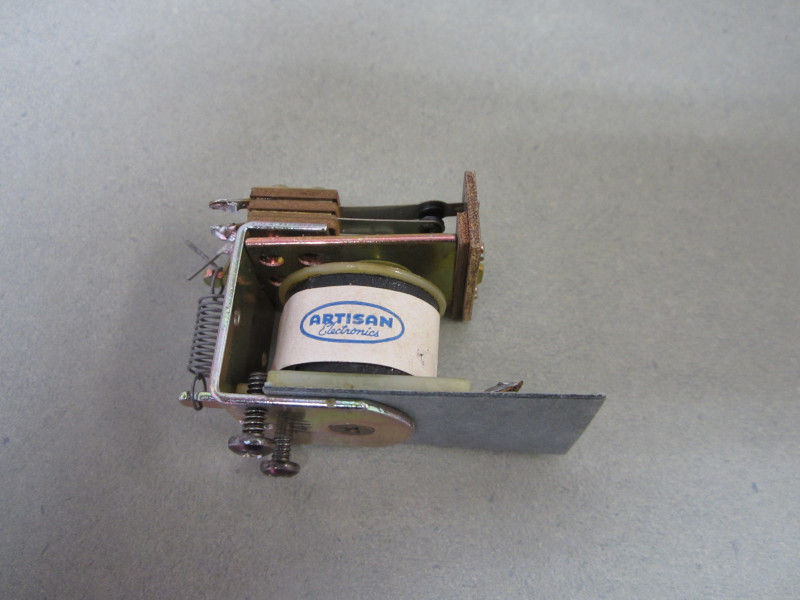

Here's a better photo of that old relay:
The relay was wired using solder joints, not spade connectors. My mistake there. It attaches to the chassis with two 6-32 screws, shown above.
There's enough space in that location to accommodate the Omron relay I bought to replace the old one. While I was in the process of removing the old relay I found a cold solder joint on one of the coil connections. That could have exacerbated the contact problem.....but the relay contacts do look pretty corroded. I tried burnishing the relay contacts when I re-capped the board but clearly that wasn't too successful.
Now I need to make a mount for the new relay. I have a benchtop milling machine so it won't be too difficult to make it. I'll fabricate an aluminum plate with two holes drilled/tapped for 6-32, and glue the relay to the plate. A socket for this relay costs almost $4 and would require some mounting antics as well so I don't think a socket actually would buy me much.
