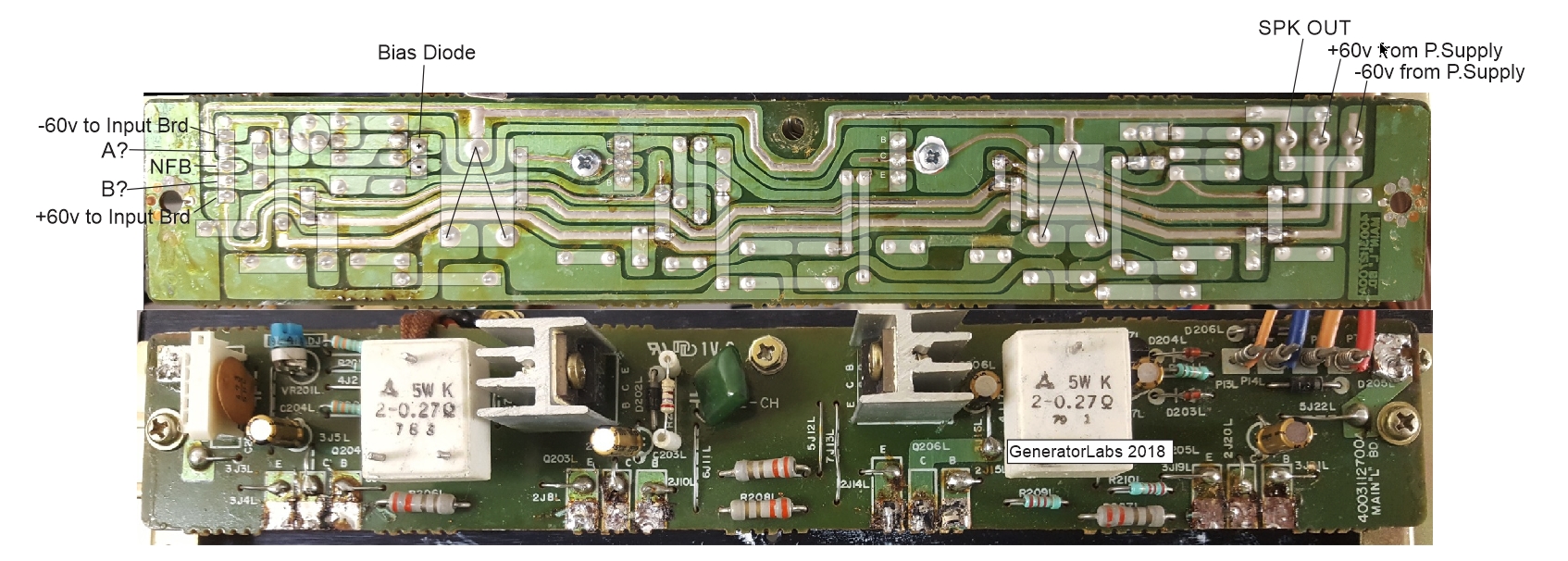

I am working on a SAE 202.
The heat sinks are ice cold and I am stuck. I cannot get the unit to bias correctly.
I had to remove the output transistors on one channel due to a stupid mishap.
I know what I did. It was dumb and I can correct it. Just putting that out there and this may tie into my main problem.
I was probing the input board and saw voltages that feed the bias pot all over the place. By coincidence I blew on a 2sk333 differential amp and I saw the voltages by the bias pot fly all over the place. I repeated it with a drinking straw and if I puffed the slightest amount of air across that device it would create some incredible voltage swings. I was not blowing any air near the bias diode on the heat sink. It was very directed air. I never saw anything like this happen before! And it was almost instantaneous. It only took a puff of air to make it go crazy.
I replaced both 2sk333's and now I don't have the crazy voltage swing BUT I do have very high voltages at the base of the driver and the base pads for the output transistors. The voltage is just about near rail voltage.
What type of voltages should I be seeing at the bases of the driver and output base pads? There is a NegFBack line feeding back to the input board. Could the absence of the output transistors be causing the bias voltages to go so high?
I am lost and need some help. I really don't want to reinstall the output transistors only to watch them vaporize from an insane bias voltage. Any help is greatly appreciated.
I don't have schematics for the amp but I did create the following to help me trace signal paths. I did invert the top portion so the traces match component placement. It seems easier for me this way. PS. I do plan on cleaning up those crusty pads 🙂

I think you should have approx. 2.4VDC between the bases of the drivers, that would put the bases of the outputs at approx. .6VDC, just turned on.

Thank you for the offer Craig. I also have a good copy of the 502 schematics. While the 502 and 202 are from the same family and share a few component similarities, the board layouts are quite different. The 502 has some more advanced auto biasing and no bias pot. The 202 has manual biasing with a bias pot.
2.4 volts on the base with respect to ground, correct?
Thanks!
2.4VDC base to base.

I realized I left this thread sort of hanging with no conclusion.
So here is the condensed version.
I really wanted to understand what was going on with this amp, not just fix it.
So I painstakingly reverse traced the entire amplifier assembly and created a working virtual model of it in SpiceLT. This included both the input board and amplifier boards.
I never used circuit simulation software before so there was a learning curve there. I got the main gist of it learned over a weekend.
As a reminder there are no known A202 specific schematics available. There are schematics for the larger A502 which does biasing temp compensation differently.
Now I have the entire schematic drawn by my own hands. With that in hand I could compare virtual voltages to the real voltages on the physical unit.
The root cause of the problem was a resistor that had wandered way out of spec. I had to pull that resistor out of the circuit to discover that.

In the early models of A202, all three of R201,202,203 are 100 ohm. With bias adj pot(VR201) of good condition(470 ohm VR) I could get around 15-20mV bias voltages across R213 and slightly warmed up heat sinks. The later models of A202 has R201 of 4.7 ohm, R202&203 of 3.3 ohm. The value of VR is the same 470 ohm. It's heat sinks remained literally ice cold and bias could not be adjusted. I think VR of 470 ohms with 3-4 ohm R201-203 is faulty combination. After I replaced all three of R201,202,203
to 100 ohm, I could get good results as in older A202, proper values of bias voltages, slightly warmed up heat sinks and good sounds.
