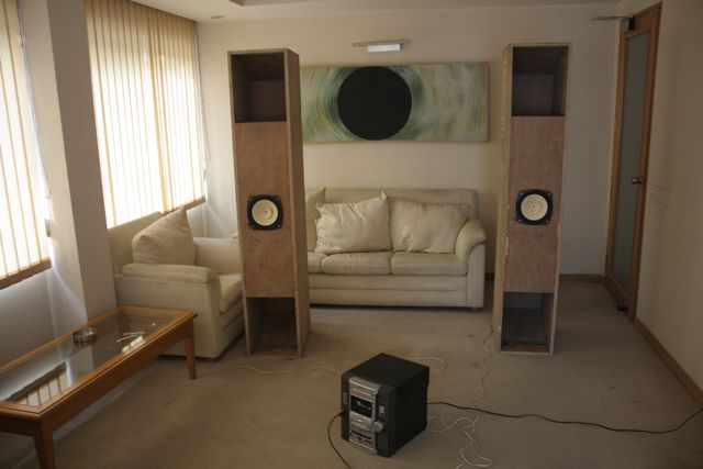

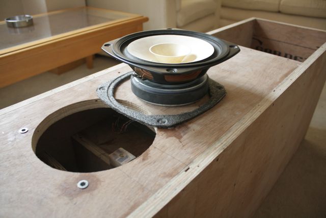

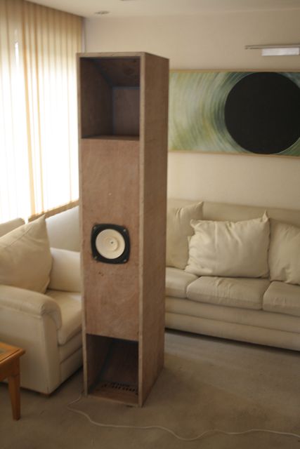

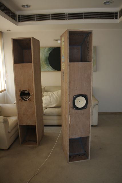

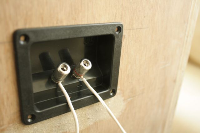

Finally managed to finish up my build today.
all glued up and set but no finish yet and so i didn't solder the drivers and the binding posts. wanted to listen to them though so just twisted the wire (single wire of cat6) around the driver and binding post terminals. terrible, i know, but i figured the sound would only improve once i had everything soldered together nicely. the amplification was whatever i could get my hands on, a cd/fm/tape player combo amplifier (again, it can only get better right?). speaker cable was 18ga. lamp wire (zip cord)

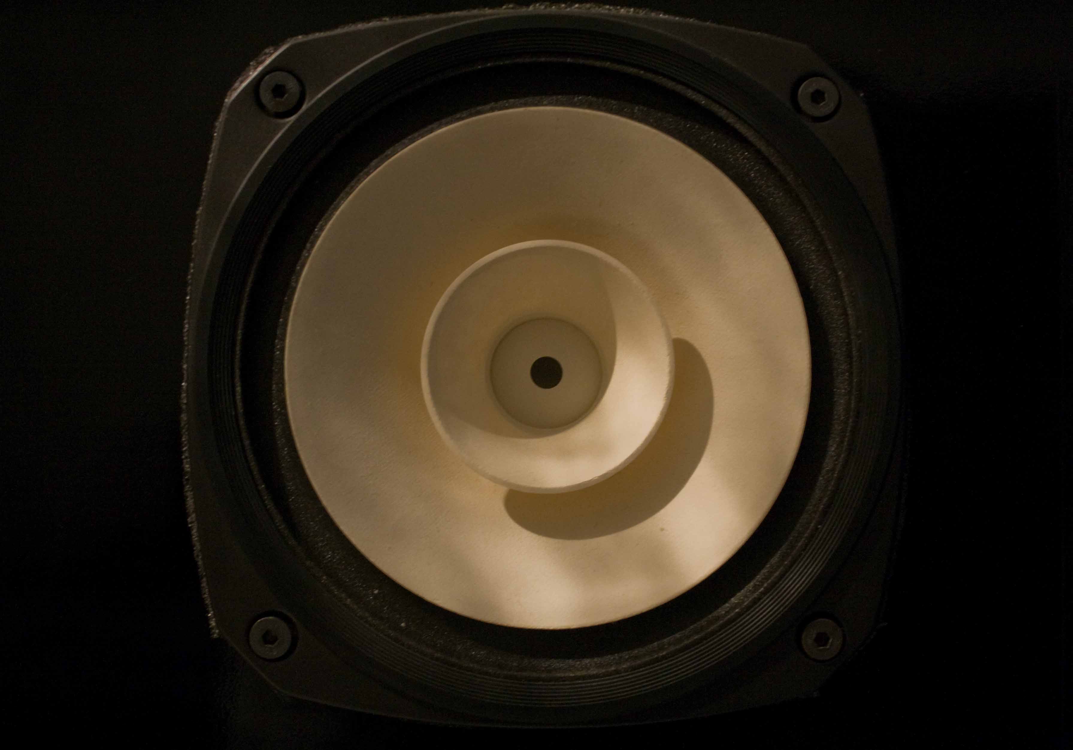

initial impressions were extremely positive, very clear and transparent. they image beautifully and disappear once you press play. i haven't damped the internal chamber yet, have some felt on hand but wanted to listen without it first. i did detect a little bit of shoutiness though,..a slight roughness in the upper mids. i think the solution to this is phase plugs...would lining the back chamber with felt help this?
what surprised me was that they handled rock and electronica without skipping a beat. what struck me was that the speakers were very rhythmic and had great timing. they sounded better as i moved further away, and i fear that i might lose out because my room will force me to be close-ish to them.
a big thanks to the designers..and to everyone for all the help... i think i might build another one for the living room!.

Congratulations! And don´t worry - the "shoutiness" will lessen when the drivers are broken in. This might take quite a few hours of enjoying music - what horrible fate.
Electronics, cable, solder, and damping will all make for improvements, but they will still need some running in, 100 hrs gets you thru the worst of it.

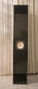

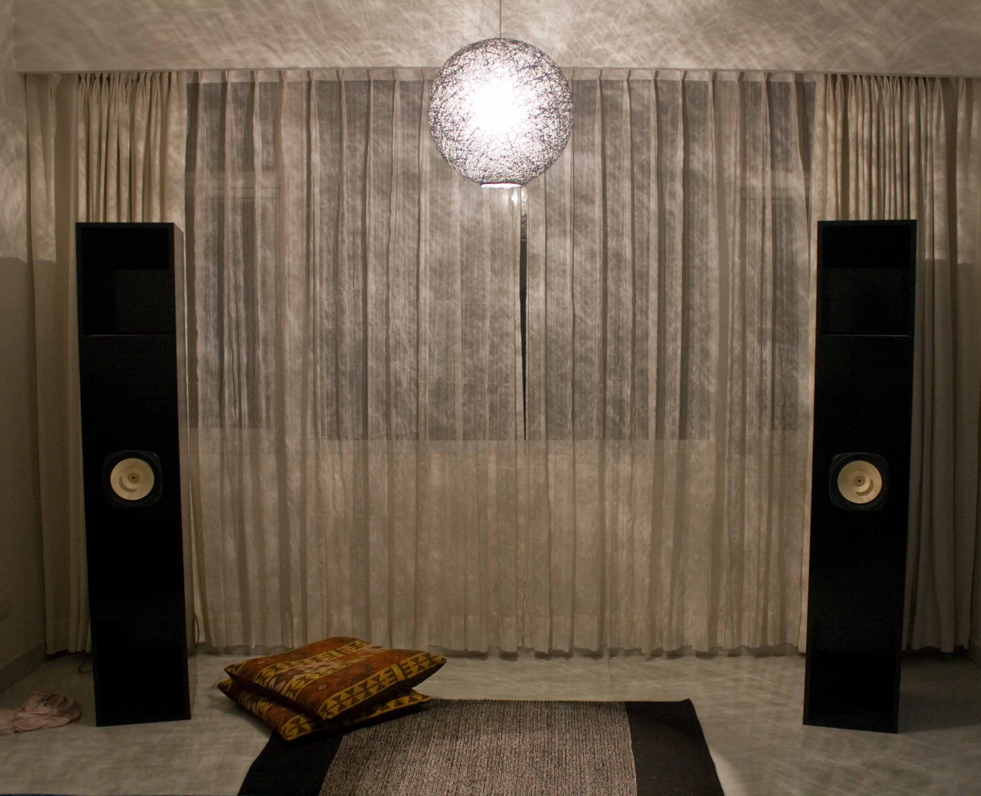

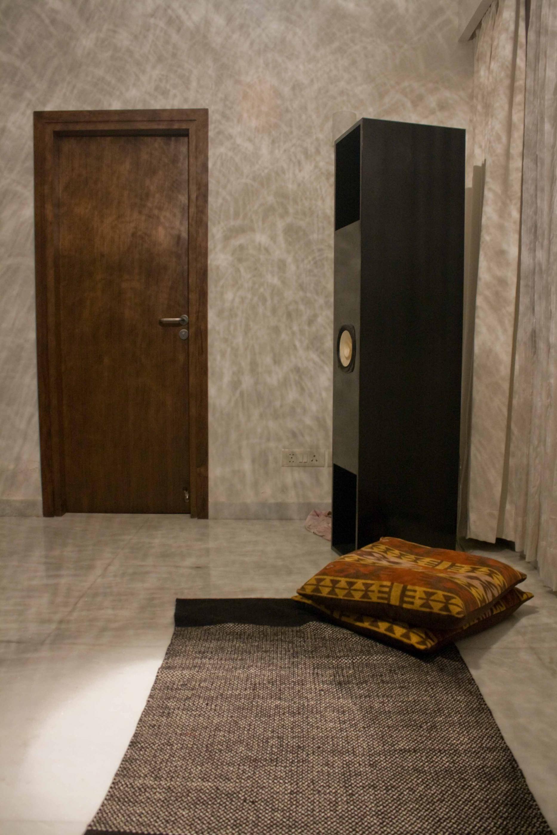

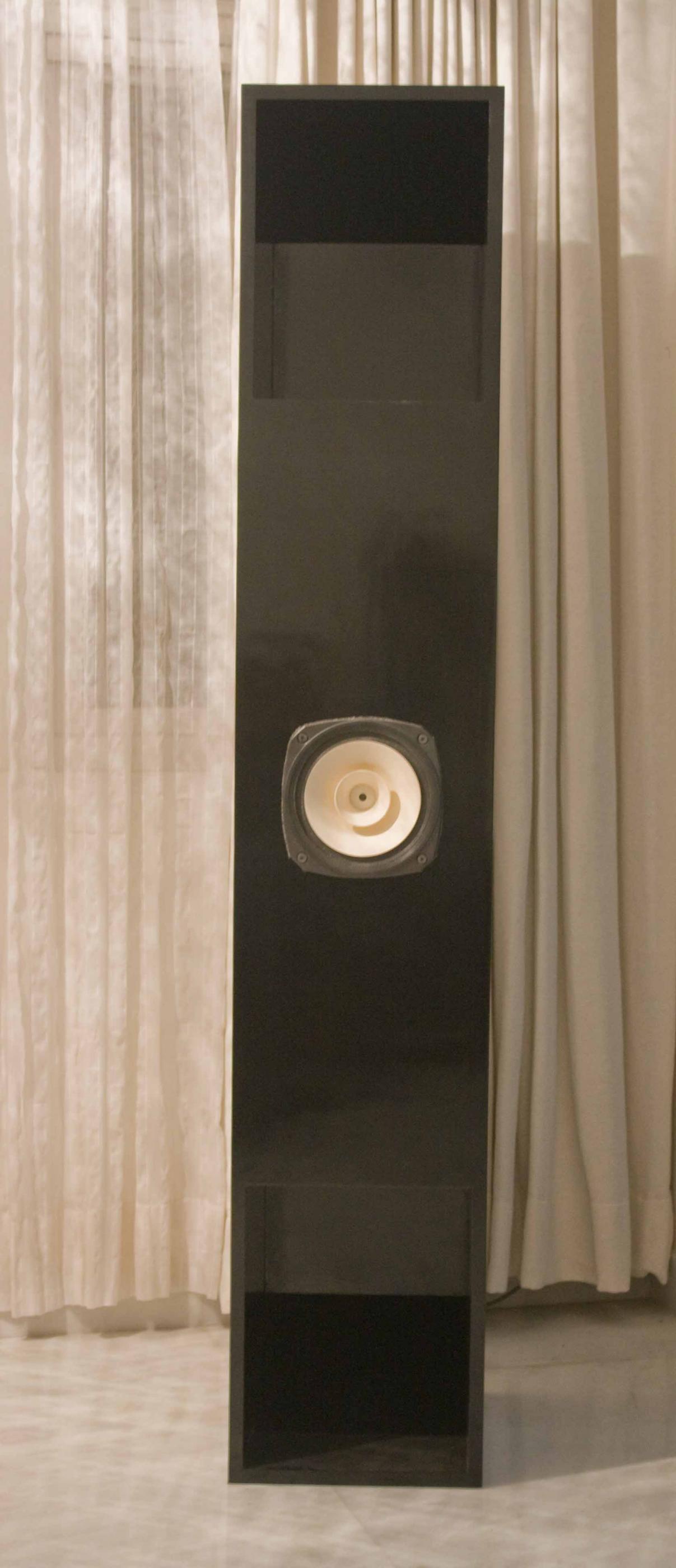

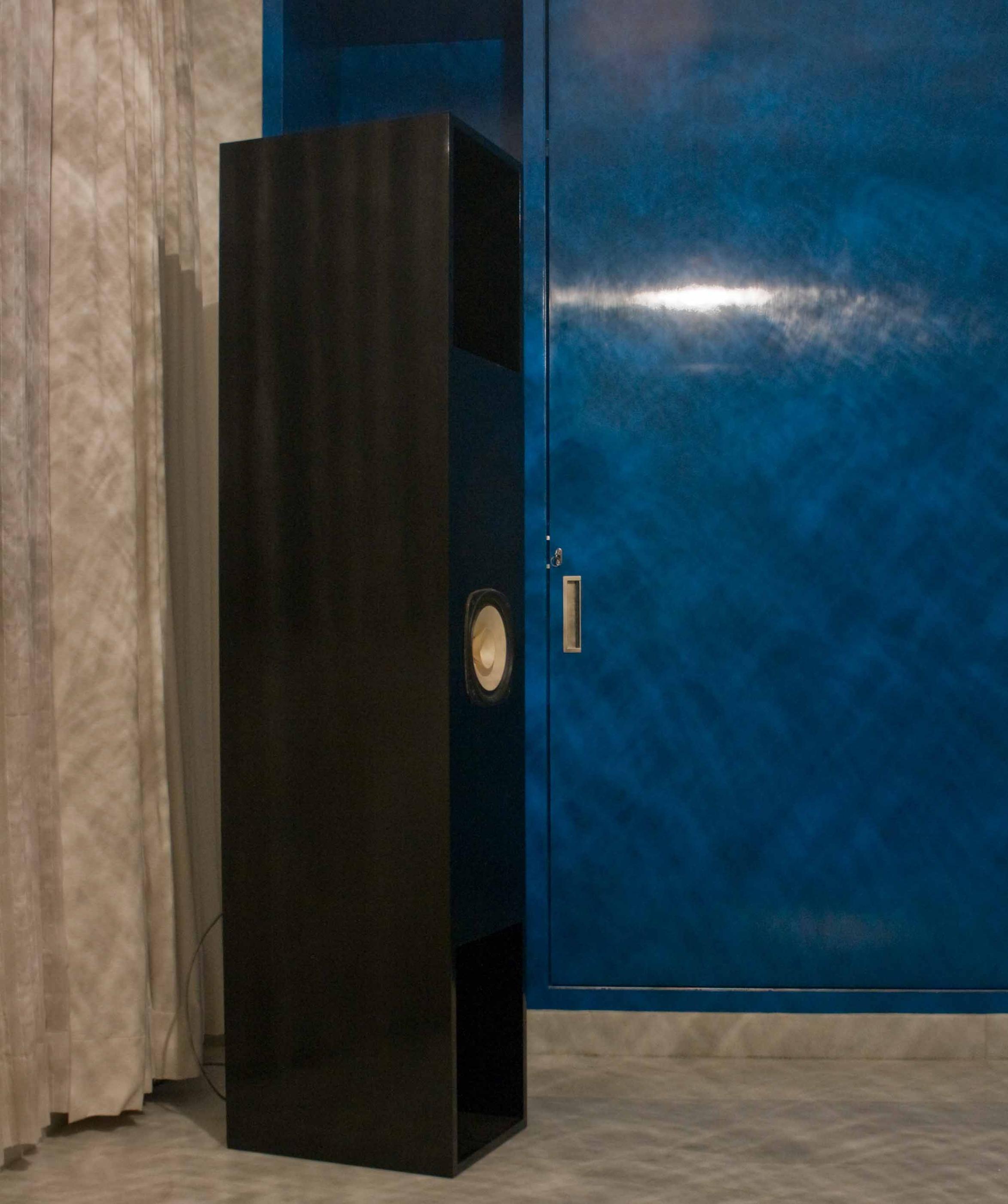

Hi guys,
i have been enjoying the sweet sweet music playing from my sachikos for a few weeks now. i have just managed to take pictures though. i am listening to them through a firstwatt F2 clone that i have just completed.
i thought i would put up some pictures to share what they finally look like. the photos are of the speakers in my bedroom. i am totally happy with the sound, though i added 47 ohms in parallel with the speaker for a bit more damping. before i did this i felt that the bass lacked definition when used with the F2. i am using a cmoy headphone amp as the pre. this is a strictly temporary solution while i build/buy a proper pre.
a big thanks to everyone who helped; in this thread and in others.
