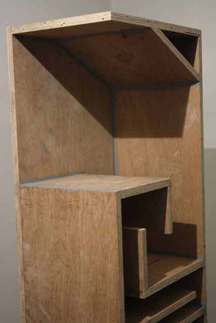

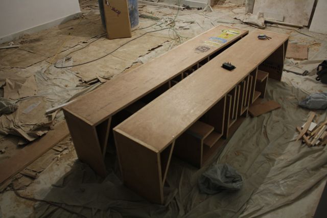

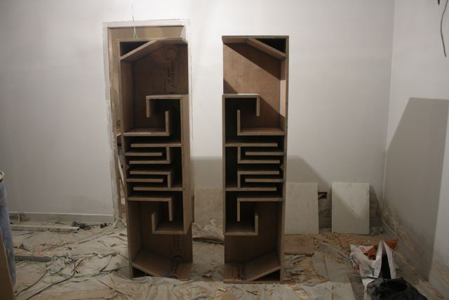

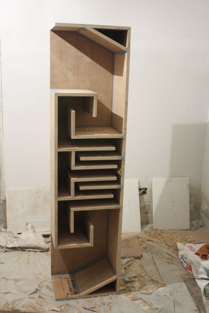

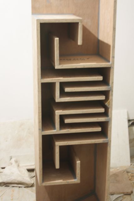

So finally took some photos. Dont have any of the actual build but have attached a few of the cabinets all glued up with one side open..tomorrow i will cut out the driver holes, and the holes for the binding posts..will only get the drivers by next week so cant seal them up till then.
cheers

Great job and you got to this stage pretty quick too!
Did you leave out the "holey brace" part of the A pieces
by choice?
I can check the driver cutout dia and post tomorrow. But
isn't it going to be harder to cut this, now that you have it
all glued up? (unless you have access to a router).
Where are you located in India?
by choice?
Hey thanks quadtech,
i used fevicol to glue the enclosure together and nails to hold it in place. not the most elegant i know but i have no tools and no experience in carpentry. how did you do your sachikos? also, what did you use to caulk the seams? i am using soft cut putty (duco putty) on the seams, and will also use it as a filler before i duco paint the entire enclosure.
yes i know it'll be tougher to do the driver cutout now but in my enthusiasm i started glueing up before thinking the whole thing through. i dont have access to a router and will have to figure out how to do the cutout. i have a circular saw, a handsaw and a drill. i will make the holey brace with 2 additional pieces glued to the 'A' piece. didn't have the drivers with me so i didn't want to guesstimate the size of the brace. i live in mumbai, but am doing this build in delhi.

I used the same - fevicol (white PVA), wood screws and
some greenish wood putty to seal the seams. Your build
looks much better and accurate than mine.
You should be able to find a local carpenter with a router.
Many of carpentry shops here have routers.
But they don't have circle jigs though, but you
can rig up a quick circle jig. It's
nothing more than a length of 6mm mdf attached to
the router base, with a pivot pin (use a nail) at the
proper spacing (roughly half the dia of 7" for the FE206E).

will try and find someone willing to lend me their router,
i dont think i'm more than an mm off anywhere...i just hope that everything seals up tight when i glue the other side in. i dont know how to caulk those seams. any ideas?
thanks again for all the help people, honestly i would never have done something so complex as my first project without the major resource base that is diyaudio.
