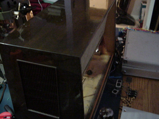

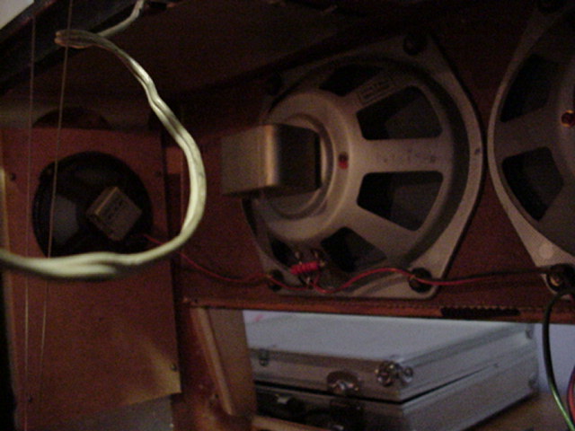

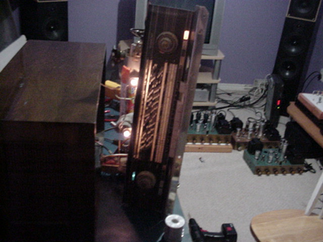

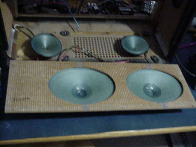

saba console radio working?
lol i have only had it for a few hours and its allready fixed talk about luck retro tuning in new stations on a really old radio.
sounds sweet😀
how much more are these radios worth if everthing works?😉
the problem was a wirewound resister on the b+ was dead 350 ohm 10 watt fixed it.
