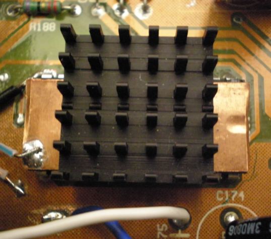

Nice to read that. How did you fix the heatsink to the saa7220? I even put a heatsink on the tda1541 in my dac, fixed by means of piece of a wire going around the chip, not elegant nor reliable. Is there any industrial solution, clamp or so? Pitty that todays computer chips aren't DIL...
Hi PetrL
The heatsink I used comes from Jaycar Electronics in Perth, WA. It is called a "Heatsink Pin Grid Array" and uses a thermal transfer adhesive tape to attach to the chip. Jaycsr sell this heatsink for use wih the high power Star LED.
Jaycar part number is HH-8582. You can see the heatsink attached to the SAA7220 in the photo below. I just stuck it directly onto the copper shielding that I had already glued onto the chip.
However, I plan to remove this small heatsink and the copper strip and glue on a larger TO220 heatsink using Arctic Silver heatsink bonding compound.
I think there are other stick on CPU type heatsinks that you can buy from computer shops, although I have not followed up on that. RS have similar stick-on heatsinks from Aavid Thermalloy. The RS stock numbers in Australia are: 104-036; 103-926 and 103-948. There may be others.
