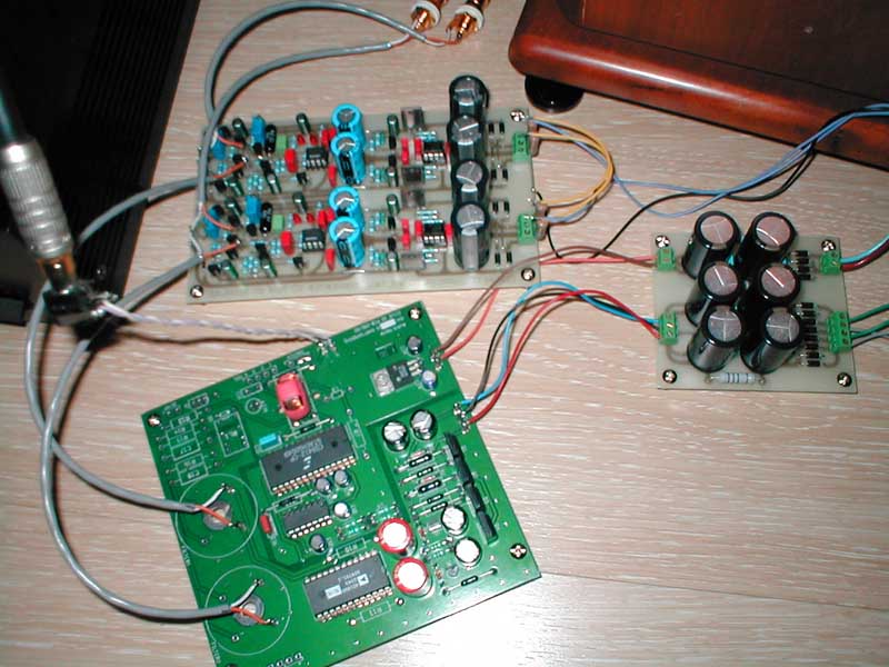

After some changes and headphone listening tests, i found out whats going on with 1 channel. First i added a small extra time delay with 2 cascaded inverters in LE line from lower dac, this dac gets LE direct.
Listening test reveiled no improvement, still a small digital noise, i estimate at -65dB or so. Description of what i heard: a sort of lispeling sound, right after i press 'Play' and when laser hits the track. But when then music softly starts, the noise is getting less obvious. The noise is "around" the music, and like a lispeling of a FM tuner slightly out of tune. MSB adjust helped slightly but didn't cure it. After swapping R / L dac noise kept on the same channel so it must be the logic. Extra decoupling of -5V to MSB adjust schematic did'nt help.
Maybe a better selected PCM will cure the noise. Unlikely because swapping didn't solve problem.
Maybe a small ground wiring error, and one dac keeps picking up noise. I connected Gnd from cdp (near 7210) to Gnd dacs/logic pcb to I/V pcb with rca's. There goes a gnd wire from 7210 to Kwak 7 Pcb too, will unscrew the clock and fiddle around with pcb, maybe it helps.
Added small 330pF styro cap across 100k bleeding R. (Pedja recom. 100p to 1N) to filter some hf noise away, and bypassed MKP, so now its dc coupled, 5 mV is not a lot.
Listening test: With MSB adjust the lispeling is less obvious, and allmost not hearable on normal volume (but like some louder😀 )
The treble roll of starts about 10k and that's why i miss some freshness in sound. Soundstage is some mid forwarded, but overall it's rather relaxed, a good sign. Depth of soundstage is not very deep, but delaying of echoes are very obvious decaying, good sign again. Mids is still slightly distorted, and treble too slightly, but less compared to 1541 nonos (that one had 4 transistor simple I/V though)
Listening with 1541 nonos i had somewhat "rollercoaster feeling", (a wildness) pcm56 is more relaxed, but has the same nonos features: phase errors are gone, analog TT feeling, you are better involved with music, harmonics are more displayed (guitar plucking, and when player is thumping at guitar-case you can hear nicely this typical sound in the recording studio. Also the small ambient noises aound voices are very obvious.
On the contrary, some tones can oversound other instruments, and then the nonos seems some less detailed compared to digitally OS'ed music. This can also be by the slight distorsion a single PCM56 can give. But again, less then the 1541 nonos.
I have some hearing problems, but can hear more easy in the music with this nonos PCM56 compared to modded TDA1541 with SAA7220 dig. OS.
Sorry for these hazy descriptions of the soundQ, but that's how i hear it.

Hi Tubee
there should not be any lispeling or noise.
The pure sound will not be there until you get rid of it.
You could trace that problem with a scope.
Compare L and R channels @ -60dB and find a difference.
Again: Forget the K-grades. The grades are determined without MSB adjust and assure a minimum of performance unadjusted plug and play, that lies far behind a selected & adjusted ( what you have ) chip.
Try passive.
Perhaps try CS8412.
You can get rid of the rolloff with analog filtering.

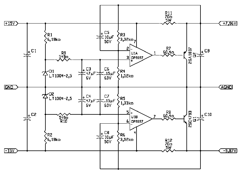

I used for PCM56 PS two 75L05 and two 79/05 regs. But i think the analog -5V supply can be cancelled, i don't use the internal opamp. Not sure about this.

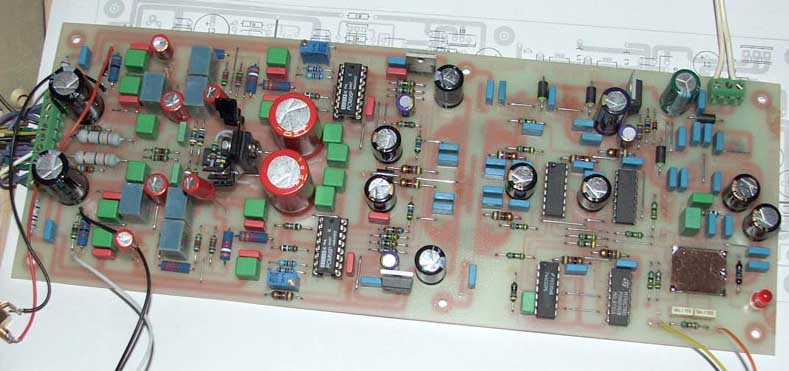

Hi tubee!
...Nice dac, did you edged PCB's yourself, or let it done professionally?
Yourself. On my kitchen. 😉

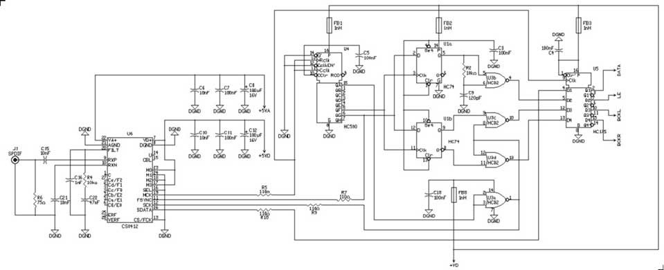

...the timing errors are gone. But it has rather high chipcount for first experiments. The schematic can be simplified; 74/74 can be omitted with single ended operated dac's. Data is shifted in R-L and WS-LE untouched. The PCM's LE pin only works on falling edge of LE and pcm's decode simultane along with the shifted data.
I don`t use shift registers. I use breaked bitclock. But 1851 work good with use FCK from 8414 as LE. PCM56 - dont work (noise in right channel). For correct work PCM56 you need some different square of FCK.
"Heart" circuit of my DAC attached. Sorry, but full circuit is not complite.
...I used for PCM56 PS two 75L05 and two 79/05 regs. But i think the analog -5V supply can be cancelled, i don't use the internal opamp. Not sure about this.
I use LT317\337 (Linear Tech STRONGLY!) for digital and discrete shunt regulator for analogue. I\V Opamp, GIC-filter, fet-input opamp as output buffer.

...So you used the stopped clock operation like depicted on AD's AN207 application note.
NO. I use 8412 (or 8414) in slave-mode. 74HC590 divide master-clock (Fs, 64 Fs), 74HC02 - break BCK and some shift square of FCK, 74HC175 - reclock all signals for DACs.
...Have somewhere a schematic of discrete shunt PS, never tried it.
simplest circuit attached. correct nominals for need output voltage. For finest work needed current across 1837\4793 approx. 100 mA
