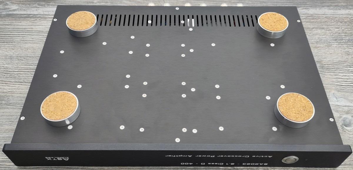

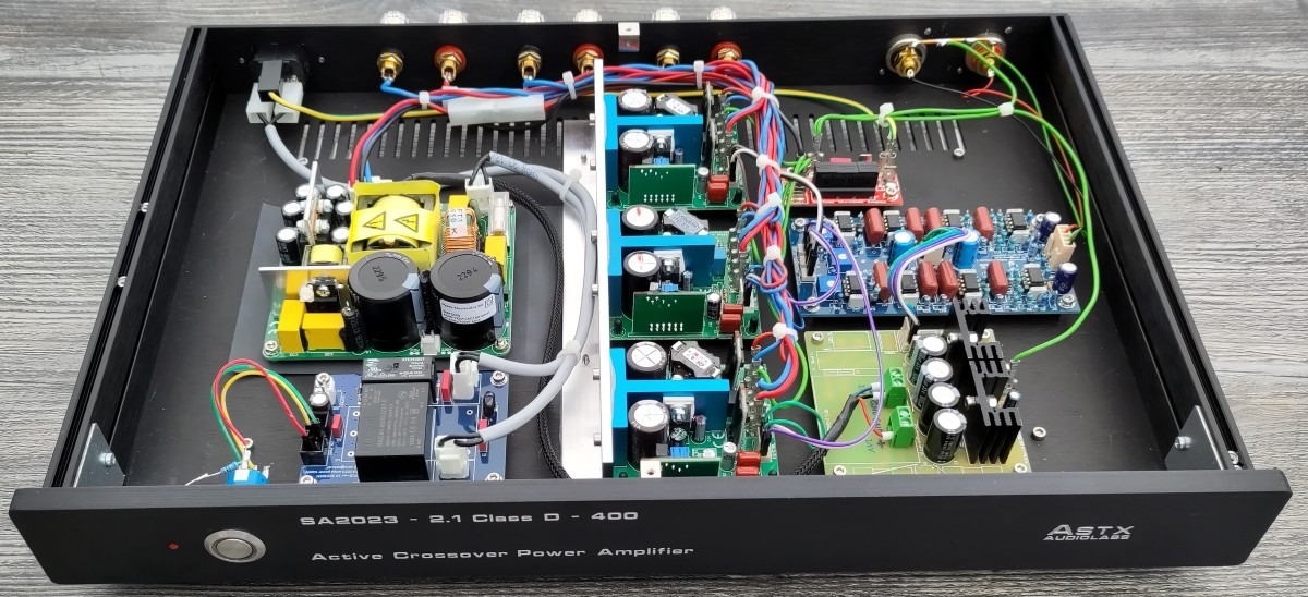

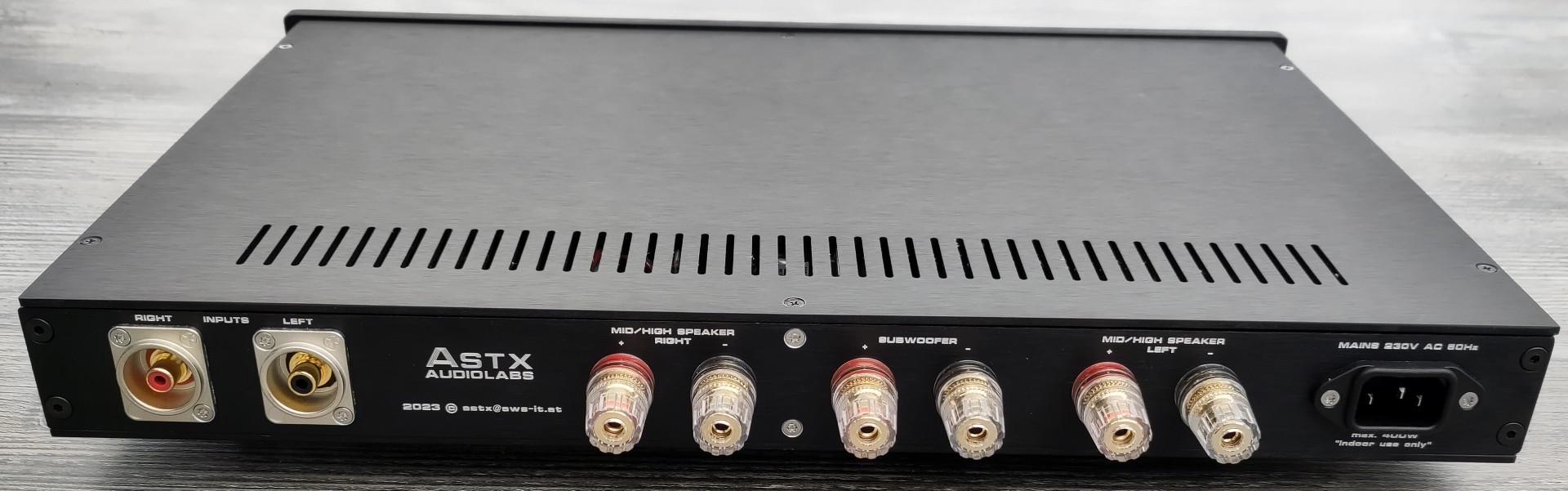

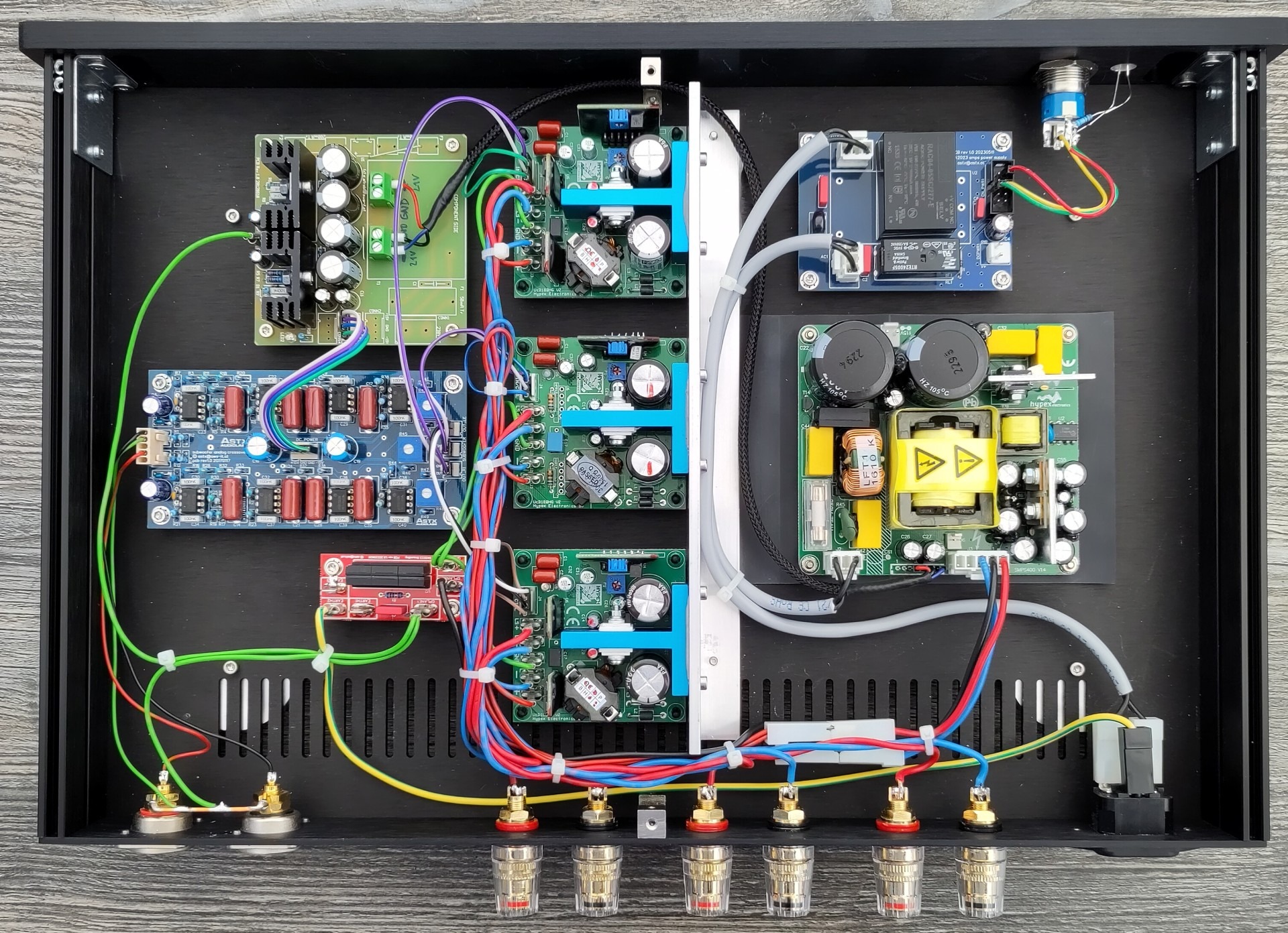

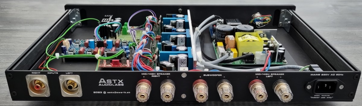

Has been a long time to finish this 2.1 active crossover amplifier project.

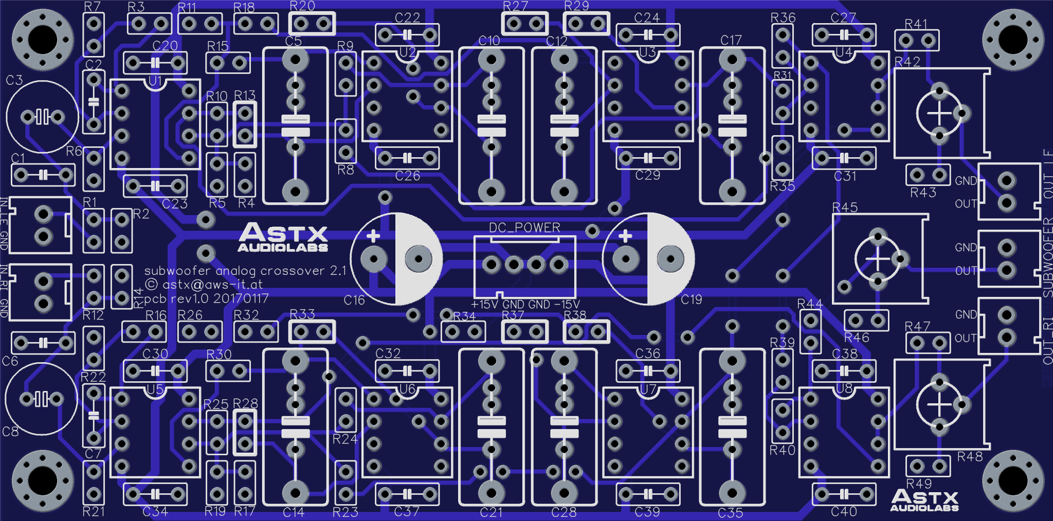

The projects idea started 2017 by designing a 2.1 linkwitz riley 24dB analog crossover pcb.
Hypex components used in this amp:
1 x SMPS400A180
2 x UCD180 HxR
1 x UCD180
Modushop.biz:
1 x Slim Line 01/280 10mm BLACK front panel - 3mm aluminium covers - Rear panel: Without IEC hole. Typ: 1NSLA01280N
Own components used in this amp:
1 x +/-15V powersupply for the analog crossover - +/-21V derived from SMPS400A180
1 x analog crossover pcb
1 x sa2022 grounding pcb
1 x 5V power supply with 230V/16A relay - prepared for MCU control
The crossover frequency is tuned to 80Hz. The 2 basschannels are mixed down to a mono subwoofer signal.
The 1 HE sized case has been diy machined and diy engraved at home using a grblHAL style diy CNC machine.
A perfect combination to drive my outdoor 2.1 system (2x Polk audio Atrium 8 SDI and one Atrium SUB100)
Have fun,
Toni

I also ask, what are the trimpots on the crossover output for?
