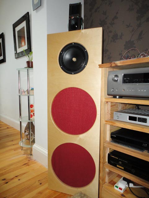

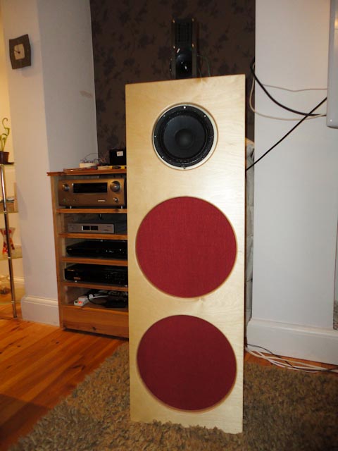

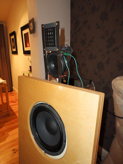

That is where I saw this progressing, 3" and neo3, so I would be interested in any builds that go such a way or ideas that are put forth. The photo shows the top of my current PLLXO active four-ways. I do not have measuring equipment unfortunately, nor much expertise, so cannot feedback much.
Neo3 dipole
Monacor ms100-chq (need to bring this forward on the mount I expect for time alignment)
Monacor sp8/150pro
dual Alpha 15s

Anyway, the picture shows my DIY pine wood phase plugs on my B200s which I originally had in place. They sometimes slip in the mount unfortunately and rub the driver making a slight sound which alerts me. I need to resolve that. Two screws in the back hanging on by magnetic force alone is not enough it seems.
