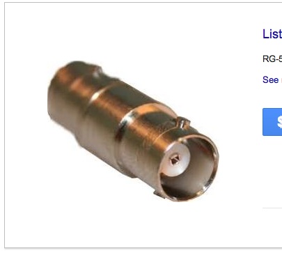

BNC coupling?
Not that I doubt it but, it looks like where the hole is for the post in the spidf connector is too far back.
Also, there are the posts which come out of the sides of the coupling.
Will it work? Do the posts get snipped off or cut.

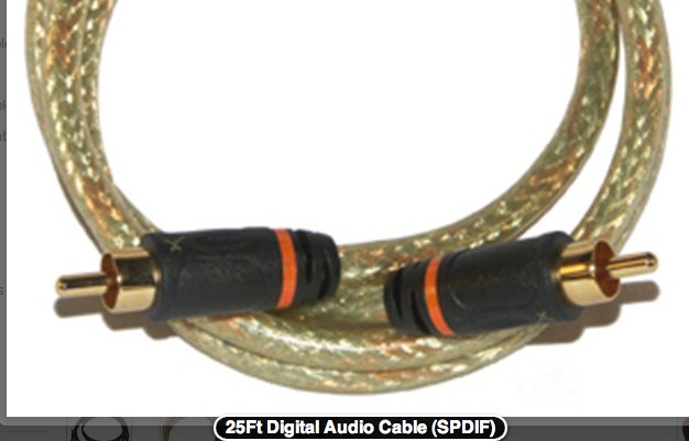

Yes, currently the interface to spidf on the speakers is "spidf "wire.
As you suggested, BNC or RCA... which would you use?
Sorry....
I don't see how the spidf will fit the BNC
The tabs out of the side.. and the internal hole ???

You misunderstand. There is no such thing as an 'SPDIF connector'. There are two common options: 75ohm BNC (as used for component or composite video) or RCA. BNC is electrically correct, but RCA is good enough. You can't join RCA to BNC, as you have discovered.
You just need to buy or make the appropriate cable for your equipment. This will be a normal good quality 75ohm coaxial cable, with the appropriate connectors on each end. Don't buy 'audiophile' cables - they are a waste of money. If you need RCA on one end and BNC on the other then this is fine.
If you are making equipment then you can choose to use BNC or RCA. Up to you.

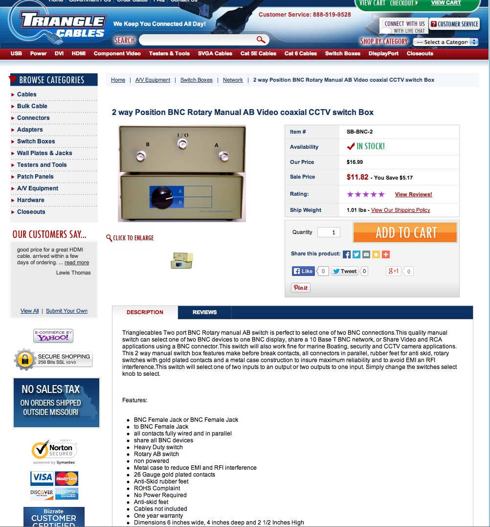

Beating that dead horse.
Been navigating around the sight.
Pretty intense stuff!
Googling,looking at bnc to rca adapters and bnc A/B switch.
I would ask if something like this would work, but the make before break could be a problem, right?
I will keep looking.
