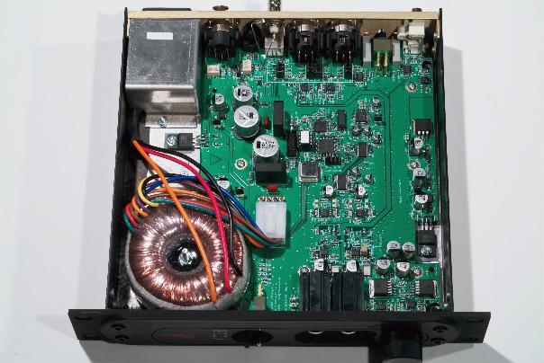

SPDIF in pictures
The Benchmark DAC has a 50 ohm BNC connector (for a 75 ohm interface)followed by a couple of widely space wires connecting it to the PCB (high characteristic impedance)that also acts as a large loop area to pick up RF noise in the DAC. Stick a RCA to BNC adaptor in there for your favorite RCA connectored digital cable...
Gee I wonder why you can't here decent digital cable differences. Yes I'll bet they use resampling!
These people have the engineering talent to do better than this for the SPDIF interface, it is sad. This is pretty typical for ever high priced DACs.
I guess it is inside the metal enclousure of the DAC so it is considered "RF-safe". The RF inside would be relatively low, and the short cable distance can tolerate it. BTW, the torroid is much furthur away. 😀
