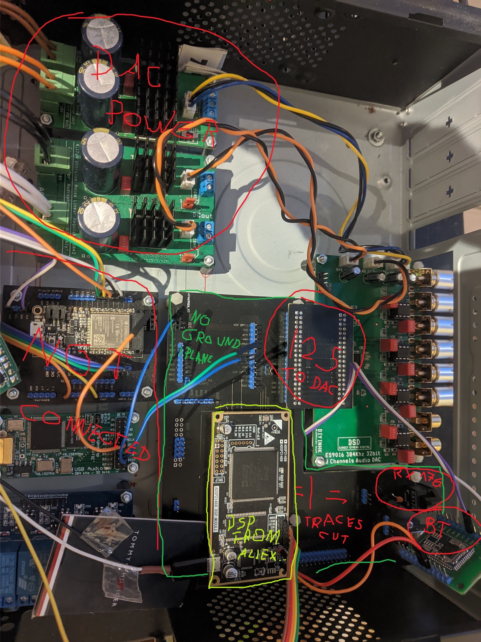

Im struggling with spdif input on aliexpress sharc dps. All i2s in/out work fine, when I connect spdif at beginning all is fine, then noise start to raise slowly, usually takes 3-5min for noise to come. If I power off and back on quickly noise is still there. I need to wait till it 'cool down' like hour or so, then all is fine for that couple minutes when I power on.

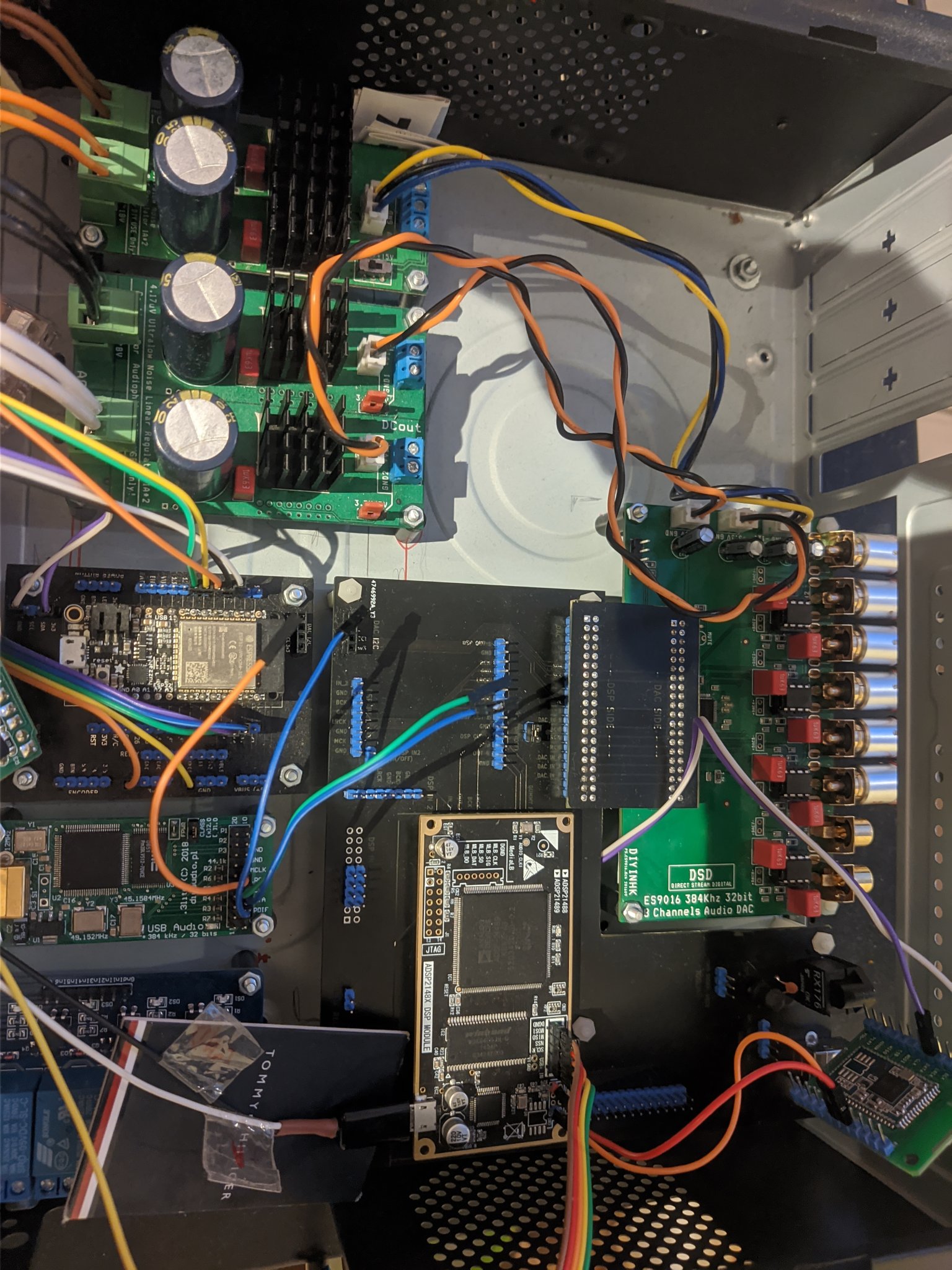

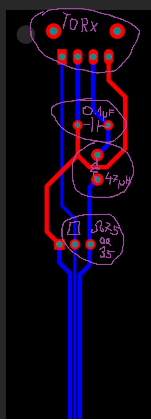

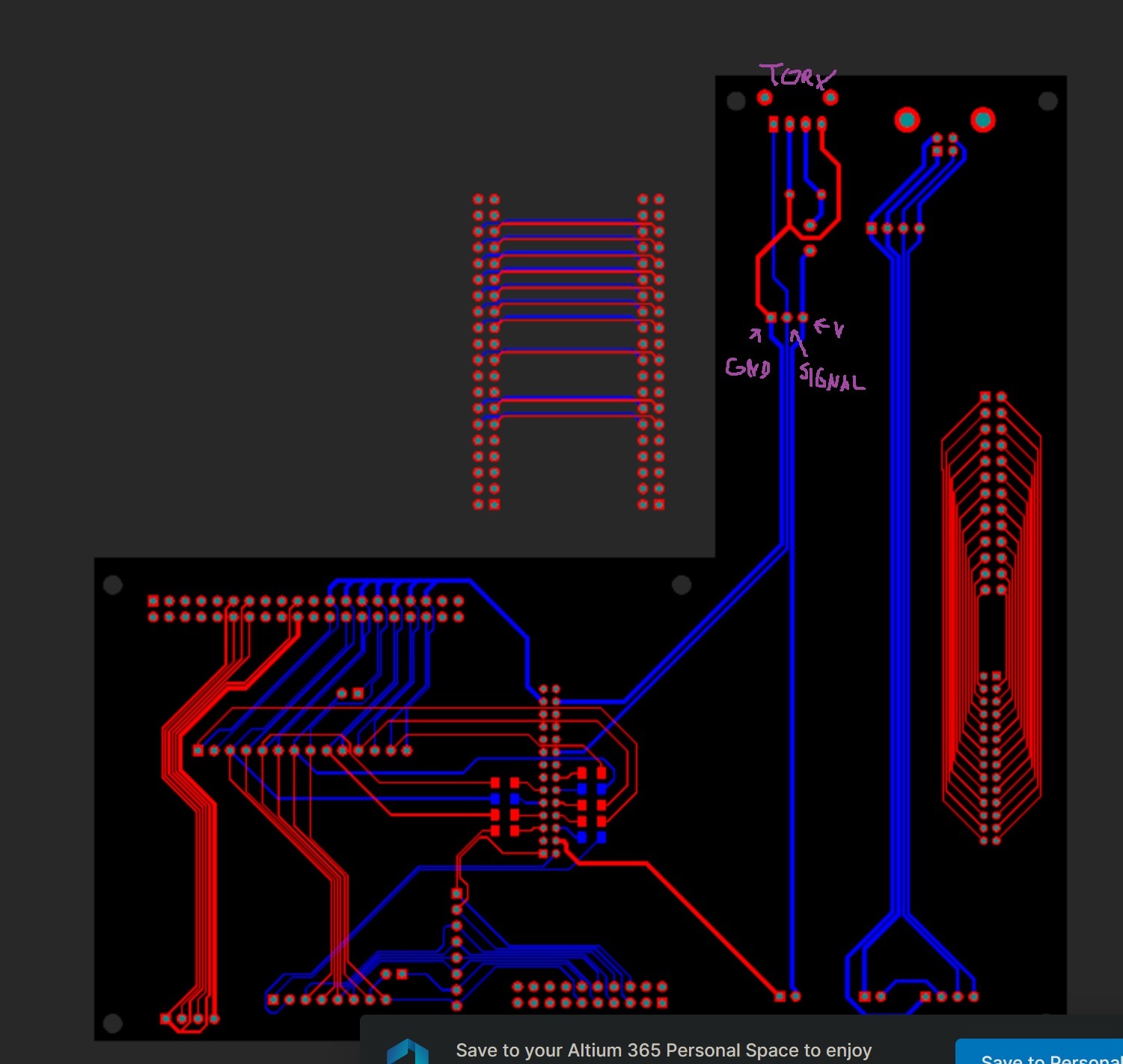

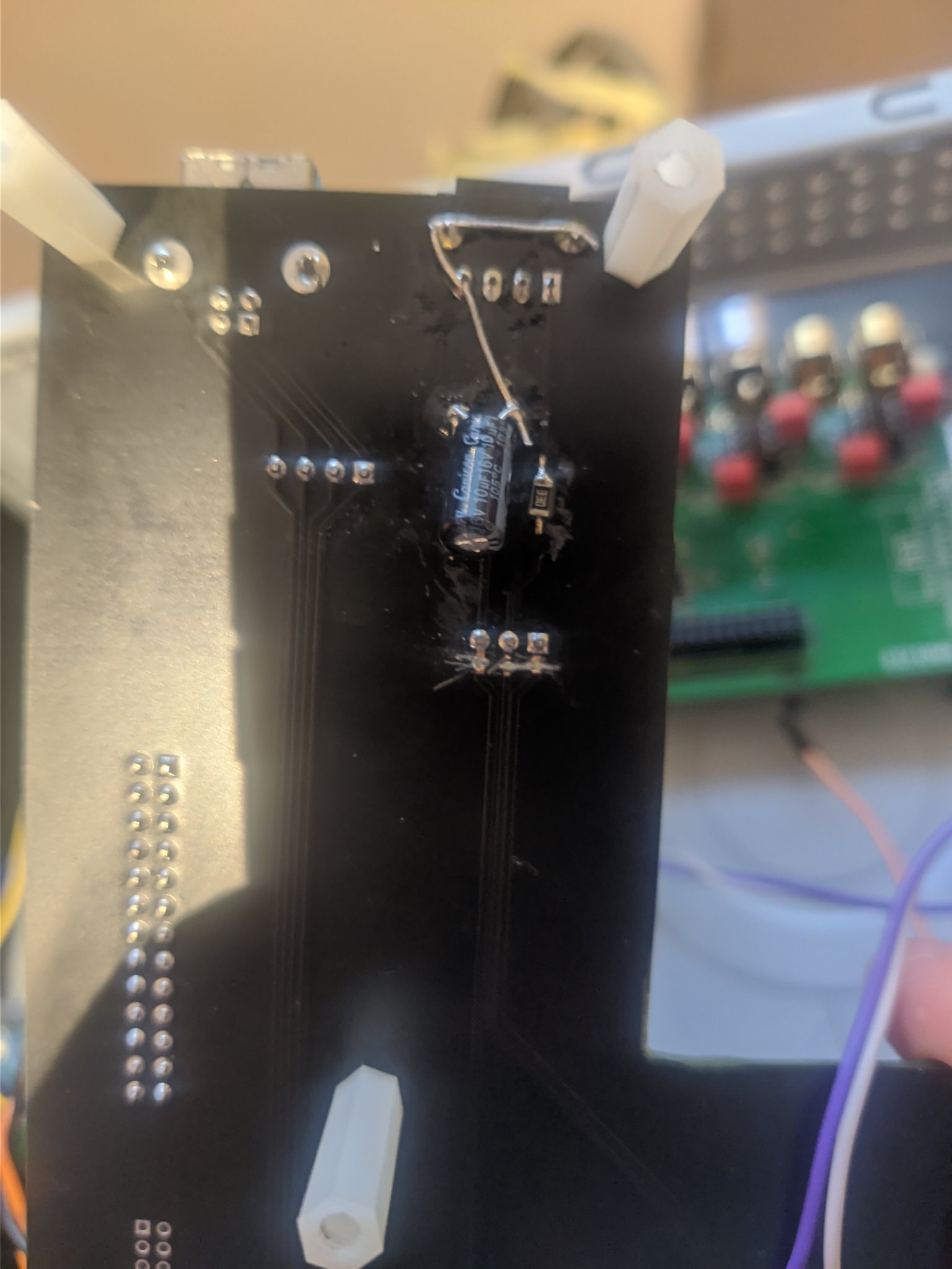

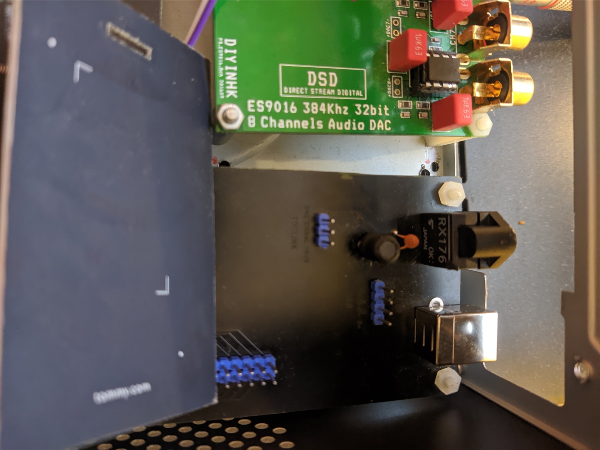

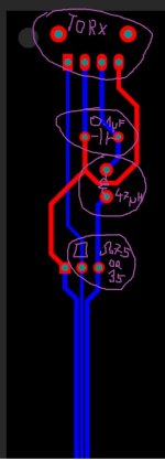

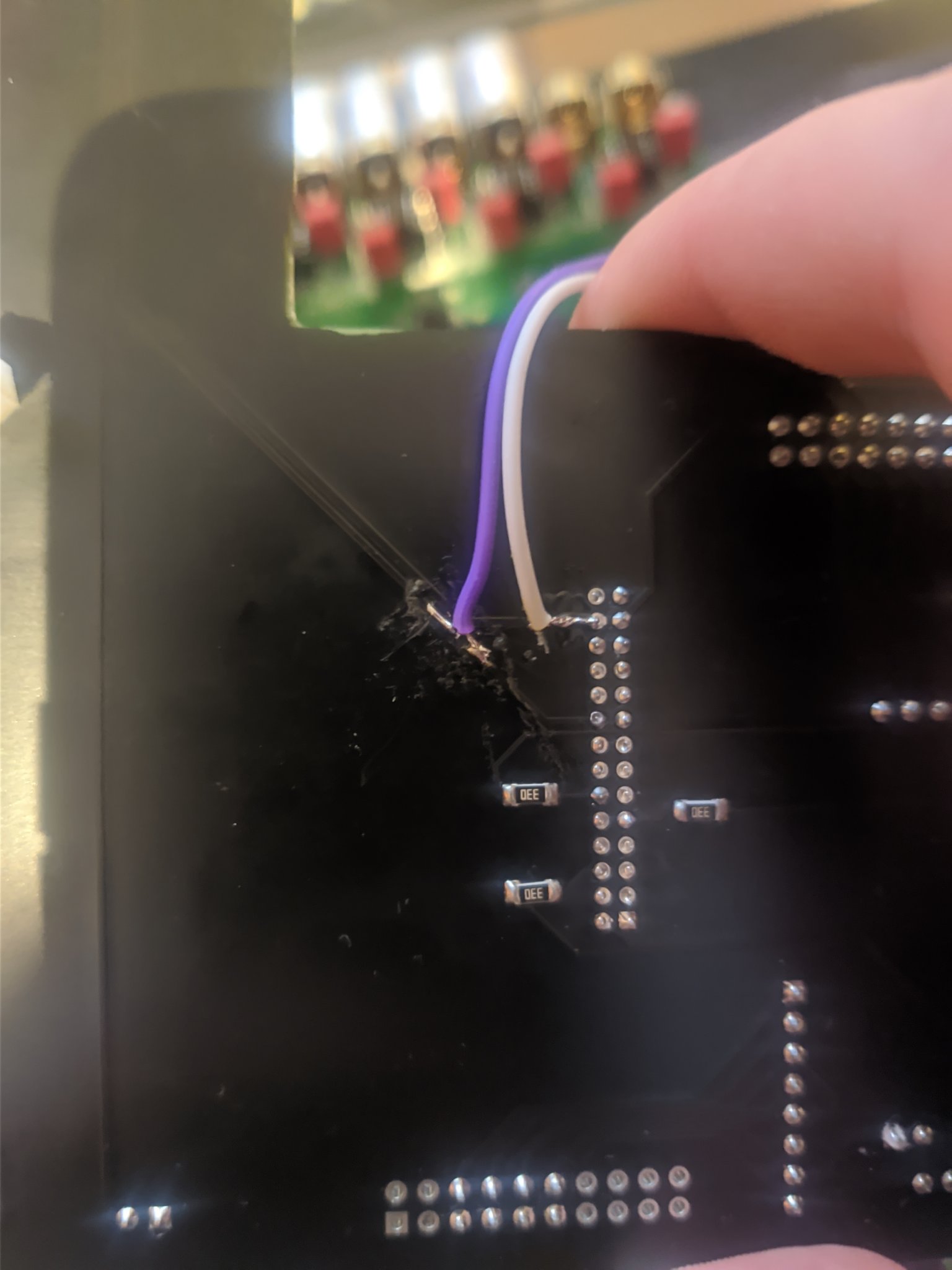

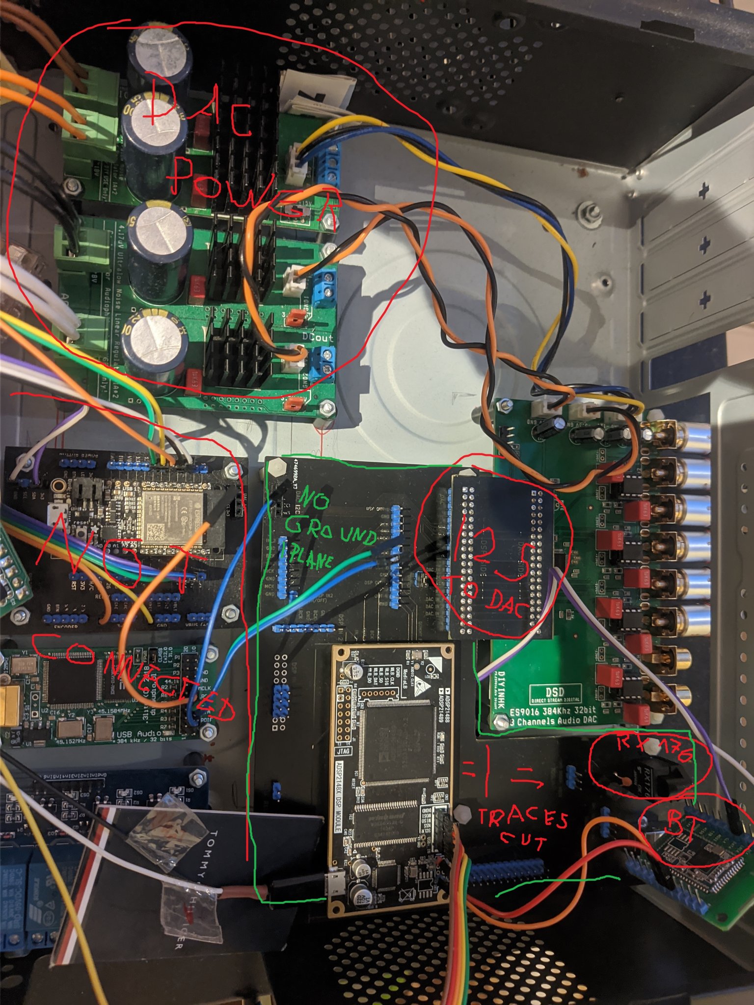

Tried my best, will add more if needed and sorry for getto style diy.
Board that is under dsp made myself.. 2 layer board, no ground or power plane just traces. I use the as adapter for non standard 2.0mm raster pins on dsp board.
Right now csr8675 BT module is connected via goldpin close to dsp core board.
I did cut the traces to RX176 for testing. those are signal(violet) and ground(white)

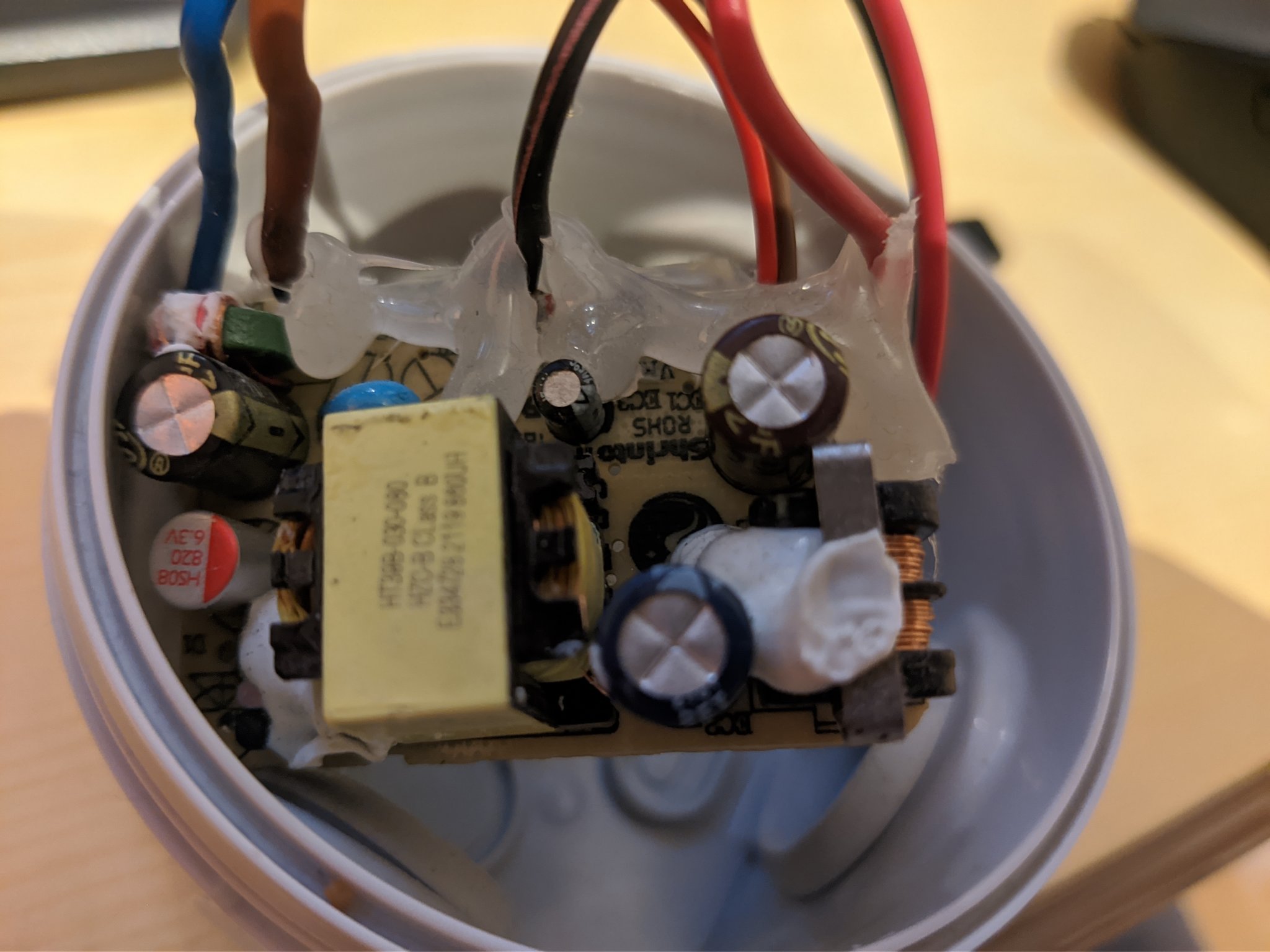

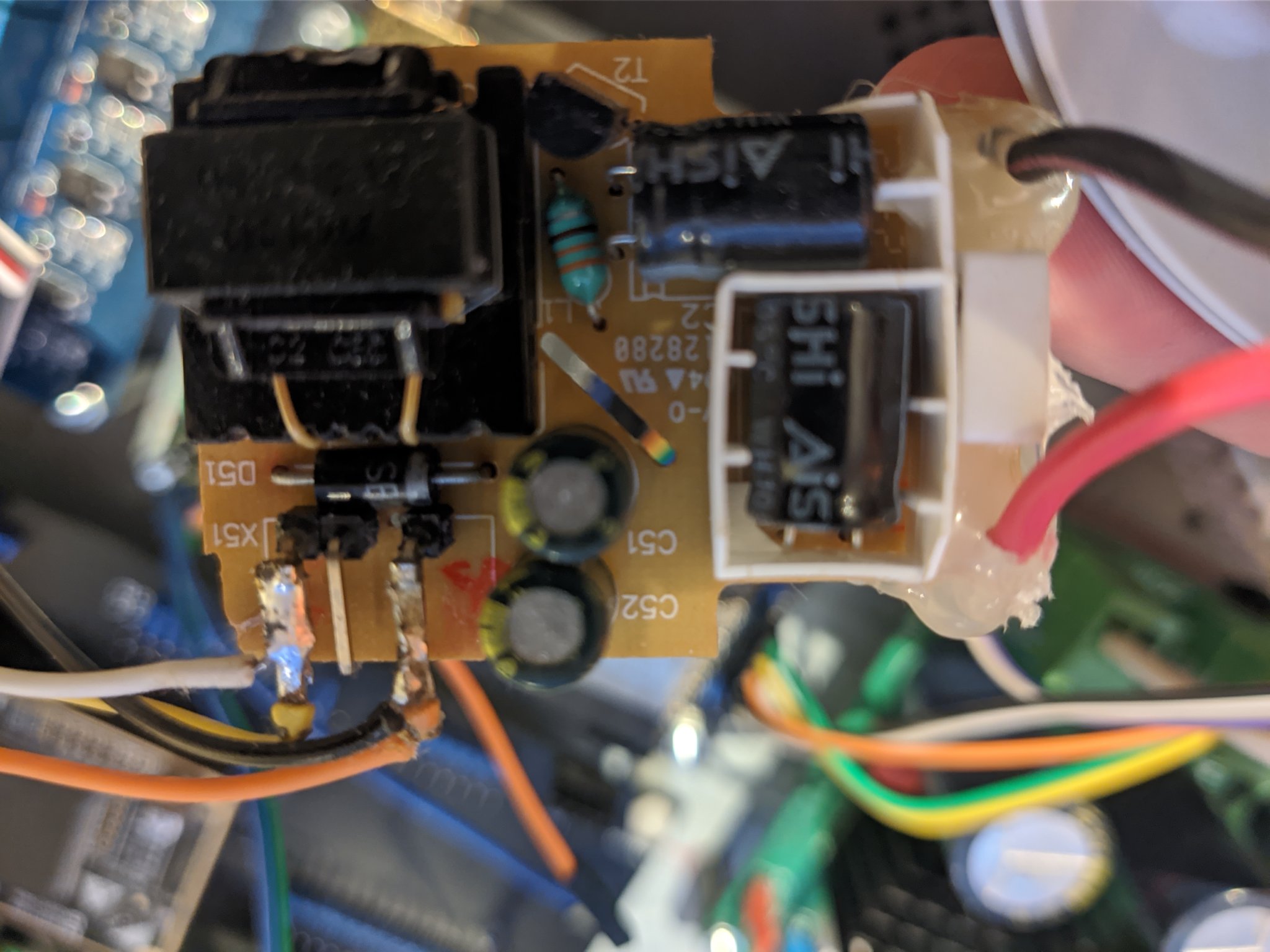

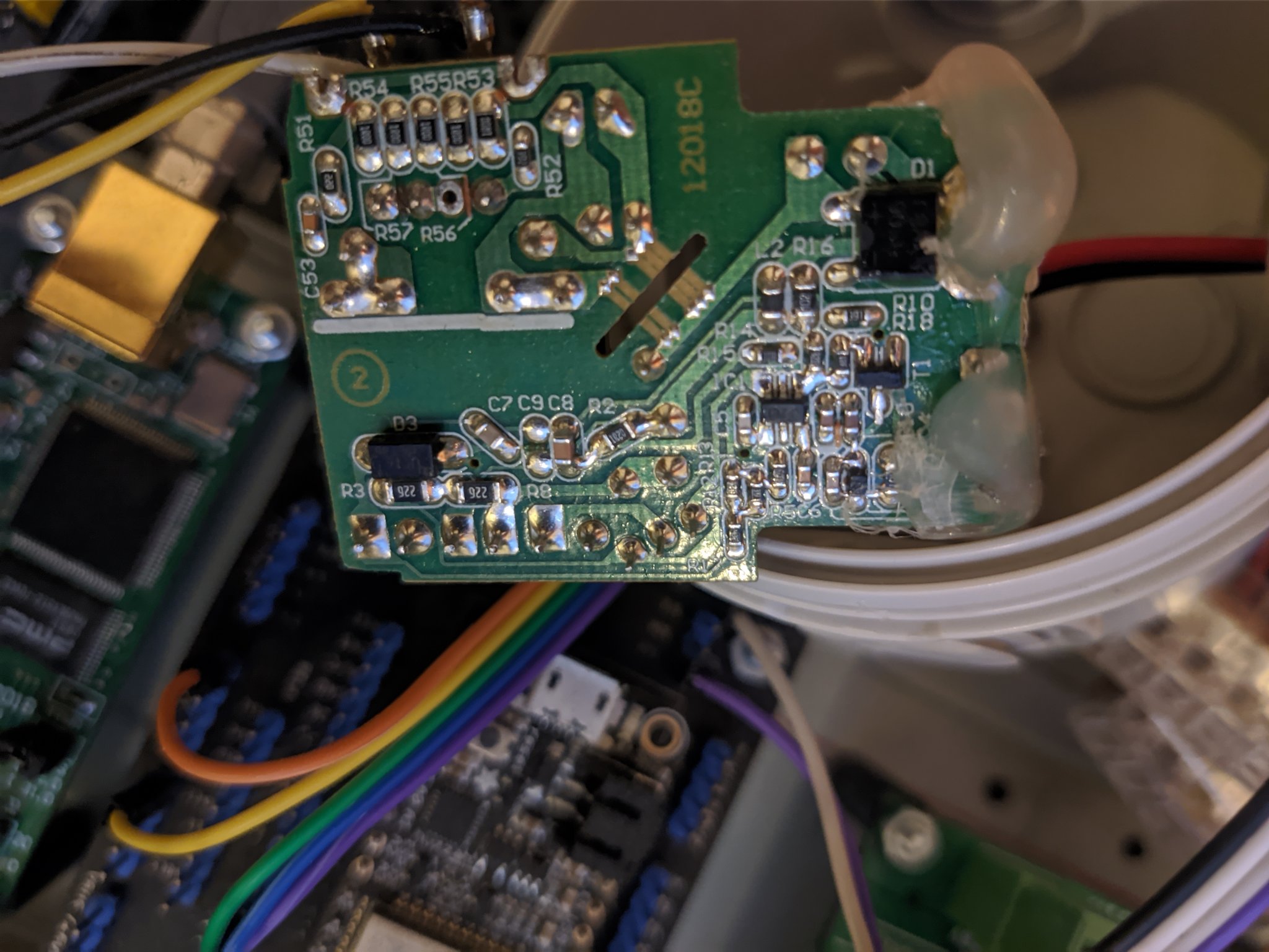

The PSU:
For now Im using cheap usb chargers, tested 2 of them with same result
DSP is powered through USB socket
1. Cant identify VR, think was around 1A
2. Think was 2A. VR: cre6255 2109WE http://www.cresemi.com/uploads/soft/200920/2-200920160949.pdf

RX176 bottom and top view
Kicking in an open door: my suggestion is to use 78xx based regulators (or other linear regs if the current demands that) just for testing instead of the USB chargers. Please shorten cabling and route all cables neatly and as far away from circuits as possible. Looks better too. Then report back.
Keywords: "cheap" and "USB charger".
Strong advice to build safe. Those cheap USB chargers (opened) and not mechanically mounted are not safe. Build well or don't build at all.

I have spdif signal on bottom side of the board so will problem to make it really short, think I can do something like 4-5cm, will try that.

I was suspecting some problem with ground, or that I made antenna from traces on my board by accident.. bad solder joint somewhere?

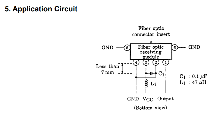

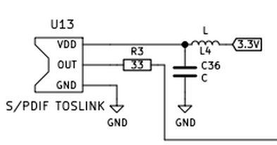

Okay. Where is the torx176, how is it powered, how far away is it, is its output capacitor coupled, what kind of signal wiring are you using...50-ohm, does it have a termination resistor on the line between the torx176 and the SPDIF input on the DSP chip, etc.?
EDIT: Also, is the torx176 configured as shown below?

Track length is about 13cm
I did try both 33 and 75ohm resistors on torx side
Output coupled? signal wiring 50ohm?.. dont think so, how to do it?
You could do it like:
Normally ground would go to a ground plane, maybe layer 2 of a 4 layer board. With the 33R resistor in series with the optical receiver output that makes it capable of driving a not too long 50-ohm transmission line. If you can't do that on your PCB and interconnect wiring, maybe better to just use a thin piece of 50-ohm coax from the right side of the 33-ohm resistor (as shown above) to the DSP board. Ground the coax at both ends or you could cap couple if LF ground loop problems (if you want or need to do that then there needs to be one or some resistors at the input of the DSP chip so the input has a path back to ground, unless it already has that internally). Also good to remember, you are dealing with RF with fast clock edges. The harmonic frequencies associated with those edges may extend up into the hundreds of MHz. The signals, bypass, ground plane use, etc., should be treated with some care and respect. Power should probably be the same power as for the DSP board.
Reactions: ppp000
The electrolytic probably isn't that critical, but the bypass cap should be as close as possible to the power and ground pins on the optical receiver. What about the inductor?
Also, do you have a scope? Freeze spray? If you are getting noise from the SPDIF input then the signal probably wouldn't look right on a scope. Could also be that the jitter is too much for the ASRC to track. Where did the torx176 come from, and is it new or used?
Also, do you have a scope? If you are getting noise from the SPDIF input then the signal probably wouldn't look right on a scope. Could also be that the jitter is too much for the ASRC to track. Where did the torx176 come from, and is it new or used?
Electrolytic was added recently for testing. Now I see distance from legs is bigger than it should, ok if I remove 0.1uF cap and solder it directly to legs of torx176?
