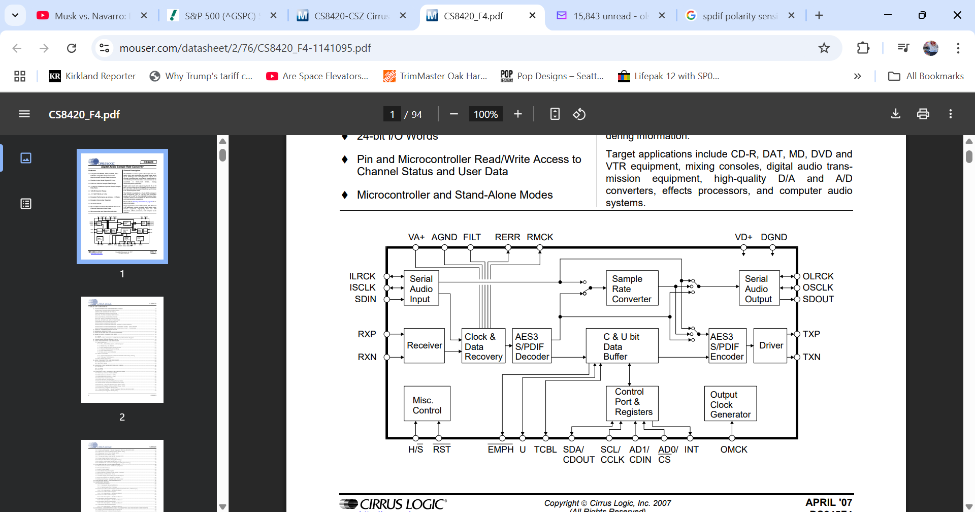

This is the answer right here. The chip has a second output. If it is enabled, doing what MarcelvdG said here would be the way to go. Check the TXN pin for signal. If it's not there see how to enable it in the datasheet, then replicate the circuit that is connected to TXP. Done. Pretty interesting that the Manchester coding used by S/PDIF is not polarity dependent.Edit: you can invert an S/PDIF signal without changing anything, so you could just build a second instantiation of the present circuit and connect it to TXN. TXP then drives one output and TXN the other. The series resistor then has to be about 350 ohm, I don't understand why it is only 56 ohm in post #1.

Looking into the CS8420 Datasheet, both TXN and TXP have identical output drive capability of 21mA. This matches the 5...6x 4mA capability e.g. the (often recommended) 74HCT04 chip would provide. So why not simply take the SPDIF output circuitry from TXP and duplicate on TXN as was suggested before and be done? ... or which better line driver type do you recommend instead because of the 5m cables?

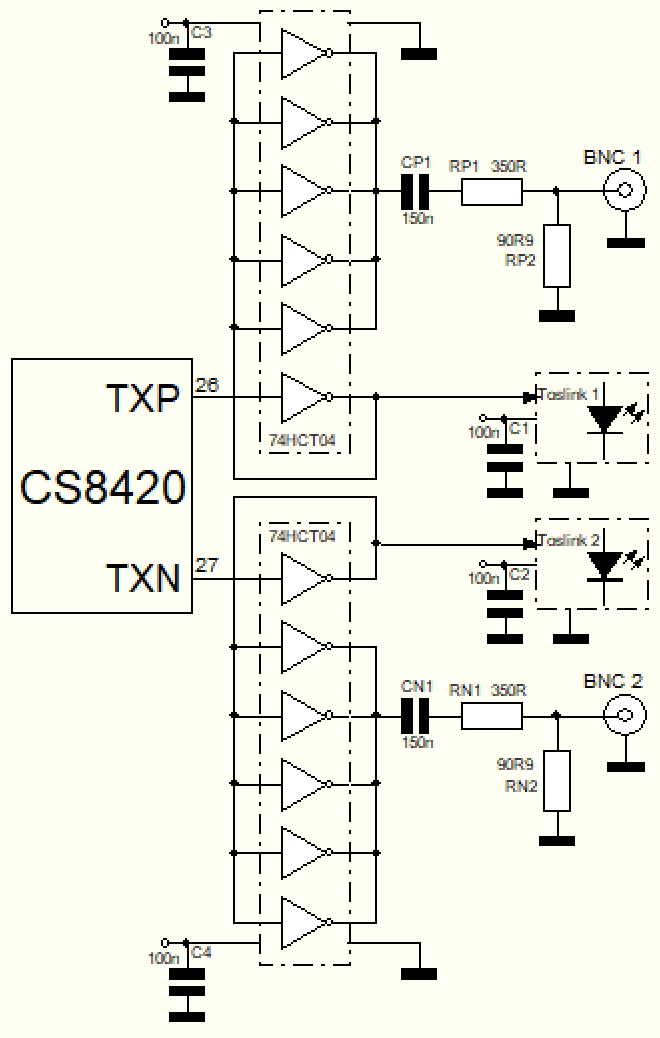

OK. Please have a look at this schematic. I have inluded Toslink transmitters as well, because I wanted to test both alternatives.
So, is this what's proposed as buffered BNC Outputs for my application?
Are the resistor values OK?
Are the CP & CN Capacitors required, nice to have or not needed?
Are any other components missing?
Thanks for your feedback!

Looks OK to my amateur eyes but I have not kept up at all with extreme high performance stuff and picoseconds of jitter. Caps are necessary. CS8420 and 74HCT04 both are 5V logic but finding 5V Toslink transmitters like TOTX177 will be hard I think. Most of todays Toslink stuff is both non Toshiba and 3.3V.
FWIW I would give 74HCT04 and Toslink separate SMD regulators (if possible).
Are you sure you do not need SPDIF transformers? Both end devices are also mains fed aren't they?

Yes, end devices are mains fed. Interestingly, though, the orignal Cinch SPDIF circuit (which I will disconnect from the CS8420) just does not have output transformers, unlike the (unused & disconnected) AES3 output circuits with PE-65612NL transformers. If transformers proove necessary, I may "abuse" the two available PE-65612NLs for the BNC connectors - hmm? I will reserve some board space for that..... Are you sure you do not need SPDIF transformers? Both end devices are also mains fed aren't they?
Winfried
My method is to have the PCB pads for the transformers cleverly placed so that either resistors/0 Ohm resistors or the transformers can be used. It can then be either without much penalty.
I think you want Murata DA101C. You could check if the devices at the other side have transformers. I never saw the point of having 2 of them.

Ha! Actually this is a good point, especially as my driving DSP will only connect to my speaker DSP x-overs! ...and these have transformers in their coax input circuit. So, I'll leave the space for the transformers on the driver side and not populate them for now.You could check if the devices at the other side have transformers. I never saw the point of having 2 of them.
