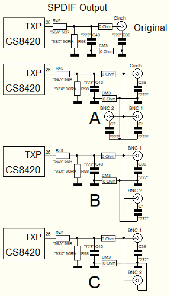

My good old well working Audio DSP has a digital output port with CS8420 feeding a AES3 (with TXP & TXN) and a Cinch (75Ohm) Output (with TXP) in parallel at Pin26.
The picture "original" shows the output schematic as far as I could analyse the (4-layer) board (pretty obviously with supply and GND layers). GND on the board is split between the output connector area and the circuit area (for unknown reasons) bridged with 0Ohm parts.
My Plan and request for confirmation or advice what to do:
The DSP is planned to drive 5m/15ft long koax stereo SPDIF BNC connections to each of my stereo speakers sporting digital 4-way "mono" x-overs. I.e. whether the speaker is "left" or "right" is selectable in the speaker. So, basically I need two parallel BNC Outs (would remove the cinch connector and disconnecting AES3 circuitry).
Please kindly have a look at the schematics and options I have come up with. I am sure my stuff needs changes to work properly, so I would be very grateful for recommendations "how to do this right".
Thanks a lot for reading all this and I hope you care to answer with any helpful recommendations.

AES3 signals are at a higher voltage than SPDIF. See page 8 of CS8420 datasheet for Rtxp. Then the circuit for driving one 75R SPDIF coax is shown on Page 78, figure 31.
If you need to drive two SPDIF level coaxes at once, it depends if you will aways be driving two loads, or sometimes you may be only driving one load. It also depends how much output current TXP is able to supply, since two 75R loads in parallel would amount to about a 37R load that TXP would see (and I don't see a limit on output drive current specified in CS84200 datasheet).
Might be possible to change SC8420 output resistors to match to two cables, if it could handle the drive current. Maybe that could be helped by reducing the SPDIF voltage swing some. Might be workable that way.
I suppose you could also make an active splitter that uses a multi-channel clock buffer chip which is designed to drive 3.3v or 5v into a 50 R load. You could use resistive attenuator impedance matching at the outputs to match to 75R and the required voltage swing. Seems like a lot of trouble though.

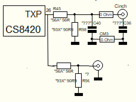

I would try two separate voltage dividers driven from a common TXP output, if there is space to fit the components. Preferably AC coupled to TXP to keep the current below the 21 mA specified on page 8 of this datasheet:
https://www.mouser.com/datasheet/2/76/CS8420_F4-1829.pdf
In pseudo-PSpice netlist syntax something like
C1 TXP node1 100 nF
R1a node1 outa 330 ohm
R1b node1 outb 330 ohm
R2a outa ground 91 ohm
R2b outb ground 91 ohm
The BNC connectors can either be connected straight to outa or outb and ground, or via 100 nF capacitors, or via S/PDIF transformers.
Edit: you can invert an S/PDIF signal without changing anything, so you could just build a second instantiation of the present circuit and connect it to TXN. TXP then drives one output and TXN the other. The series resistor then has to be about 350 ohm, I don't understand why it is only 56 ohm in post #1.

Just build a second instantiation of the present circuit and connect it to TXN. TXP then drives one output and TXN the other, but an inversion has no effect on an S/PDIF signal. The series resistor has to be about 350 ohm, I don't understand why it is only 56 ohm in post #1.
Why would you when you already have two transmitter outputs, TXP and TXN? Only the RC circuit needs to be duplicated.
The series resistor is 56A which is 374 ohms. Exactly what datasheet recommends.The series resistor has to be about 350 ohm, I don't understand why it is only 56 ohm in post #1.
https://kiloohm.info/eia96-resistor/56A
Did not notice that RTXP term. Probably the DSP designers missed it as well 🙂The datasheet recommends 374 ohm - RTXP = 374 ohm - 25 ohm actually

Hi folks,
a BIG thank you to all contributors! I'm overwhelmed by all the responses and discussion!
So let me try to boil all this down a bit as a few alternatives appear to exist for my case:
1. Duplicate the TXP Output circuitry (with Rtxp ~350Ohms) to drive the second BNC Output in parallel to the existing one
This seems viable to me because of the AES3 having been in parallel before and woule be disconnected, so TXP fan out would seem sufficient.
2. Duplicate the TXP Output circuitry (with Rtxn ~350Ohms) to drive the second BNC Output from TXN
This looks smart, but is neither recommended nor prohibited in the CS8420 Datascheet.
3. Implement dedicated Line drivers for each BNC Output
This seems to be the optimal technical solution, although, the existing system did not have that and uses the TXP/TXN outputs with their 25Ohm source impedance - so this option seems "not requiered" to me.
4. The external Splitterbox connecting to an AES3 output is not favourable to me in light of simpler system internal solutions providing the desired end to end 75Ohms BNC connections to begin with. But conceeded, this would be less DIY work...
So, I'll basically decide between option 1 and 2, probably try both.
This begs the question, though, which circuit to build in detail:
The reverse engineered schematic seems complex, but that may be for a (so far unknown) reason. Can anyone make sense of the original circuit?
