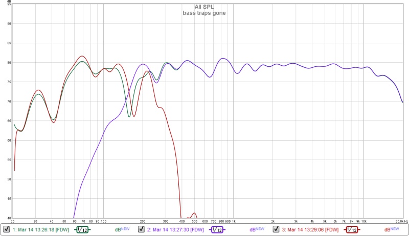

This measurement is with bass traps removed

Issue here is I wouldn't know good when it is staring in my face. Wife says slow and steadyhit it with proper bw4 bs2 with calculated alignment delay, start messing with delay knob, quit it when phase is good.
You would know if you put the target curve in REW plot window and adjusted the measured via EQ and filter combo until they match. That’s the only way to do it if you are not familiar with what a BW4 and BS2 “Looks like by feel”. Until they match the textbook curves you are going to flail without success. So please slow down and try to implement a textbook overlay plot. It’s a must because your curves are way way off. They look like BW4 and BW4 so will naturally cancel with a deep notch when same polarity.
Use the REW EQ tab to implement the correct filters and then upload curves to miniDSP. Read up on that functionality. You can do it with 2-5 measurements with the proper technique.
And please move up away from 100Hz XO. That’s a bad spot from distortion standpoint and time delay standpoint. Try 350Hz. Move lower once you know how to do it. You can’t get BS2 on Eikona at 100Hz because it has natural falloff that will not allow you to implant a BS2 falloff.
I get that, however if one would EQ out a reflection at the measured spot, the result would never be right at the listening spot. The peaks/dips we see in the measurement look like floor bounce to me. If this is floor bounce at close measurement distance, it will hit somewhere else at the listening position. All that EQ for crossover perfection would be invalid.
Look at the IR, the Filtered IR, the wavelet and first find out what's happening. Solve that (even if it's only temporary) so you can make sure the speaker hands over to the next without the room or other boundaries being involved. Anechoic like measurement conditions for crossovers is why we measure up close. Raise the speaker if needed...
Good points but you probably very busy yourself and haven't noticed pages back that mid tweeter dictated XO point upped to 160Hz, below is where he acoustic is now @LR4 that when time aligned will be electric transferred to BW4 and BS2 slopes.
Measuring low frequencies that are travelling around the baffle at such a large off axis angle that are most likely not reflections off the front wall, I don't think you can be sure of the source of what you are measuring to be honestIf can happen with low frequency and when measuring a dipole more than 60 deg off-axis. At least I have experienced that!
