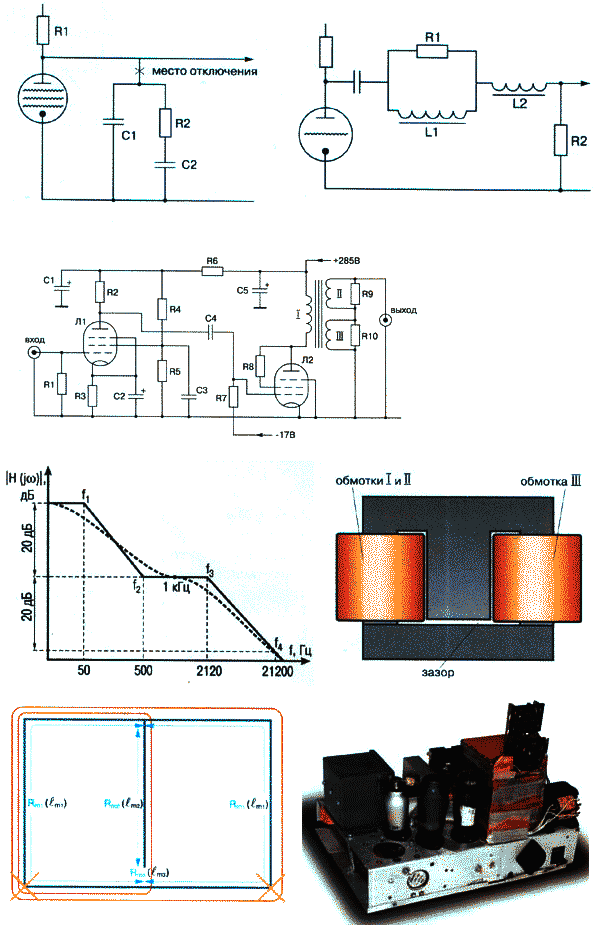

The link looks interesting, unfortunately the schematics didn't come up. I like the way he tested different caps, ones the maths started to show up I quit. 😉
Edit: It's in the Google cache
Can't get the link to work but copy the link in the Google search bar and hit search.

Yes, it is in the Google cache thought without pictures. Somebody already noted on the forum there that the pictures don't come up - perhaps they'll fix it. I could see all including pictures when the site was OK.
It is a very interesting idea, as he used transformer leakage inductances for RIAA equalisation - no resistors or capacitors.
Let's hope that the schematics and pictures will be visible in the future.
x-pro
Here are the main pictures. Unfortunately all the formulaes also are pictures and there are too many of these to copy 🙁 . I'll try to contact the admin of the site and ask a permission to do a mirror of that page on my own site.
