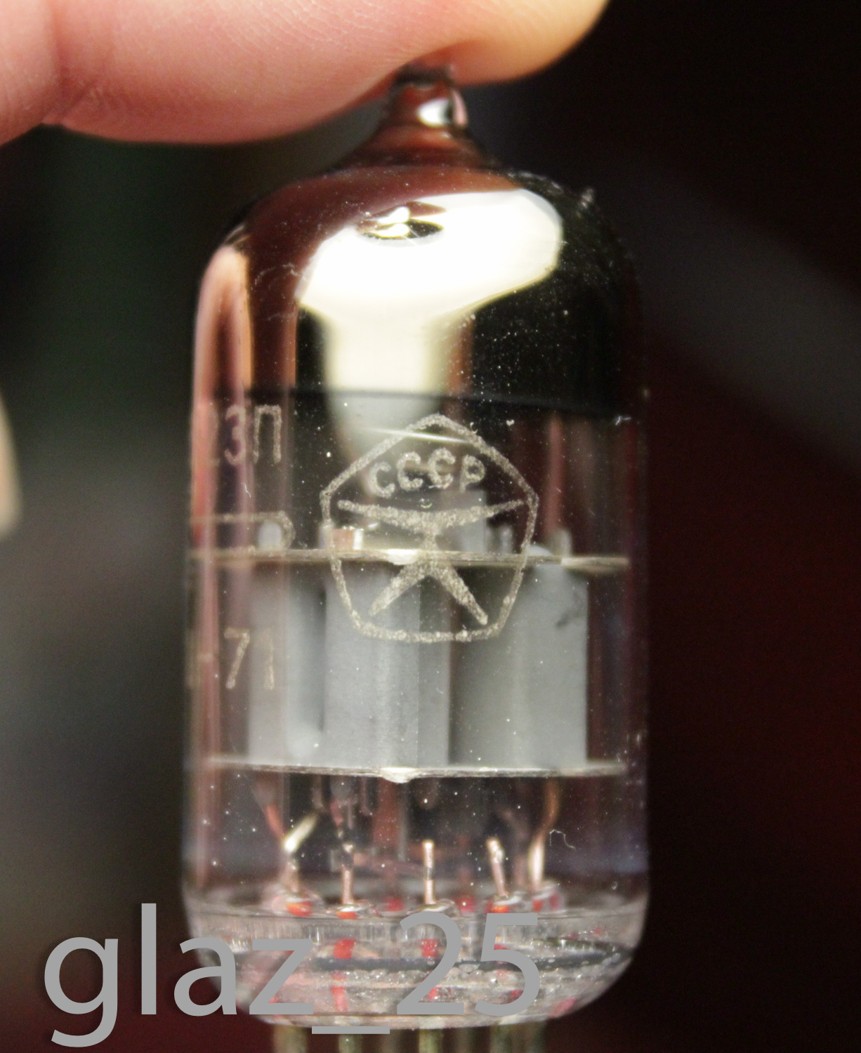

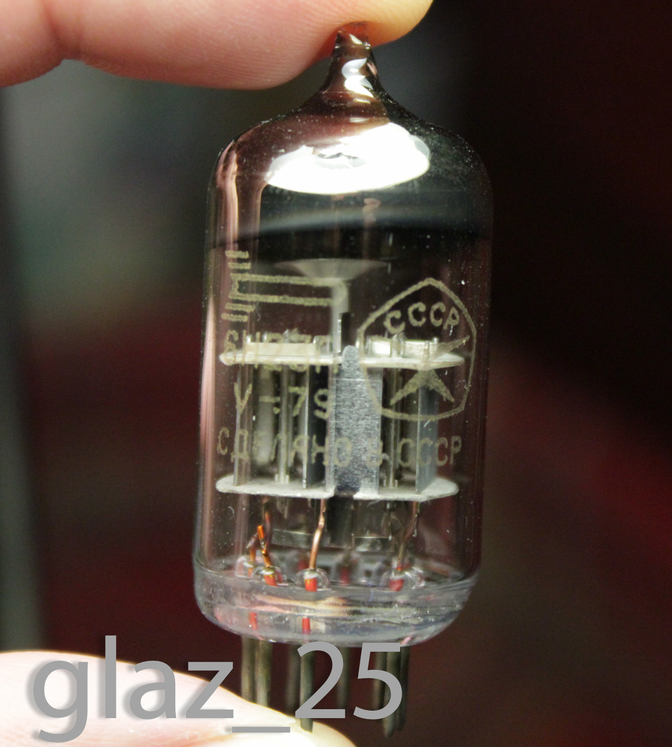

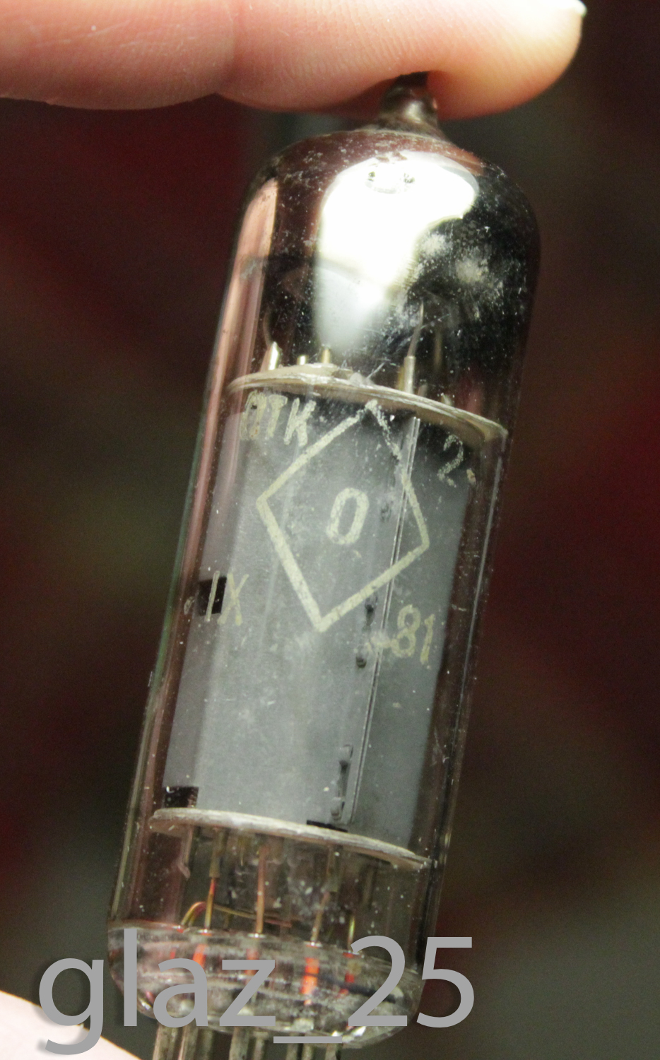

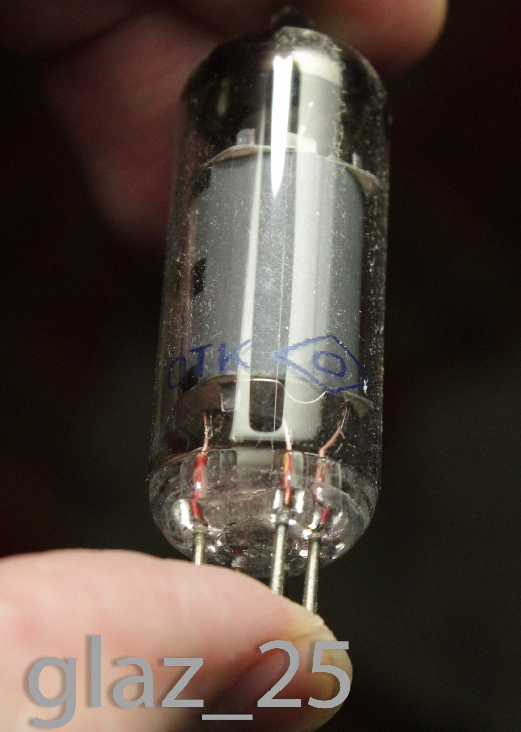

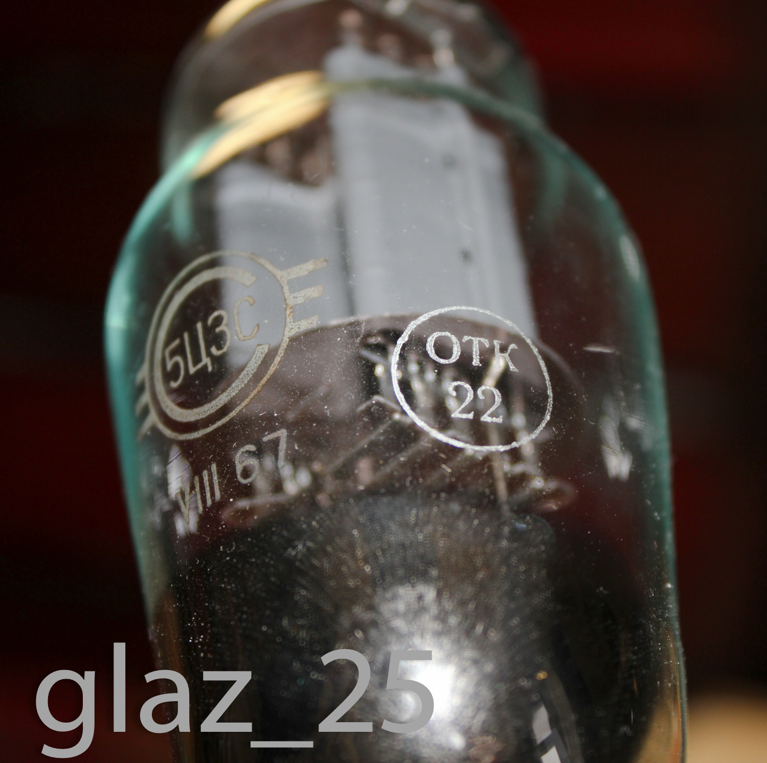

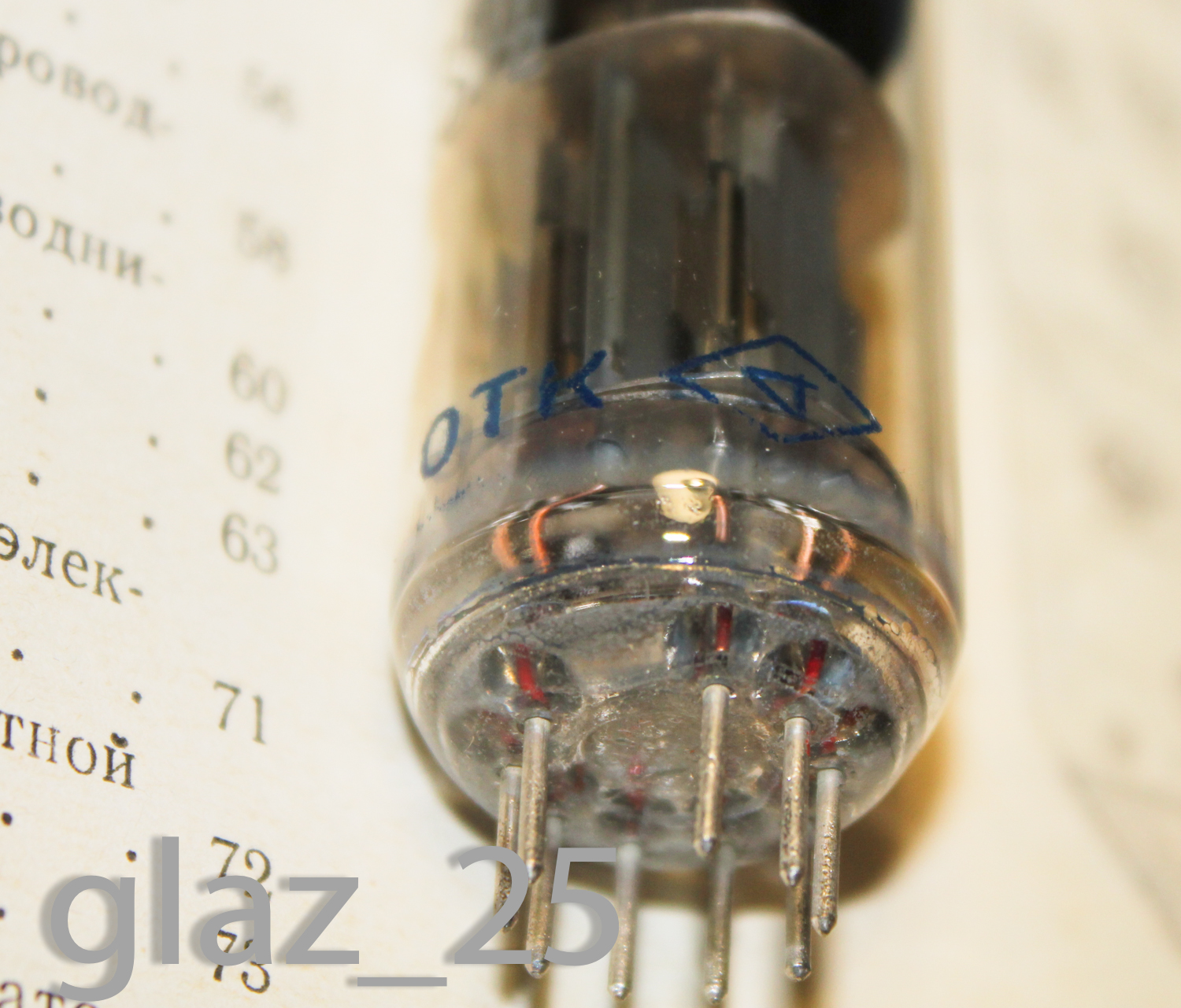

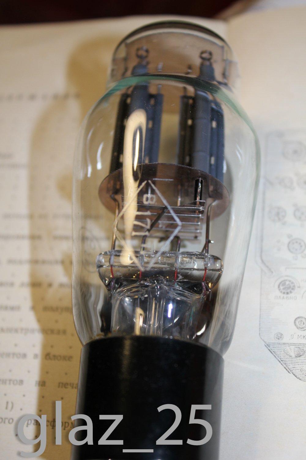

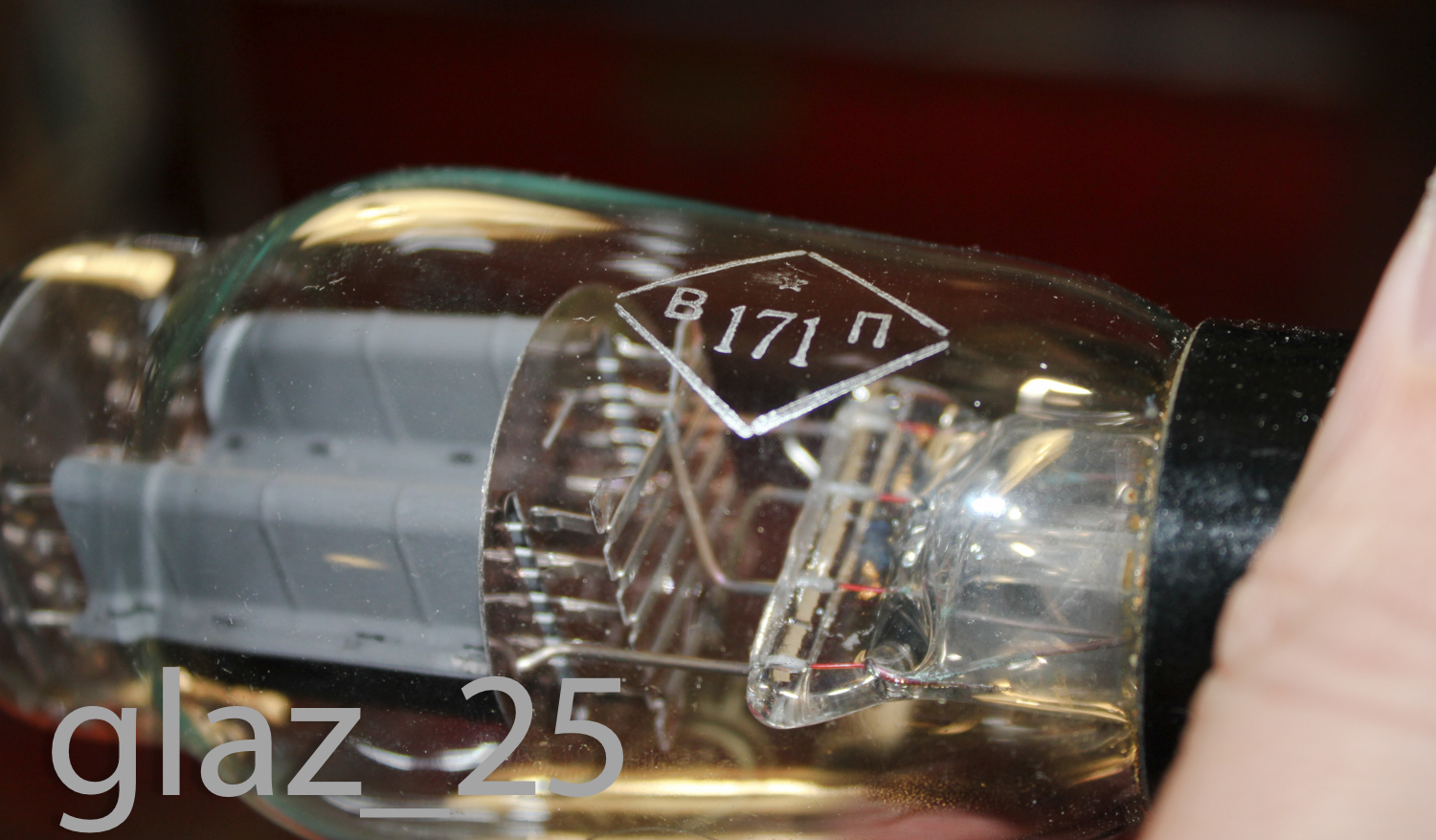

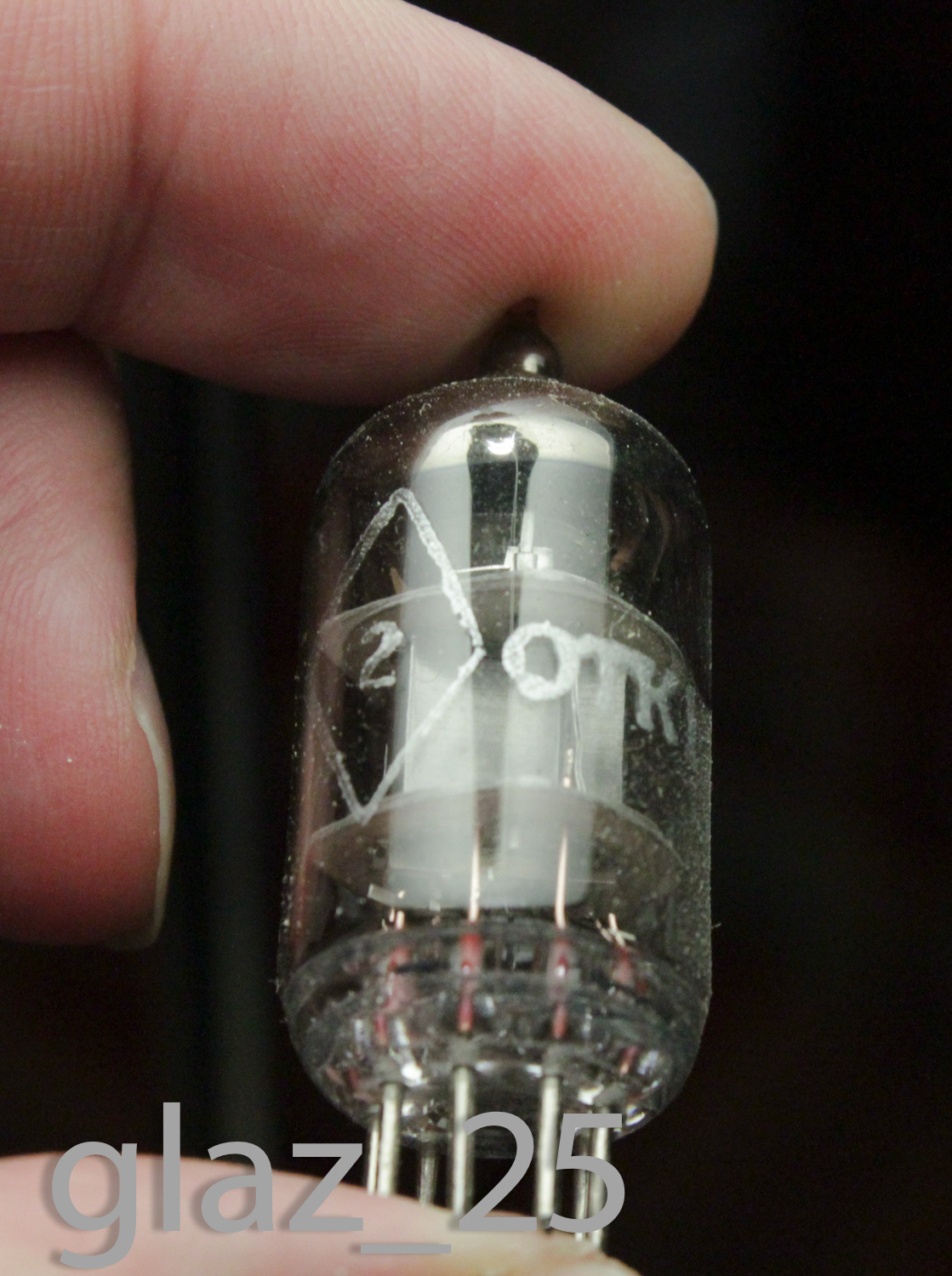

Hello, I shoot some my Russian tubes and try to find some info concerning different Quality Signs on Russian tubes like "OTK", "<>" (rhombus) "ВП":
As I know:
"OTK" - sign of QC department, means that standard quality control passed. In the Soviet times ANY PRODUCT of ANY factory or other production MUST BE checked by "OTK" department - it was guaranty to civil buyers/users that this device is good and safe for use. It is "civil" sign.
"<>" empty rhombus or rhombus with only digits inside (since last '60-s - till present), also letters "ВП" and some two digits between them and inside rhombus - like "<В 171 П>" (before last '60-s) means that device passed Military quality control .
As I can find, digits inside rhombus does not mean any special concerning tube parameters - it's just personal provisory number of person who control QC process for military.
Rhombus signs also used and uses now for any other electronic components and devices which pass QC for military uses.
Sign like star and "CCCP" inside pentagone - is "Sign of Highest Quality USSR" - civil sign.
Words "Сделано в СССР" - means "Made in USSR".
Please feel free to ask any questions or find something special from ex-USSR 🙂
Here is some pics of my tubes:
As I know:
