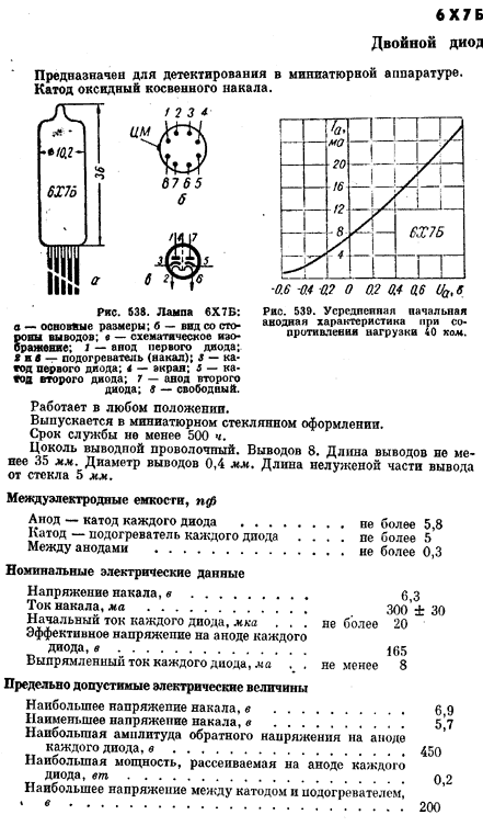

Can someone tell me what it says (translated to English) under the chart on the top right of this datasheet. It looks like current in milliamps is on the vertical axis, but I can't tell what is on the horizontal axis. Ua doesn't look like voltage. There's some writing below the chart that I'd like to know what it says.

It is plate voltage. Graph shows plate current vs. voltage around (+ and -) 0 volts.
This is a detector diode, so yes, it's Ua (U stands for "Ursache" in German, or cause) which indeed is plate ("Anod") voltage.
Right, and the anode voltage has been measured with a 40 K anode load resistor. (сопротивлений наргузки 40 ком)
I was wondering why there's current when the voltage is zero. Theoretically, when voltage is zero, current should be zero.
It's a detector diode designed for "miniature equipment".
The graph is (as already noted) current vs voltage.
The graph is labelled "the average initial anode characteristic", ie typical performance when new.

усредненная - averaged
начальная - primary/initial
анодная - anodic
характеристика - characterization
при - at
сопротивлении - resistance
нагрузки - load
40 ком - 40 Kohm (assuming ком means Kohm)
Theoretically. However, in practice, electrons don't leave the cathode with zero velocity. Electrons that leave with an initial velocity will still hit the anode even when the Vpk is zero, or even slightly negative. It's similar (but not identical) to the reverse leakage current through a reverse biased SS diode.

The scan's a bit fuzzy but I think the vertical scale is in microamps [µA], not mA. In another datasheet (6Х2П, 6H2P) there's a similar graph as well as the one from 6AL5 (EAA91).If you look at the first graph on the third page here

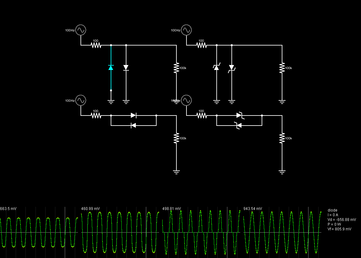

If we move the diode ground connection to a series position as in this example, we have an adjustable crossover distortion circuit. The signal level must exceed the forward threshold of the diodes in order for them to begin to conduct. This produces a "notch" in the output much like crossover distortion from early solid-state amplifiers.
Crossover distortion
They have an example of a series diode circuit in this thread
Using LED's Instead of Diodes
http://i281.photobucket.com/albums/kk238/spliff-devine/gc/Silicon_ClippersClampers_002.png
Two of the circuits (lower 2) create crossover distortion.
The hardest thing to explain is the obvious.

Yes. It is similar to the tiny grid current which flows when a grid is slightly negative of the cathode - used for grid-leak bias. This effect has been used to generate electricity directly from heat.Miles Prower said:However, in practice, electrons don't leave the cathode with zero velocity. Electrons that leave with an initial velocity will still hit the anode even when the Vpk is zero, or even slightly negative. It's similar (but not identical) to the reverse leakage current through a reverse biased SS diode.
You can think of a vacuum diode as being like a semiconductor diode, except that the so-called 'threshold voltage' is not 0.6V but more like -0.4V, with wide sample variations. You can reduce this voltage by running the heater slightly cool.
the letter "U" is in german language the formula sign for voltage, probably derived from "Ursache" .
"Spannung verursacht Strom"
voltage causes current.
Ua = Vp
Uak= Vpk
