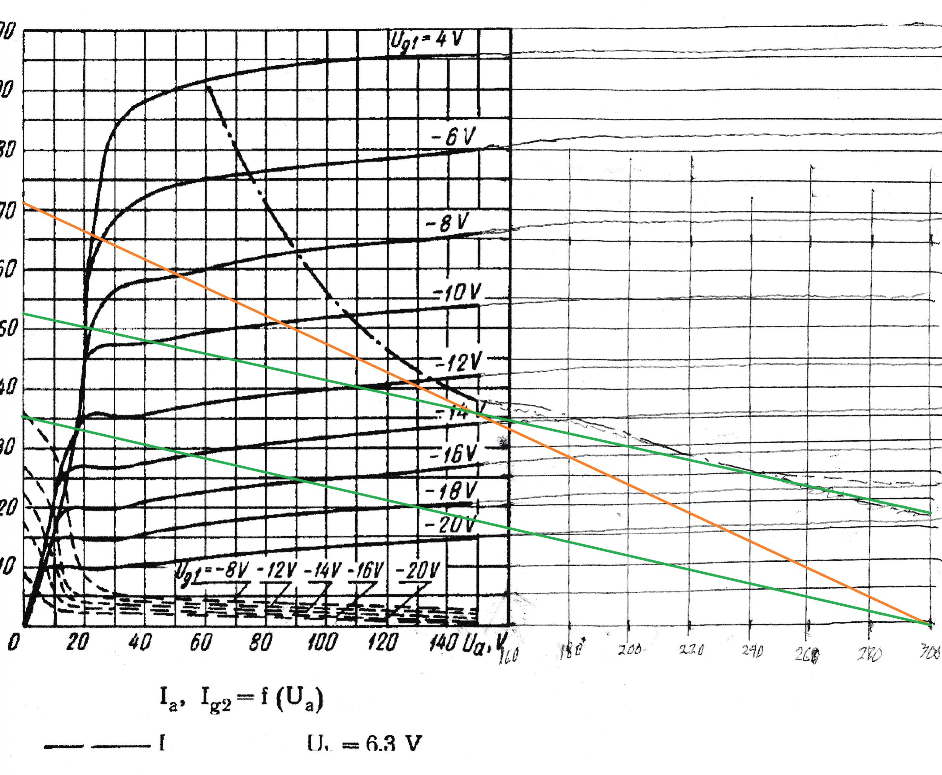

In other news, I found this handy loadline calculator. To my surprise, it even included the 6P30B tube! One cool thing is it adjusts the curves based on screen voltage, so it's more accurate than using the tube book curves which are only accurate for one voltage.
My first attempts produced a loadline that was mostly above the max dissipation. Eventually I realized the 8,500 ohm primary on my output transformer was causing this. I decided I will put a 16 ohm speaker on the 8 ohm secondary to reflect 17,000 ohm on the primary and keep my loadline just below max dissipation. see attached.

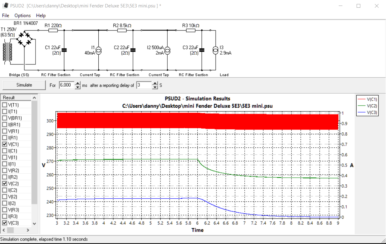

screen current
Have you allowed for the power tubes' screen current? Did any Fender Deluxe run as much as 10k in the combined screen/preamp feed?
I think I got it..... from the Valve Wizard, "As a rule of thumb, screen current is a fixed ratio of the anode current. The EF86 data sheet tells us that for an anode current of 3.0mA, screen current is 0.6mA. This is a ratio of:
3.0 / 0.6 = 5.
In other words, the screen current will normally be about one fifth of the anode current, as long as we're operating well away from the knee of the curves."
The characteristics of 6P30B state anode current of 35 and g2 current of 1.3. That's approx 27:1 ratio. I'm now planning to run 15mA @ 300V anode, so that would be about 0.5mA g2 current. At peak, the grid current will be about 2.0mA.
Replacing R2 with 8.5K keeps voltages @ A-300, B-270, C-240. When the current steps up to 2mA B&C drop about 12 volts. see attached.

I don't understand why it says that. It gives reasonable numbers for 6V6, but the 6P30B plots may be wrong.
I double-checked it manually, it was spot on. Apparently, the 6P30B has approximately 8500 ohm load resistance @ 300V.
I was hoping to get 12 watts out of it, now it's gonna be 8-9 watts I think, but that's still pretty good for lil bitty tubes!
