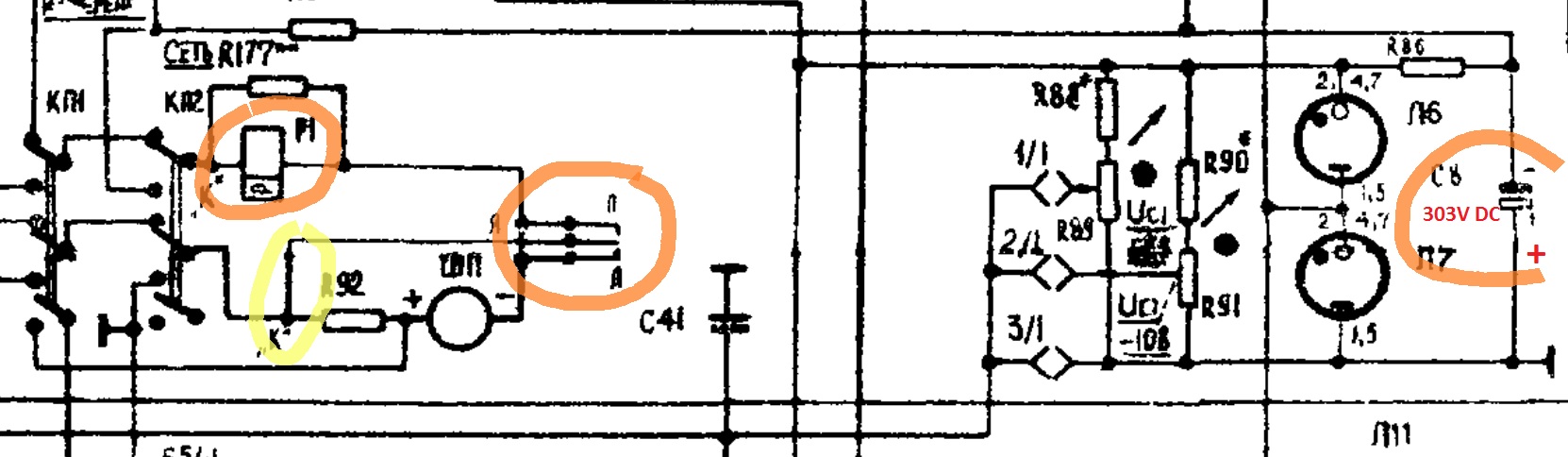

I bought good looking L1-3, but have problem. When pushing button CETb, there is tiny (none) movement of indicator. Pushing KAL button moves indicator needle "over the corner". My questions are: 1) Is it OK that there is 303V DC on C8 with plus to ground? 2) What is yelow marked "K" on wiring diagram? 3) Red marked is relay and its contacts? How should work that circuit?
Thank you for any ideas.

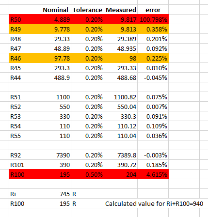

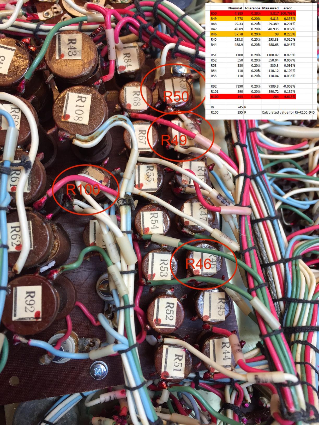

2. The anode shunt resistors are out of tolerance (>0.2%). I found 2 measuring out of 0.2% - R50 (4R889) and R46 (97R78). I contacted the seller to see if he can send me them. When measuring a CX301a traced with the Utracer V3, transconductance was very close, however the Ia measurement was way off. This led to investigate and found the resistor drift issue.
3. The screen current resistors are within tolerance (<0.2%). However, when following the screen current calibration/test from the manual (e.g. I used a variable CCS as an external load with a series precision current meter) the meter goes into full scale regardless on the range. Something is wrong here
4. The meter seems to be working fine. Although is not the originally specified meter it has 745R impedance but the R100 measures differently from what it should be. However, the meter seems accurate when measuring Mains, 250V and Us. Also the transconductance values are ok when tested some sample valves. This is leading me to suspect that R100 was chosen to match the actual impedance of the meter in place.
Hi mogliaa,
For 3. above in things that aren't working, the CCS you are using should set the current limit. So that piece of stuff isn't working. In a series circuit, the component that allows the least amount of current to pass sets the current through that entire circuit. If you are using a FET is some kind, it's probably in backwards.
For 4. above. The series resistor is probably selected to make all the meters have the same total impedance.
1. I wouldn't if at all possible.
2. Yes, probably resistors have drifted out of tolerance.
Fix everything you can find a problem with, then assess your tester again.
-Chris

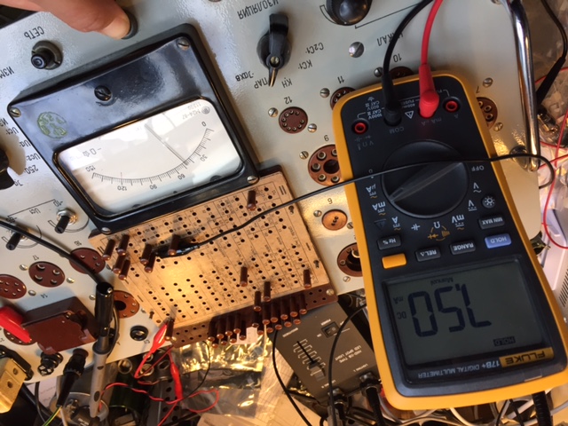

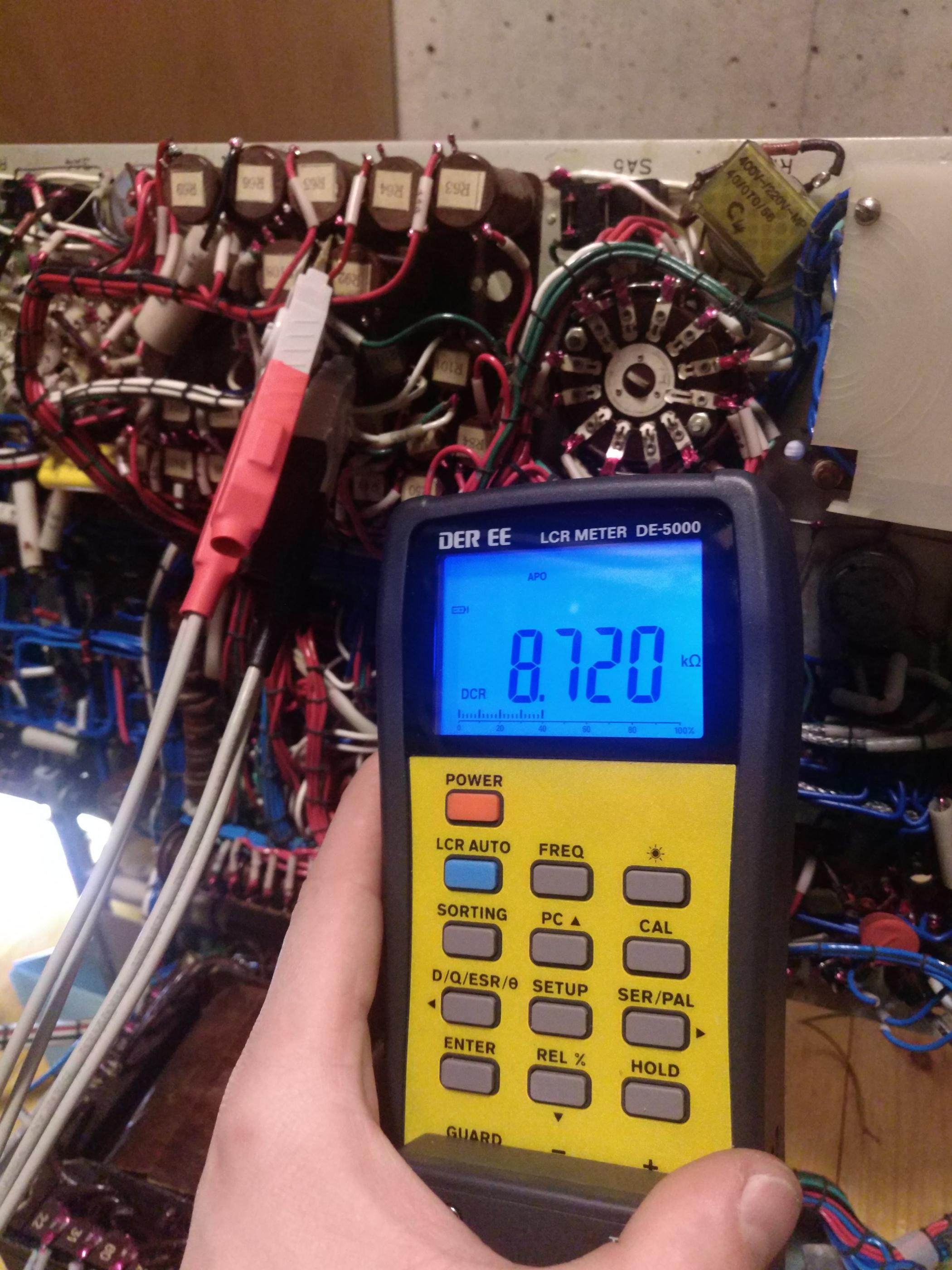

moglia : R100 + ..is kind of tricky ...in my was 490ohm... there is about 10 different impedances for analog meter...
P+R100+R101+R92 = 8720ohm
There are several resistors which are diffrent than in book.

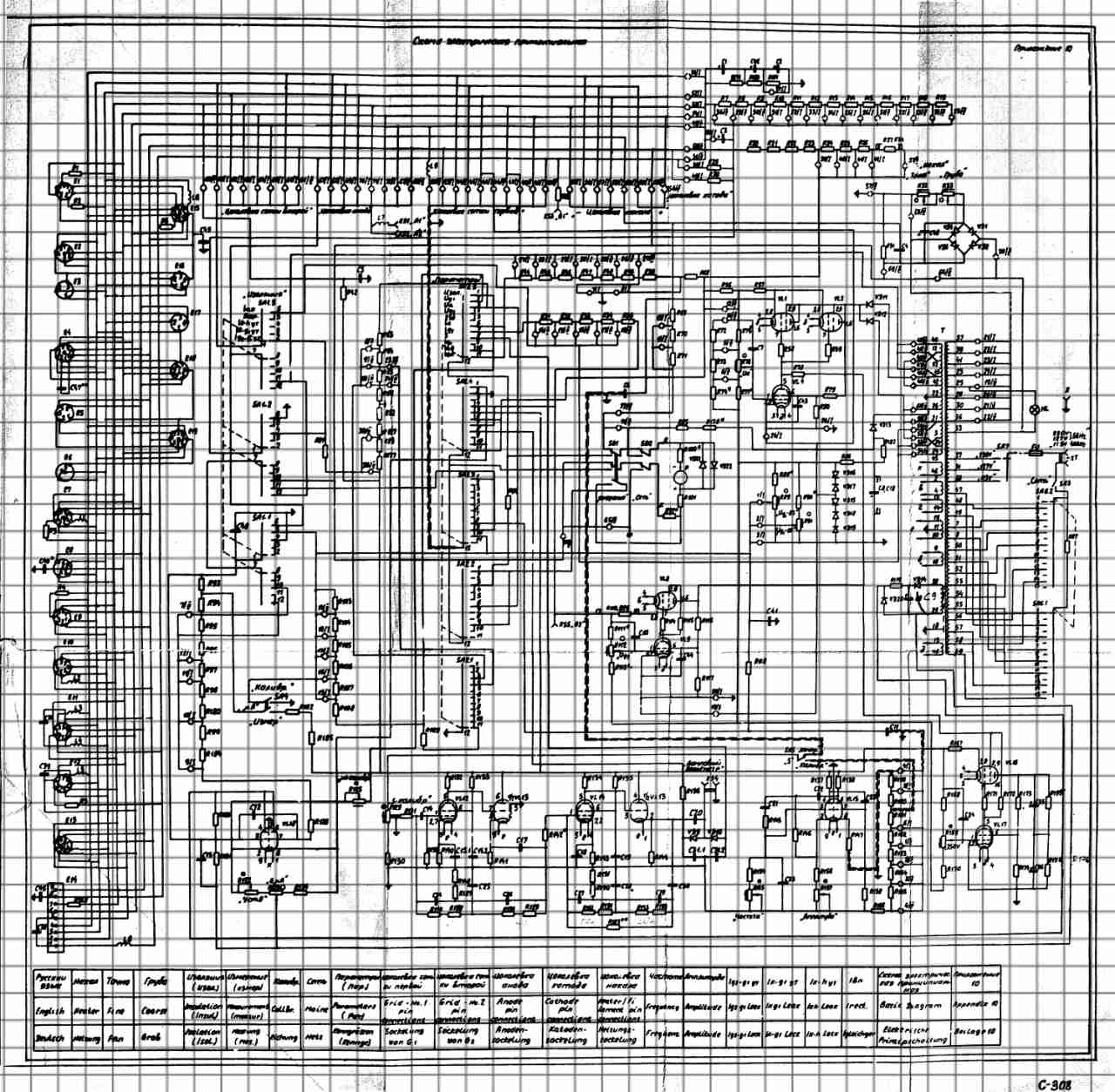

I make new schematics in autocad (more than 3 weeks of work)..and now i make report with excel tables itc. As soon as I finish I will upload for all.

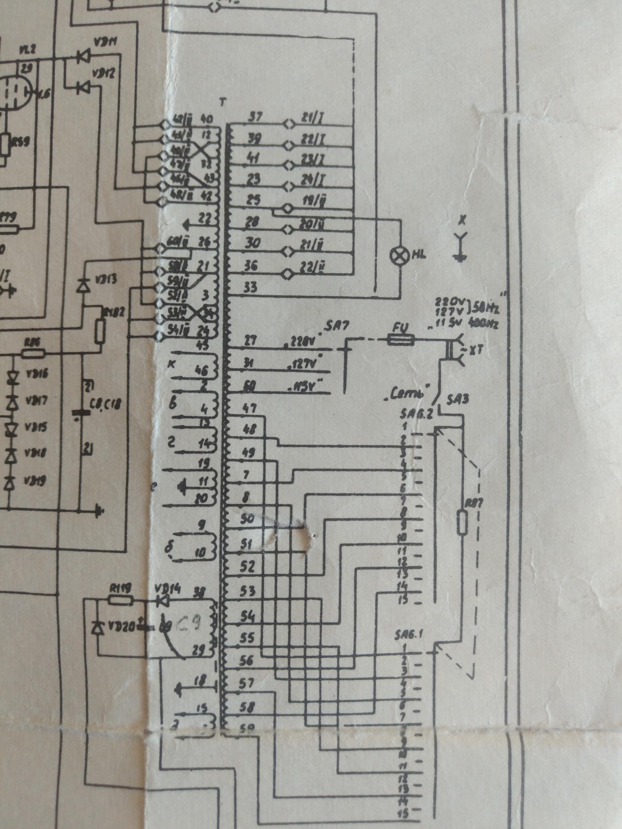

I have check again in book and original schematics and opened the meter and compere between the 3. It is correct. One Russian person said same as you.. but we wore on facebook and check together.
It looks different versions.. my is 1986 with 2 fuses (my original schematics shows only 1).
