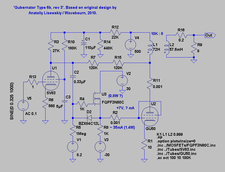

To what this assumption is based on ?
Usually zero-bias circuits have high supply voltage.
Try to connect all grids of 6P45S together to form a high-mu triode and some 600...750 V supply voltage. I have tested such SE-amplifiers some years ago.
For example with GU50 and 750 V +Ub, some 15 W is available.
The driver stage should have low source impedance, of course.
For gu-50 you need something like +8V bias.
